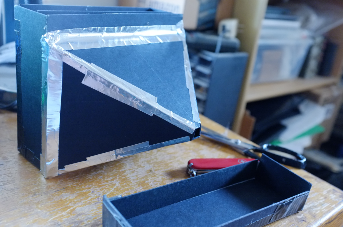

I cannibalized an old camera I wasn't using and added on the pyramid...
The main advantage to this design is that it makes it possible to light the subject. I used two small LED reading lamps mounted on flexible necks.

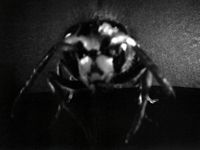

this is almost a "pinhole microscope" because it is much more than 1:1... the negative is on 5x7" photopaper and the face is maybe 1/8" wide. It's difficult to light the subject when it is close to the camera, and the pyramid shape helped a lot with that. This image took 6 or 7 hours with two bright reading lights on either side. Getting it centered in front of the pinhole was difficult. I tried a few times and one time the little hairs on top of the thorax were well defined in the image ( those are tiny! ). I'm certian this image could have been much better if I'd spent more time on it... the pinhole size was a bit too big. I was intent on making the face fill the photo paper.
