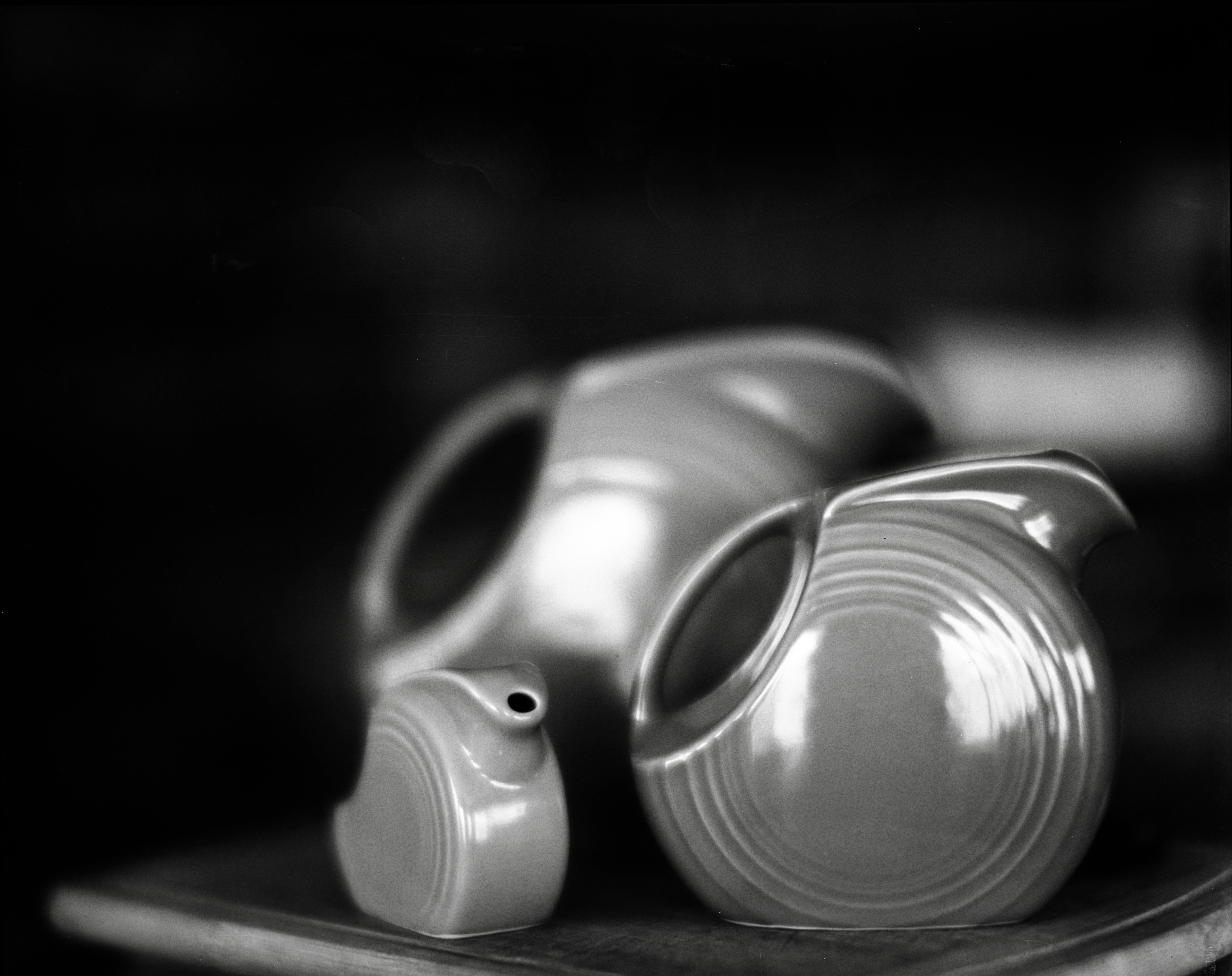

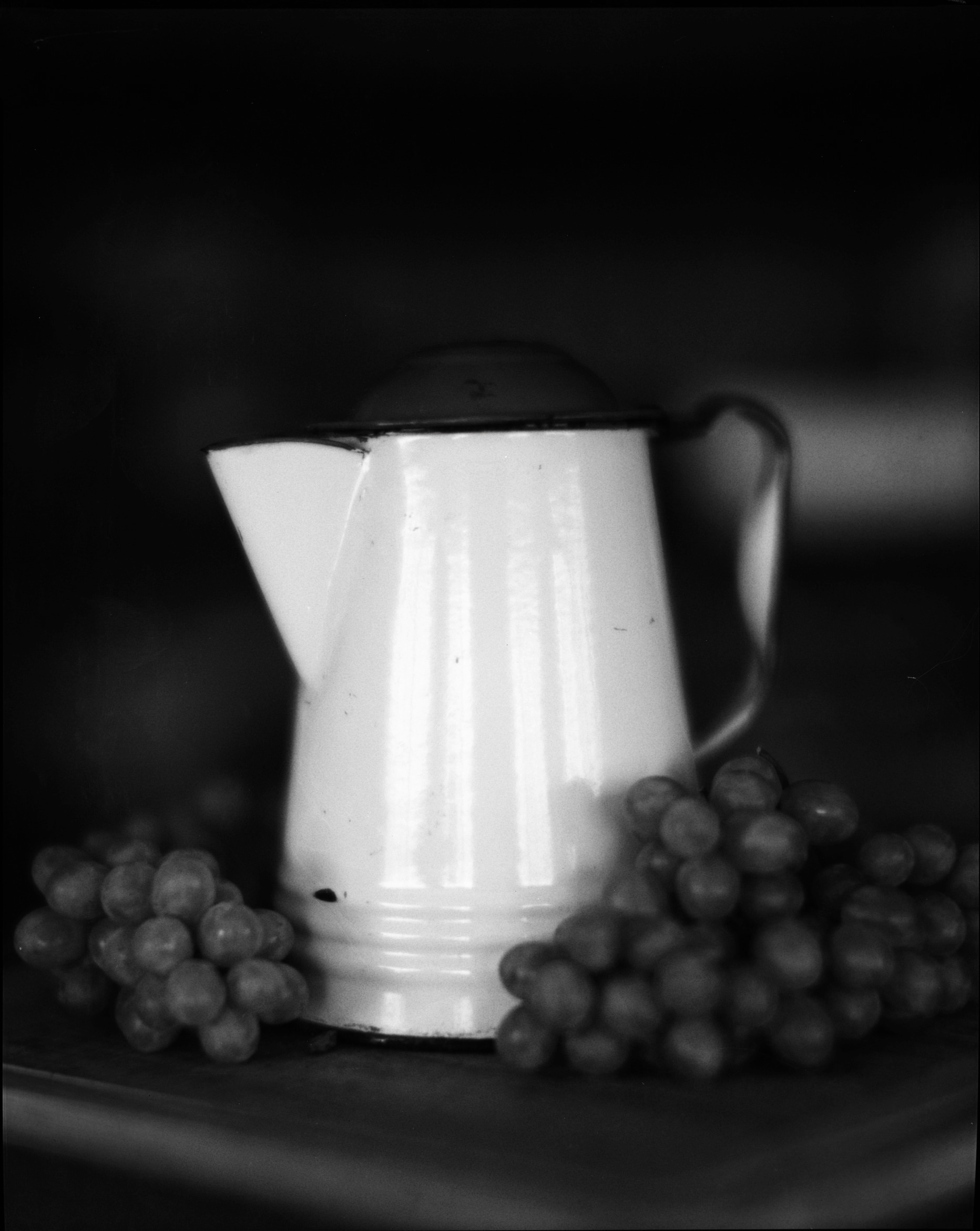

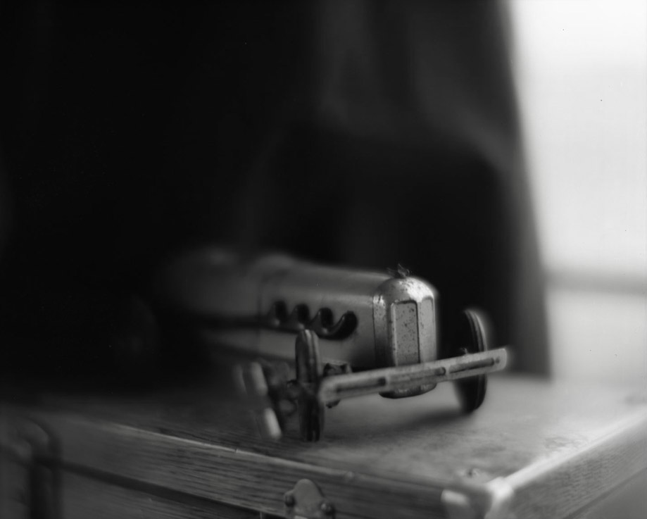

You haven't explained your vision. Some of us like to work close and explore soft focus with 8X10. To others purposely soft glowing images are vomit. 2 lenses here, both 12" focus, one is a simple achromatic meniscus doublet and the other is a Tessar design with purpose built defocus at the front group.
