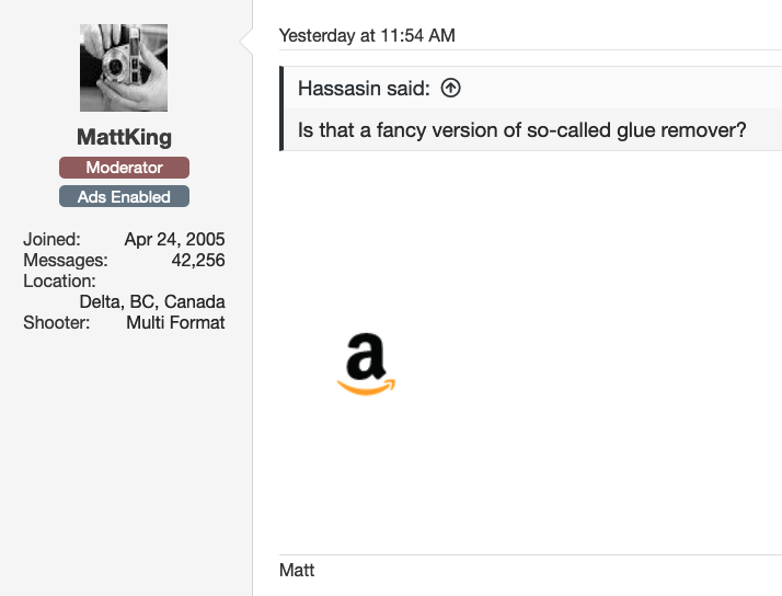

Is that a fancy version of so-called glue remover? I was going to suggest the remover because it will rather surely work fine and leave no residue nor would it damage anything (still test it before going wild).
They used to make one with orange scent, worked great, and smelled good enough too.
This reference does not work.
Edit: See below
