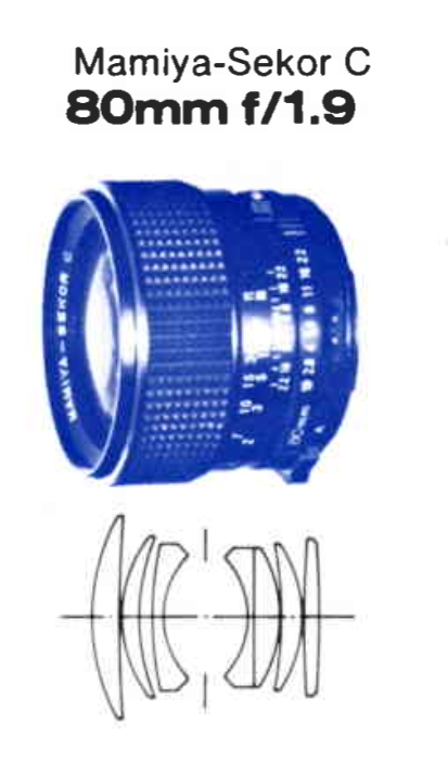

FYI, the 1.9/80, definitley looks like a "Planar" design to me, and there is one pair that are cemented, but from the OP, I assume that is not where the haze is:
That is a much older, "C" version of the lens.
But optically speaking, the N version looks very, very similar :smile::
