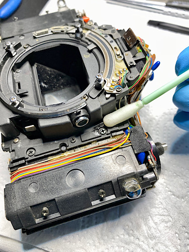

There's not much that can be done without dismantling an SLR camera. Unless you give the camera a good shot of WD-40 from the outside 😉
In order to clean and lubricate/oil the mirror box mechanism, it has to be removed.
This is a lot of work with all SLR cameras, as parts have to be dismantled first.
Then the question arises as to whether the mechanism can be cleaned while assembled or whether further dismantling is required.
With SLR cameras with a horizontal focal plane shutter, the transfer gears on the bottom of the camera also raise the same questions.
There is often dust behind the eyepiece or above the focusing screen, which means further dismantling.
Then all the settings have to be checked, the lists in the service manuals are long, see also my attempts as a beginner to adjust the shutter on a Minolta XG-M.
For this alone, parts have to be removed and the top cover removed.
All together, and that doesn't even take into account troubleshooting and replacing/repairing defective parts, this work takes several hours of work. If you are practiced, it goes faster.

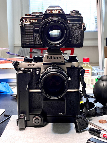

I gained a good impression of the effort involved in a CLA in these two projects:

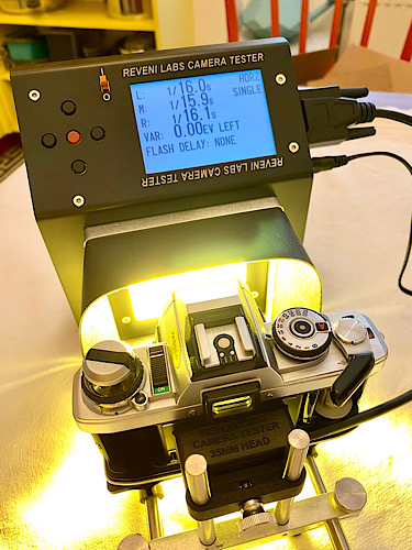

Admittedly, one of the Minolta X-700s was very dirty, but for a thorough cleaning it has to be removed from its covers anyway.
And I didn't take both cameras apart down to the shutter, check them completely and adjust them.
Which settings on my camera will be checked and adjusted? Is professional testing equipment available like on this picture?
Therefore, before you commission a repair shop to do a CLA, you should ask what exactly is being done.
