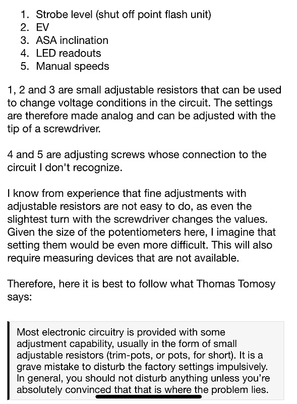

The service manuals for Japanese SLRs from the 1980s cover several adjustments of the flange-focal distance, shutter, mirror, spring tension, electrical engagement lengths and electronics.

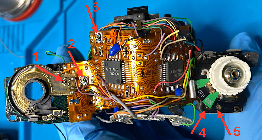

The latter mostly involves voltage settings via potentiometers. This is how the correct values for individual exposure times, automatic, ASA, LED displays or voltage gradations are set, as the electronics are still mostly analogue.
This is all fine-tuning and the usual recommendation (Tomosy) is not to change these factory settings unless you have a good reason to do so.
Here are settings for the Minolta X-700 on the board:
