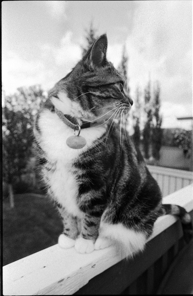

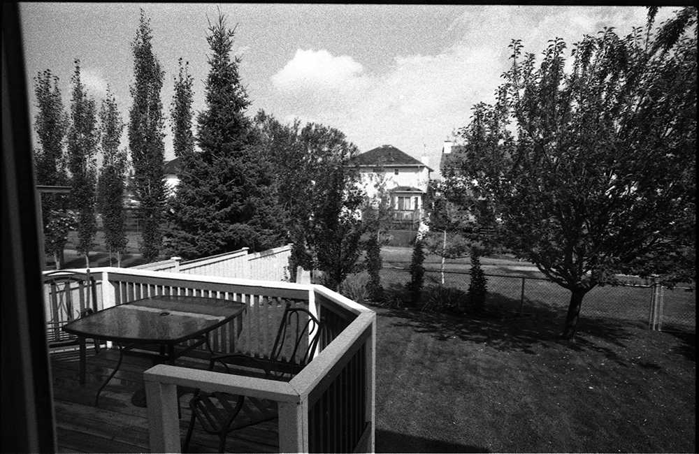

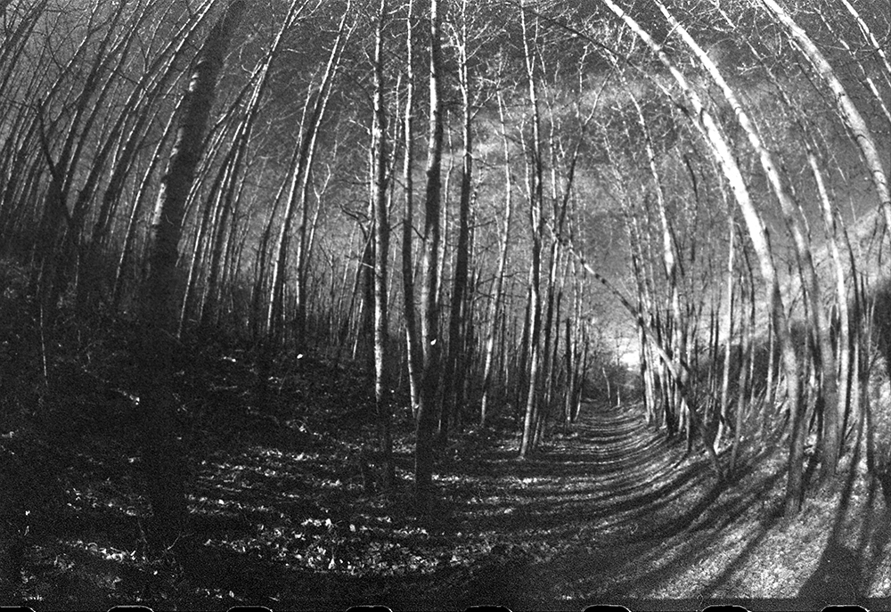

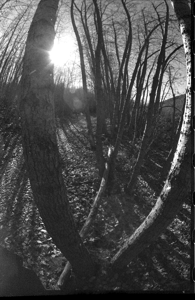

Here are some quick scans. I used an old Canon AE1 in manual mode. The photo of Abby the cat was taken with the FD 85mm lens wide open and the rest taken with the FD 17mm fisheye lens. The shot through the kitchen window was taken with the 50mm I believe. As you can see the tonality is pretty decent actually and the grain while pronounced not altogether horrible. The scans were sharp but the images themselves seemed a bit soft. Will have to do some additional experimenting to see what's up with that.
All in all I would say the experiment yielded "acceptable" results. I think the film at this asa would provide a gritty vibe to shots that would benefit from such a thing.
