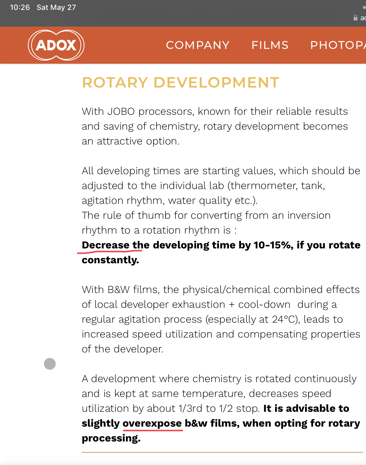

I need a little clarification:
It says the rule of thumb is to decrease development by 10-15%.
This is common knowledge.
But then it says to overexpose film as well?
It seams counter intuitive.

Here's the complete ADOX section on Rotary Processing
"ROTARY DEVELOPMENT​
With JOBO processors, known for their reliable results and saving of chemistry, rotary development becomes an attractive option.
All developing times are starting values, which should be adjusted to the individual lab (thermometer, tank, agitation rhythm, water quality etc.).
The rule of thumb for converting from an inversion rhythm to a rotation rhythm is :
Decrease the developing time by 10-15%, if you rotate constantly.
With B&W films, the physical/chemical combined effects of local developer exhaustion + cool-down during a regular agitation process (especially at 24°C), leads to increased speed utilization and compensating properties of the developer.
A development where chemistry is rotated continuously and is kept at same temperature, decreases speed utilization by about 1/3rd to 1/2 stop. It is advisable to slightly overexpose b&w films, when opting for rotary processing."
Can anyone reconcile what appears to be a complete turn-around in two paragraphs from ADOX. Has anything been lost in translation?
It sound like only ADOX may be able to answer what still appears to be a paradox to me

Over the decades I have found that once you obtain correct exposure and film developing parameters, that are correct for your shutter errors and film developing system, then the only change is the developing time difference required when switching from constant agitation to intermittent agitation.
In 35mm photography this is easy, the camera only has one shutter, with my 4x5" format cameras it is slightly harder, each of my seven lenses is equipped with it's unique shutter and there are some quite large differences between them. 😀
MattKing
Apr 24, 2005
54,710
Delta, BC Canada
pentaxuser:
There is no single "correct" answer - no single right, with all the rest being wrong. But there are clear tendencies, and reasonably narrow ranges for acceptability.
ADOX has provided recommendations for how to compensate for the changes between two different types of agitation. They are just that - recommendations, and they will be founded on their preferences.
Even with those recommendations applied, the results will be vey similar, but not identical.
The differences will probably be minor though.
And the effect of those changes, as well as the effect of the recommended compensation steps, will vary from film type to film type, and developer type to developer type.
But the variances will be relatively small - the sort of thing one might either leave in place, or make small adjustments for - essentially the same as cooks who "season to taste".
Mick Fagan posted above about his choice, when switching to continuous agitation, to not increase exposure more than he already increased that exposure. I would point out that by already increasing exposure with non-continuous agitation, he had already chosen to employ a differently shaped part of the characteristic curve than someone who chose to give the film less exposure and non-continuous agitation. It may be that for that reason alone, the necessary compensation for the change in agitation would have been different than if his starting point was different. It is also possible, of course, that he simply preferred the results after the change in agitation combined with a reduction in time.

Pentax user, it appears that you are baffled as to why I haven't needed to change my initial in camera film exposure when doing constant rotary agitation versus intermittent agitation using an inversion technique. That was/is a fair question, and something I didn't think too much about in my initial reply.
I use a lower ASA rating than what is written on the outside of the film container packaging for every film I use. This is obtained by testing my exposure and developing technique from the get go. So in effect, I have already given the film more exposure to ensure that as far as I'm concerned, I am starting with correct exposure and development.
Mick I hadn't realised that you had interpreted my bafflement in this way. It is not so much that you haven't found the need to change times when changing as the fact that ADOX appears to be suggesting that with constant agitation you need to increase the exposure time for the film to compensate as it were for constant agitation, having said in two paragraphs above this statement that the rule of thumb is to decrease development time by 10-15% when using constant agitation.
This is the consensus approach which Adox states. Could it really be saying that while this is the consensus approach this is the wrong approach and will not by itself result in the same negative as using the "correct" time for intermittent agitation?
If so I wonder why it has not taken the trouble to explain this in more detail as it flies in the face of the rule of thumb that other film makers seem to follow
Like many others Mick you have found, as you have said, that your film speed differs from the rated film speed and I understand this. I equally understand why you may use a development time that differs from that stated by the film maker However Adox seems to be saying that no matter what your development time or personal film speed is with intermittent agitation you will have to change your exposure time for your shots if you decide to change from intermittent agitation to constant as I said above.
Matt gave two explanations of this. The first in his #11 was what Adox was recommending needed to be done to achieve its own "correct" H&D curve i.e its meeting its own targets. The second explanation was the one centering around the unintended consequences of switching to constant agitation
Again both might be true and Matt has taken the trouble to explain both but what troubles me is that Adox has not taken any trouble to explain this at all It just leaves me uneasy about whether there is not something we are not being told by Adox
It just seem strange that a major company has not chosen to expand on its suggestion to do something which it knows will appear to fly in the face of conventional wisdom about what a user does when changing from intermittent to constant agitation
pentaxuser
