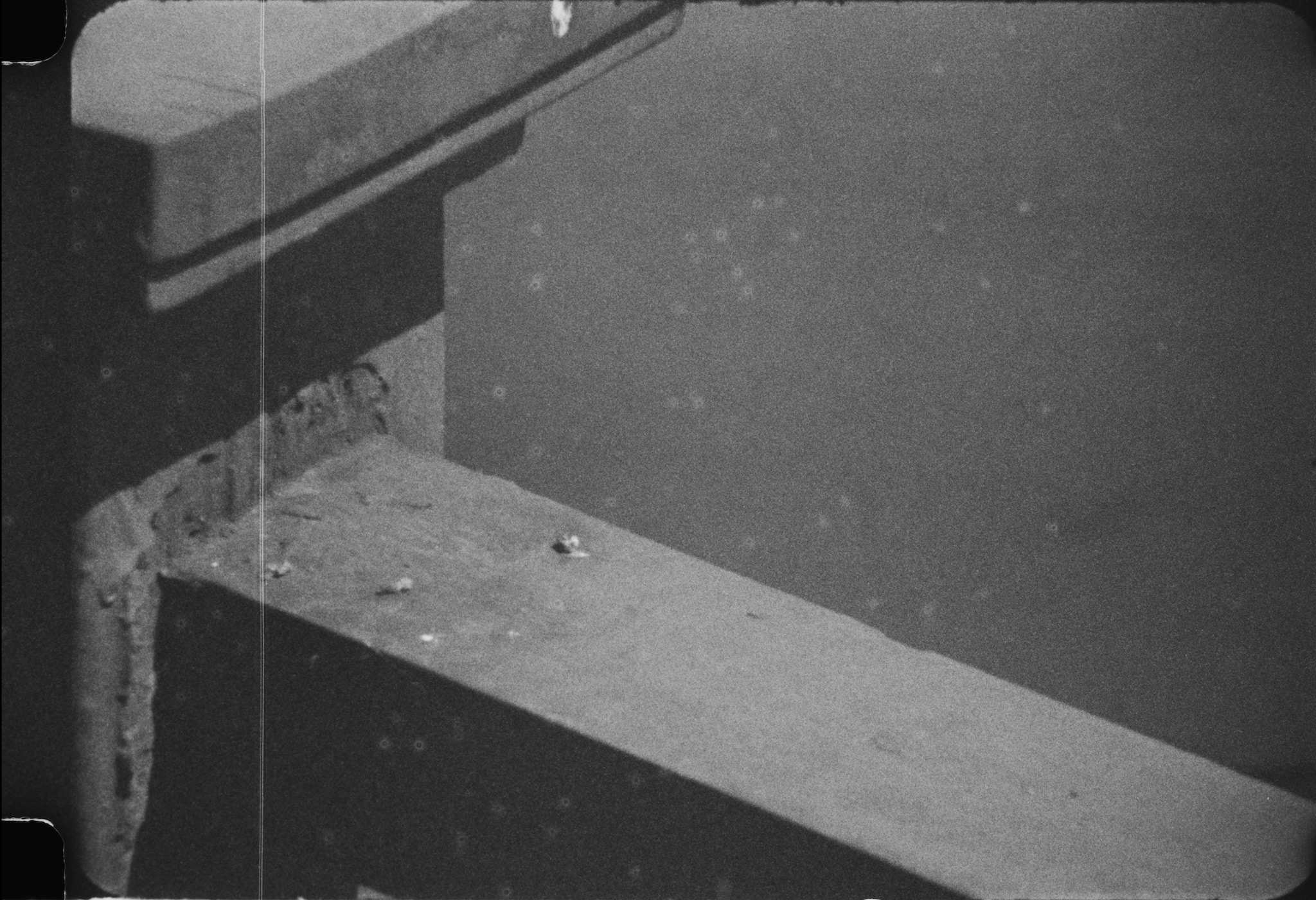

Hi Everyone - first post here, been experimenting processing 16mm with DIY monobath (also Cinestill) and I was informed by a facebook user that I was using Donald Qualls monobath recipe. Thanks a lot Donald for your recipe and contributions.
I'm getting little spots that look like cells. there's a white dot in the center with an orb around it. film is old expired plus-X. This is the recipe I found online, I don't recall where.
40ml of Ilford RapidFix
65ml of HC110
200ml of clear ammonia
Top to 1000ml with water.
When using the D96 monobath from Cinestill I don't get these orbs.I was thinking maybe the unfiltered / distilled tap water I use could be the issue but using same water with regular D96 powder and development process (develop, stop, fix, wash) I never get orbs.
First time I tried, I was using scented ammonia which gave orbs as well.. I thought It was the extra chemicals in the lemon ammonia causing the orbs but using clear ammonia had the same results.
What do you guys think it is? see screenshots.
