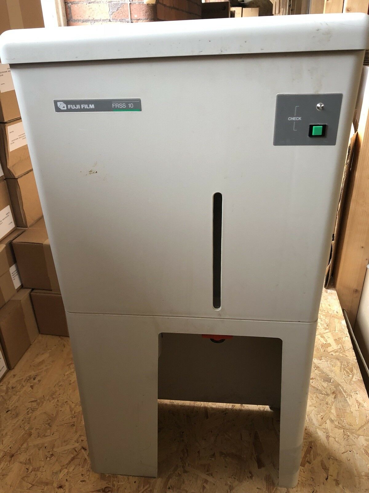

Fuji used to suggest the use of filtered deionised water for C41 wash and RA4 wash.
Some minilabs (trying to skimp) had problems because they used just tap water. They had chemical mix problem and wash tank growth of algae, clogging filters and causing circulation problems.
They sold units like this. They had a long life filter in them.
Kodak chemicals (at least the final rinse) contain anti-biological agents that generally prevent that kind of problem in that stage -- but they won't help in the wash stage before.
Few of us keep a wash tank running continuously for any length of time, so this shouldn't be a problem for most.
