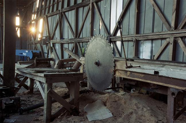

Someone asked to see movie film processed in ECN. Here's 5274 I shot in 2001 with an 85 filter. I loved this combo.
I should have taken that saw blade, they demolished this place a week later. We had one just like it on our sawmill growing up.
