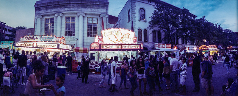

It was New Year's Eve and I was going into Boston with the family. So I wanted to bring a compact film camera that I can use hand-held. I was expecting some indoor events, some outdoor concerts at night and fireworks. So all artificial light sources and not too much light. Other than b&w, a high-speed tungsten color negative film is kind of the obvious choice for this scenario. And CineStill 800T has this market all for itself (other than using the Kodak Vision film with rem-jet).
I haven't really used this film in "good" light yet, only in cases where high-speed tungsten is called for. In the following photo I was going for the ambient blue cast to make the artificial food booth lights stand out:
The only trouble was the light happened to be more fluorescent than tungsten, so I wasn't quite getting the color cast effect I was hoping for.
