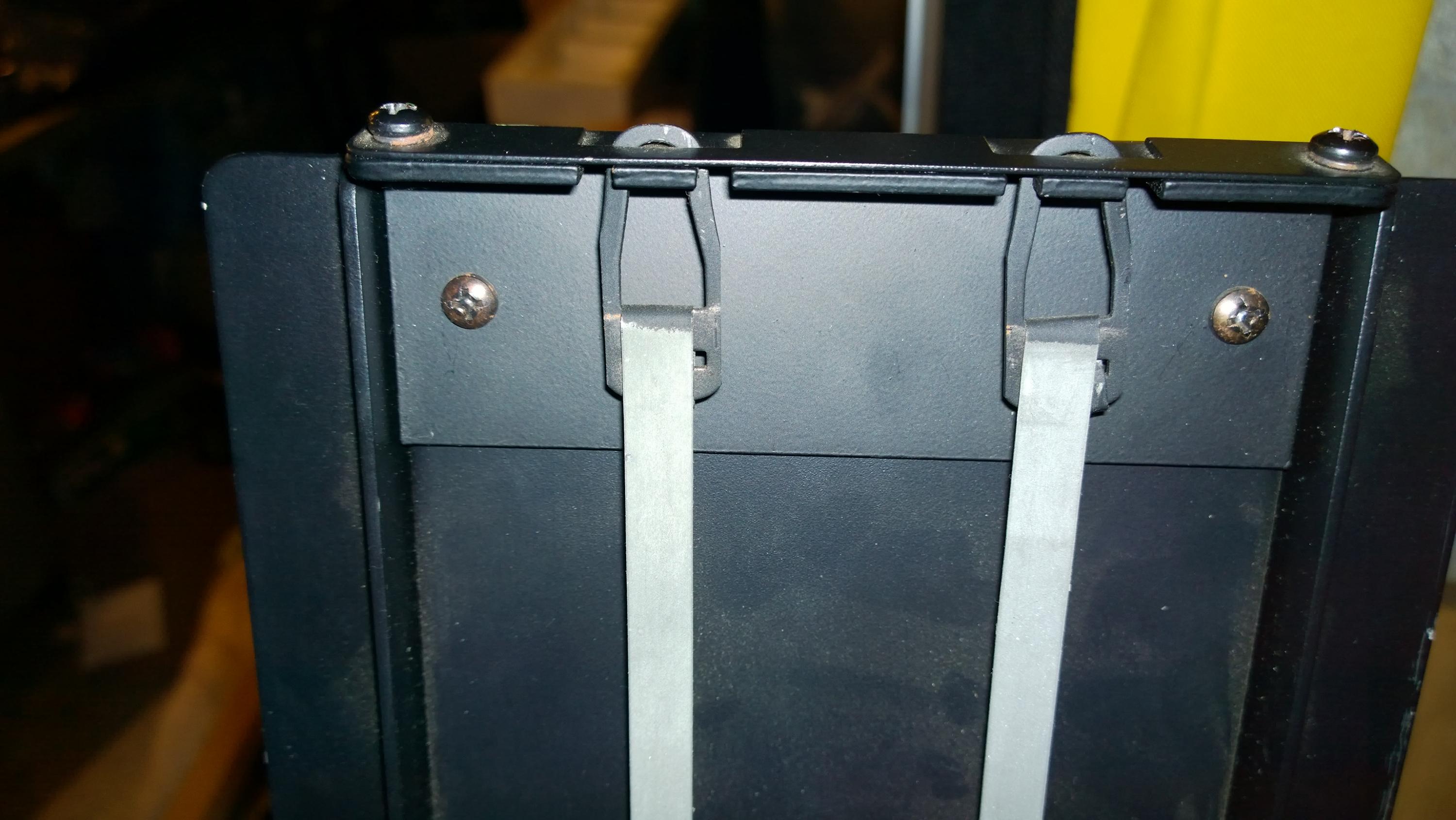

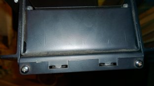

First here are couple pictures of how the springs attach on my D5, as mentioned yours may have been replaced with a different type and maybe best left alone.

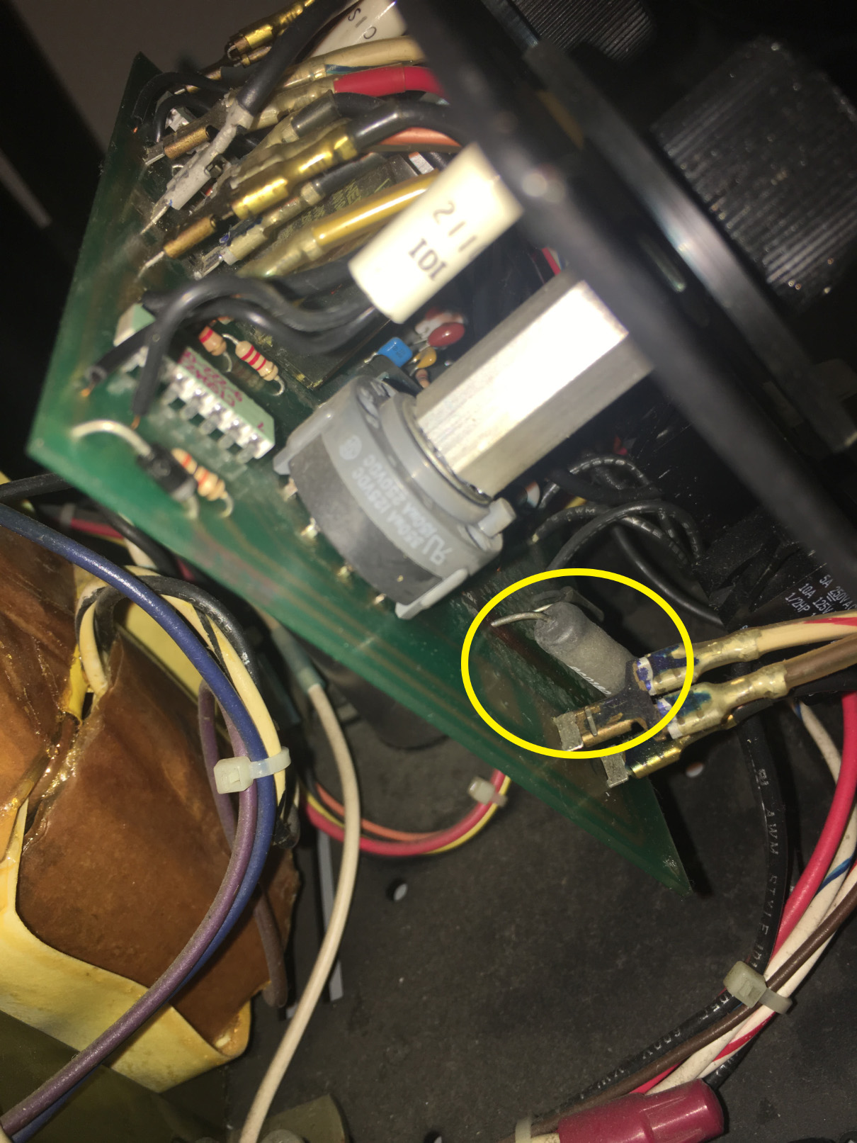

I watched the relay with the cover off and the buzzing is most definitely the relay going back and forth rather than a transformer hum. You can actually see it whirring as it opens and closes itself. I know it's not supposed to do this, as it will most certainly wear the relay out exponentially faster. I uploaded a video to youtube of the buzz.. damn near impossible to see it on the video but the insides of the relay are what the noise is. [video]https://youtu.be/-M2zs-4uE0c[/video]
The socket for the lamp in the head looks great. No corrosion, no dust. Same thing with the terminals on the lamp itself. The insides of the power supply are another story..

It sounds a bit different than mine. If the relay is chattering the DC supply(what there is of it) is likely bad. There is one large cap on the board - have a look at it is it bulging or vented? I had a look at my board earlier, not a easy thing to work on. Looks like a pain to remove and no silkscreen labels on the parts. Every part will have to traced out to ID them. Have a good look for any damaged or burnt parts, has it been repaired before. CR1, C2, CR5 would be prime suspects. I'm not sure what you have for test gear or your experience with this type of thing so don't go beyond what you are sure of. CR1 is connected directly to the hot 120VAC line with the neutral line playing the role of circuit GND. Nice way to blow up test gear if you aren't sure what is going on.

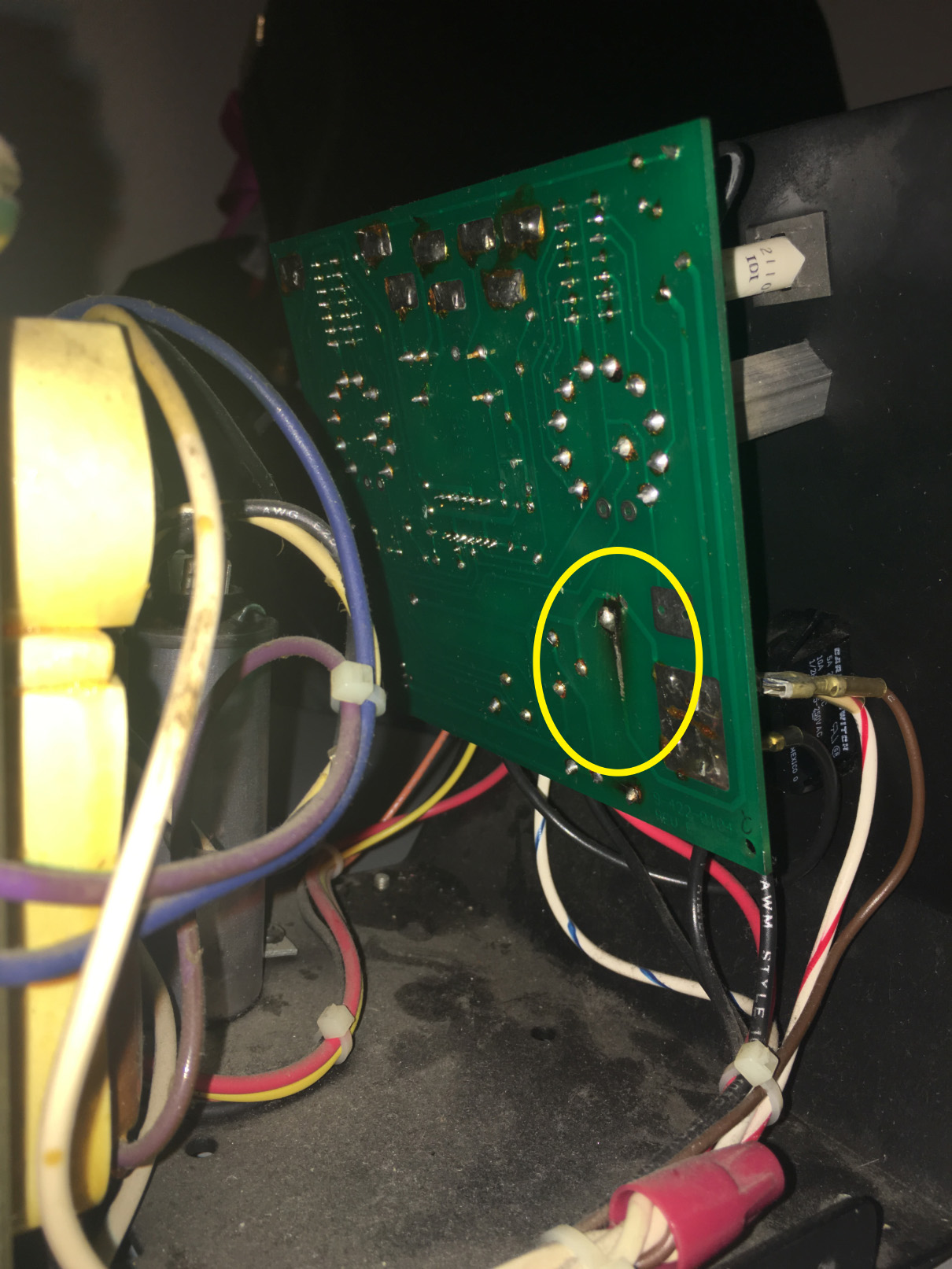

The timing function actually works perfectly. If I set a value with the pots and the multiplier dipswitch, it counts off like a champ.
Take a look at this: looks like a scorch mark and a damaged trace on a cap. No idea which one..

Since there is a scorch mark, you should probably replace that capacitor [those capacitors].

I'd have to go get mine again and the trip to the basement and back to the second floor would just about do my knees for now. I believe that is R2 1.5K 5W it likely runs warm. The main filter cap is toward the center of board, just visible grey. There is a lot of dirt there, that cap may have vented. The board needs to cleaned and the cap replaced, diodes checked etc. The timer working is a good sign, sourcing that IC might be fun. Time to get some parts and warm up the soldering iron.
