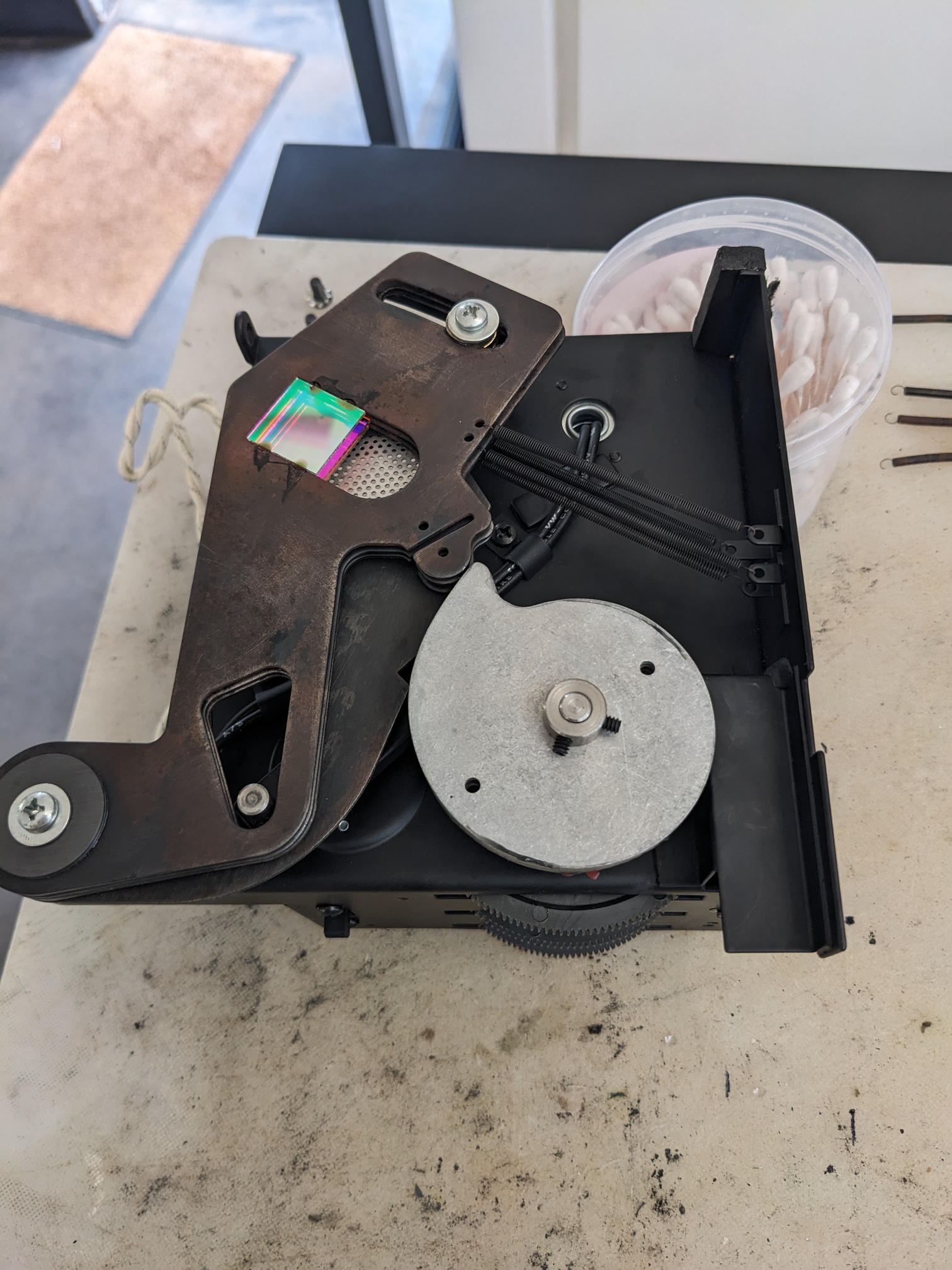

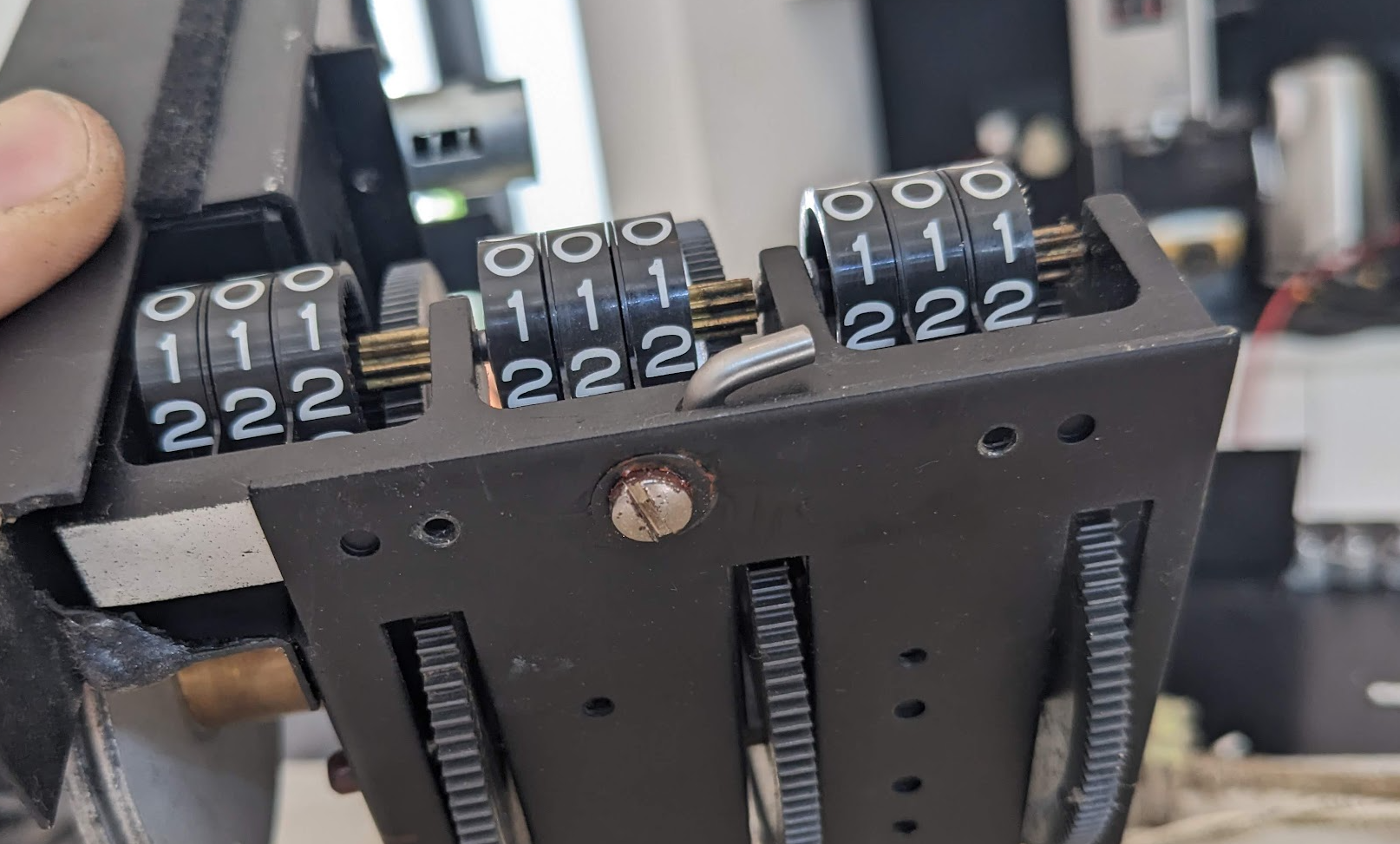

I've managed to find some time to finish the enlarger re-assembly. It was pretty straightforward. Having the cams and the adjustment system in and lubricated, my only headache was getting the numbers on the dials to line up on the horizontal at 000 and 170 (at either extreme). Unfortunately, if there is a way to fine tune this I couldn't figure it out as the value jumps by a tooth on the gear if you adjust the position so now I'll live with the 000 being slightly lower than horizontal at the extents of the dial movement. All good.

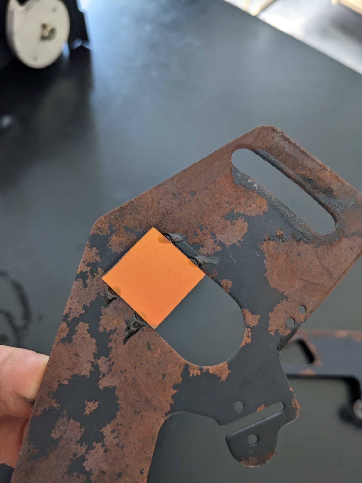

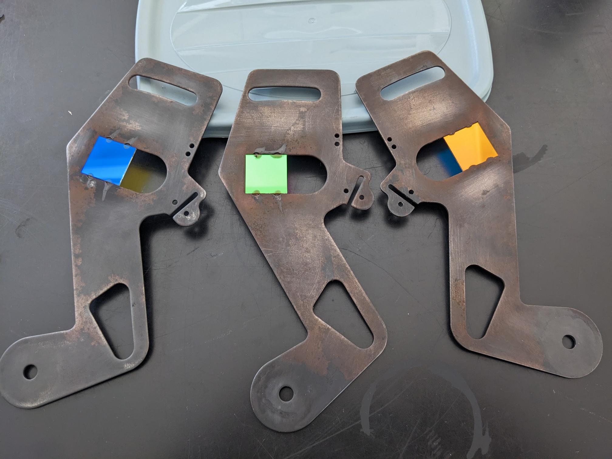

I hadn't cleaned up the filter holders and they had some light surface rust - this enlarger has come from Durban which is very hot and humid and on the coast. Here's a before and after. I used a kitchen scouring pad to clean this up, and didn't want to accidentally knock one of the Dichroic filters loose. So I guess this could be done better but it's fine for now and the rust around the pivot points is cleared off.

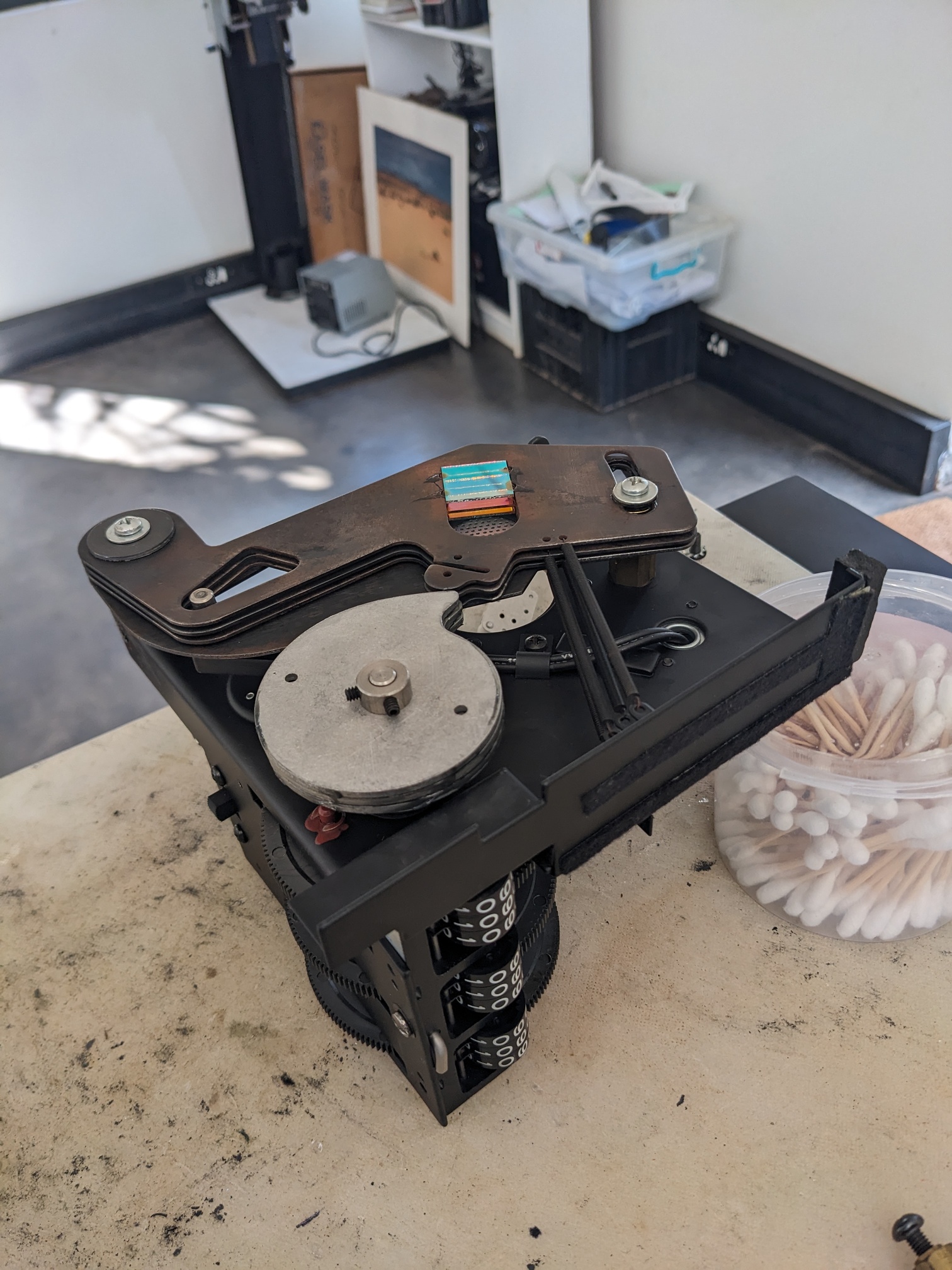

Reassembling the filters is quick and easy. I initially greased up the brass pivot lugs (for want of a better word) because of the grease I had cleaned off, but after putting it all back together I found that the grease was sticking and the springs weren't strong enough to overcome that friction, so I cleaned all the grease off again and used a few drops of watchmakers oil instead. I also found that overtightening the bolts holding the system together binds the movement, especially at the bottom where there are plastic washers, so tightening it just enough is the key. I did use grease on the filter cams though and it works well there. Also because I have the two enlargers I've been cherry-picking the nicest parts from each, even down to which screws and bolts look freshest.

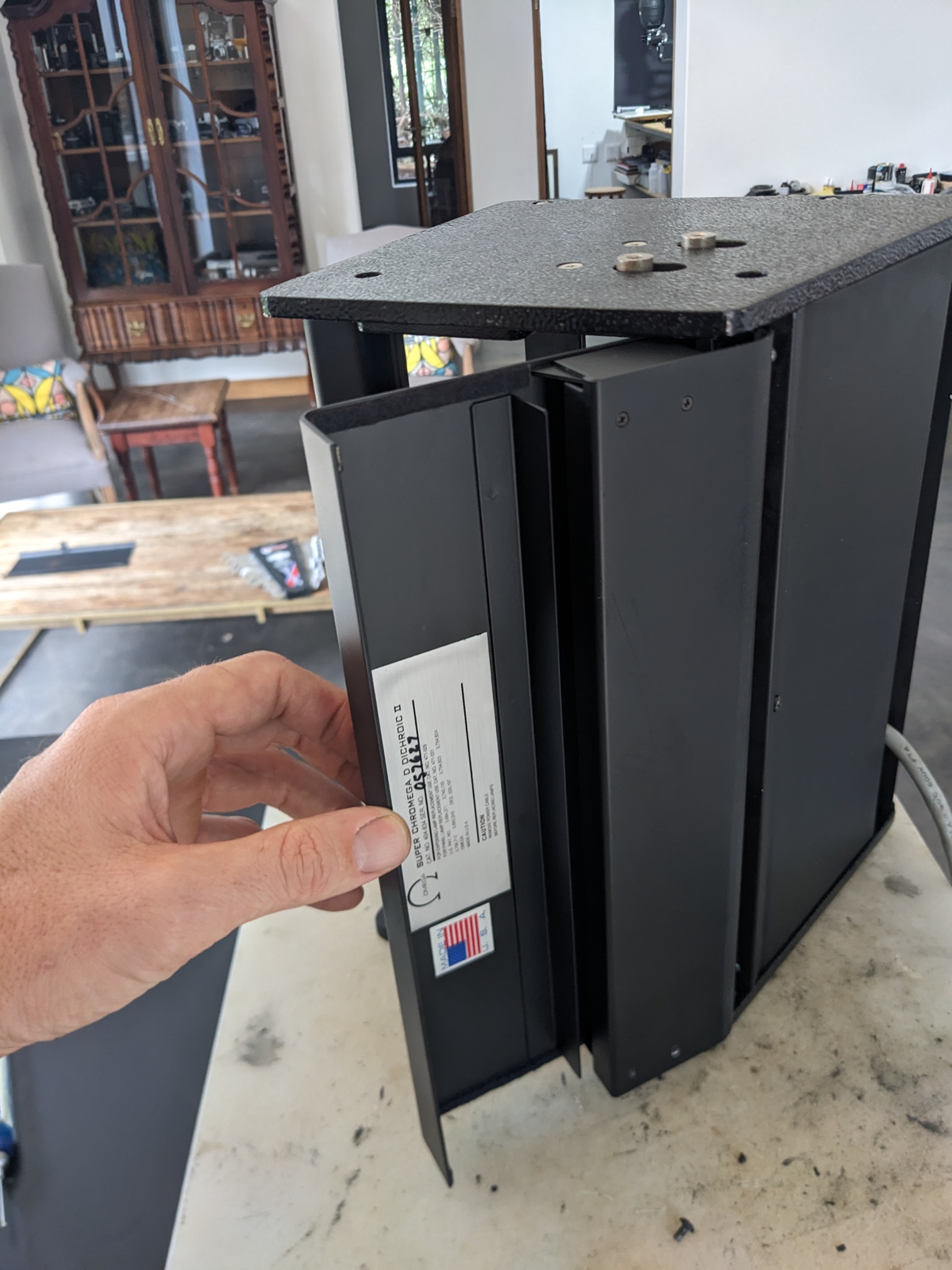

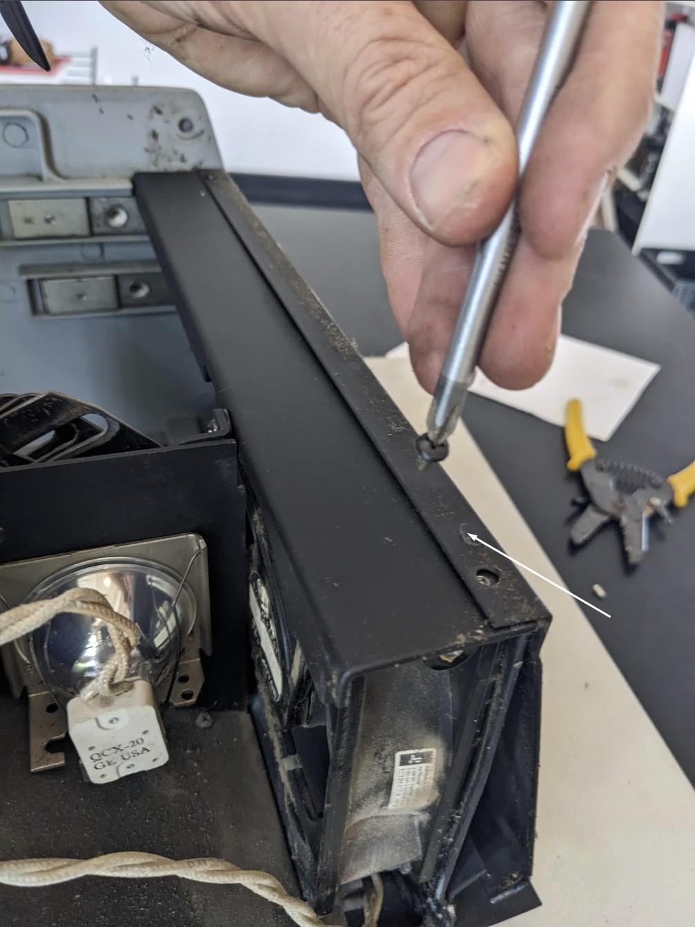

From here it was just a matter of reassembling in the reverse order of the taking apart process. Nothing is tricky here, and the only suggestion I have is that the rear most cover, which covers the fan outlet, should be screwed in on the top with 3 screws but the bottom screw should be left loose. The side covers of the enlarger need to mate to this cover and it's a lot easier to do with a bit of play there. Also, I had to do it twice as I accidentally installed the top hinged cover of the enlarger upside down.
Here is a shot of the cover. The two screws on this surface can't be accessed with the enlarger cover on, so these should be tightened up first.

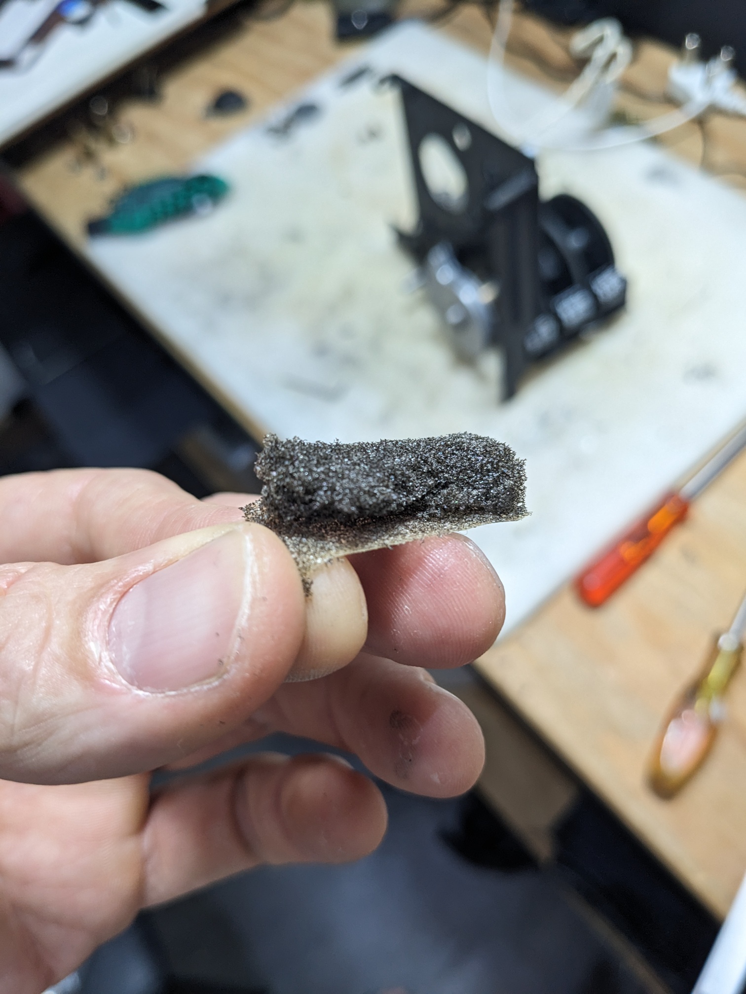

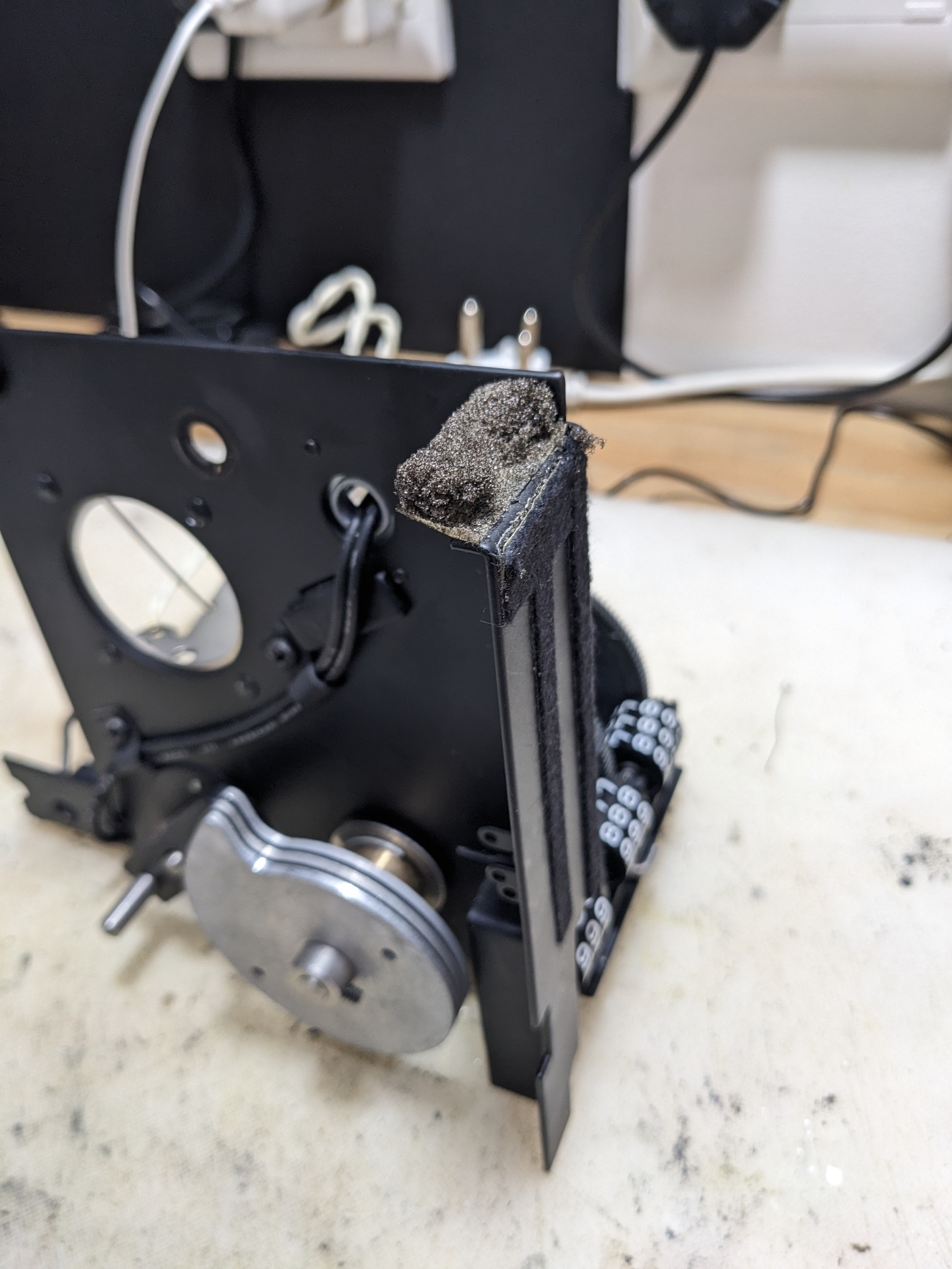

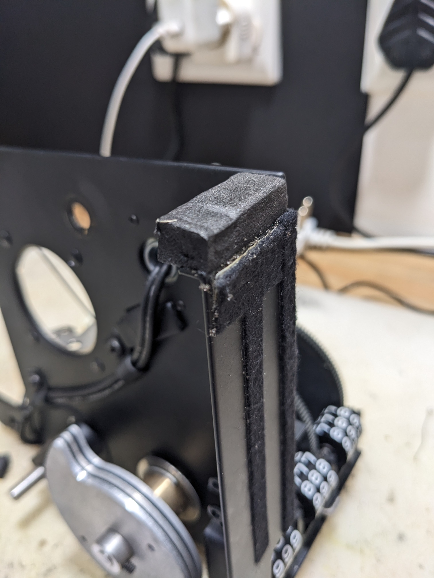

Ah, one thing I forgot to add earlier is that there is a short strip of 10mm thick light sealing foam on the filter assembly that has deteriorated in the manner of camera mirror bumper foam. I popped down to my local hardware store and found self adhesive foam strip that I replaced this section with.

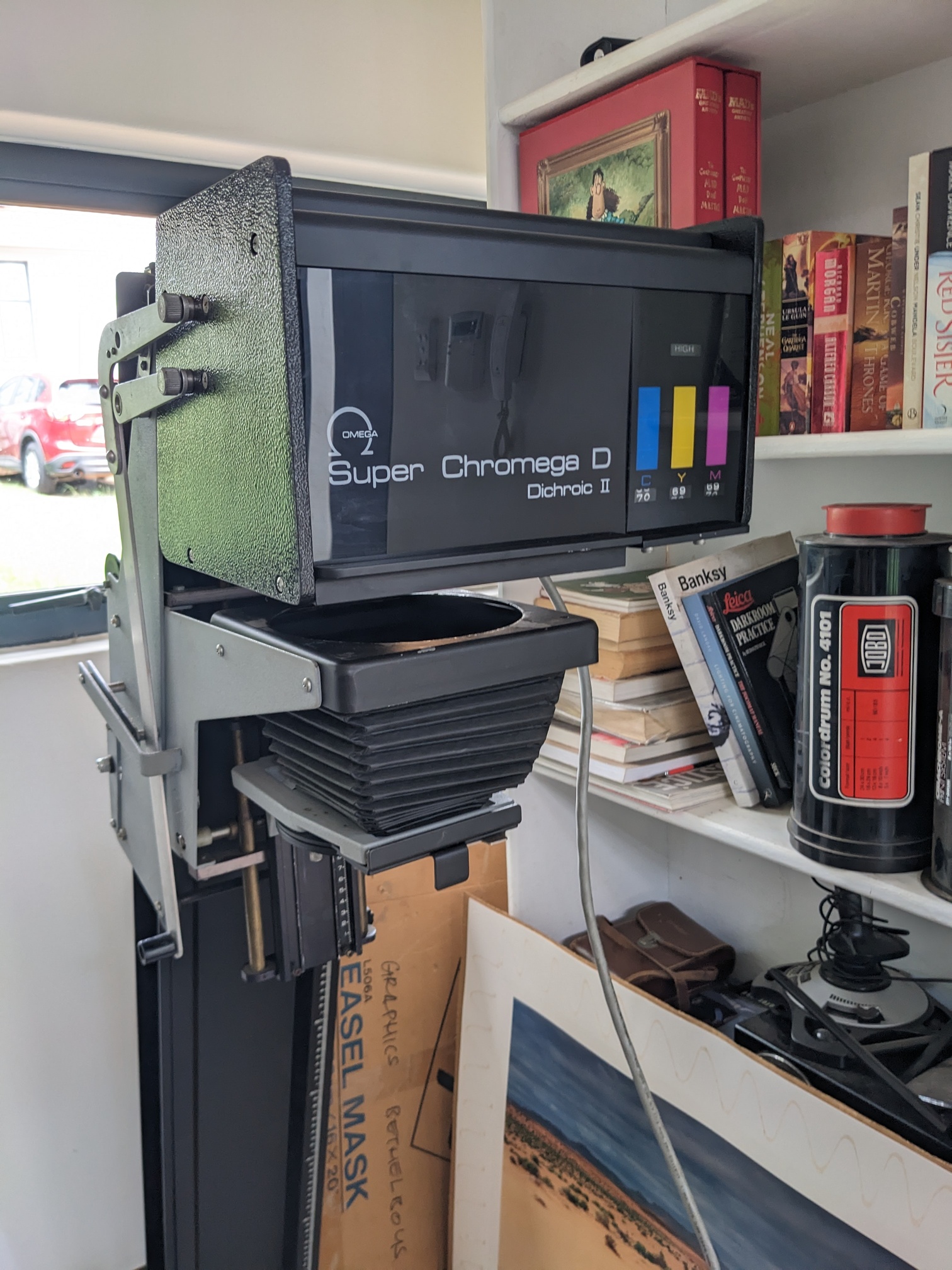

The enlarger is now back together and seems to be working properly! I can't wait to use it though I will probably need to do a similar process with the chassis which is pretty grimey, but I think I can test the setup out in the meantime :smile: My next mission will be to design a wall mounting bracket for this as my room is way too small for that base board.

This is great information - I just picked up the same enlarger, and while everything seems to be working properly, the indicator dials are not in alignment (at the zero stop, the dials read... not zero). Does it seem like there's an easy way to adjust those without taking the whole thing apart?
So mine are also about a half click off zero when they are zeroed. You can release the dials without taking too much apart by taking off the front cover and then releasing this screw a bit. It's a bit fiddly, but but will give you a bit of play on the dial positions. There are also grub screws on the adjustment wheels that if loosened will give you a bit of adjustment to get the teeth of the wheel aligned with the teeth of the dials. But I think you'd need to disassemble more of the enlarger to get to those.
