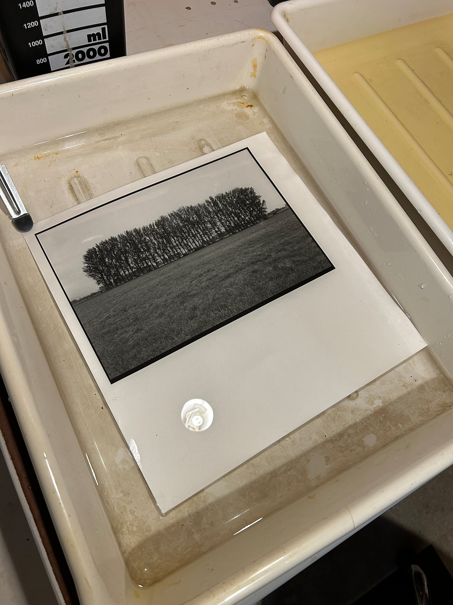

Printed with a Canon ImageProGraf Pro-2600 on Ink jet transparencies sheet. No profile. Not tried to print it.
I just printed the “negative” on some fiber based silver gelatine paper. It looks OK to me.
So at least one prove that it can be done with a Canon inkjet printer.

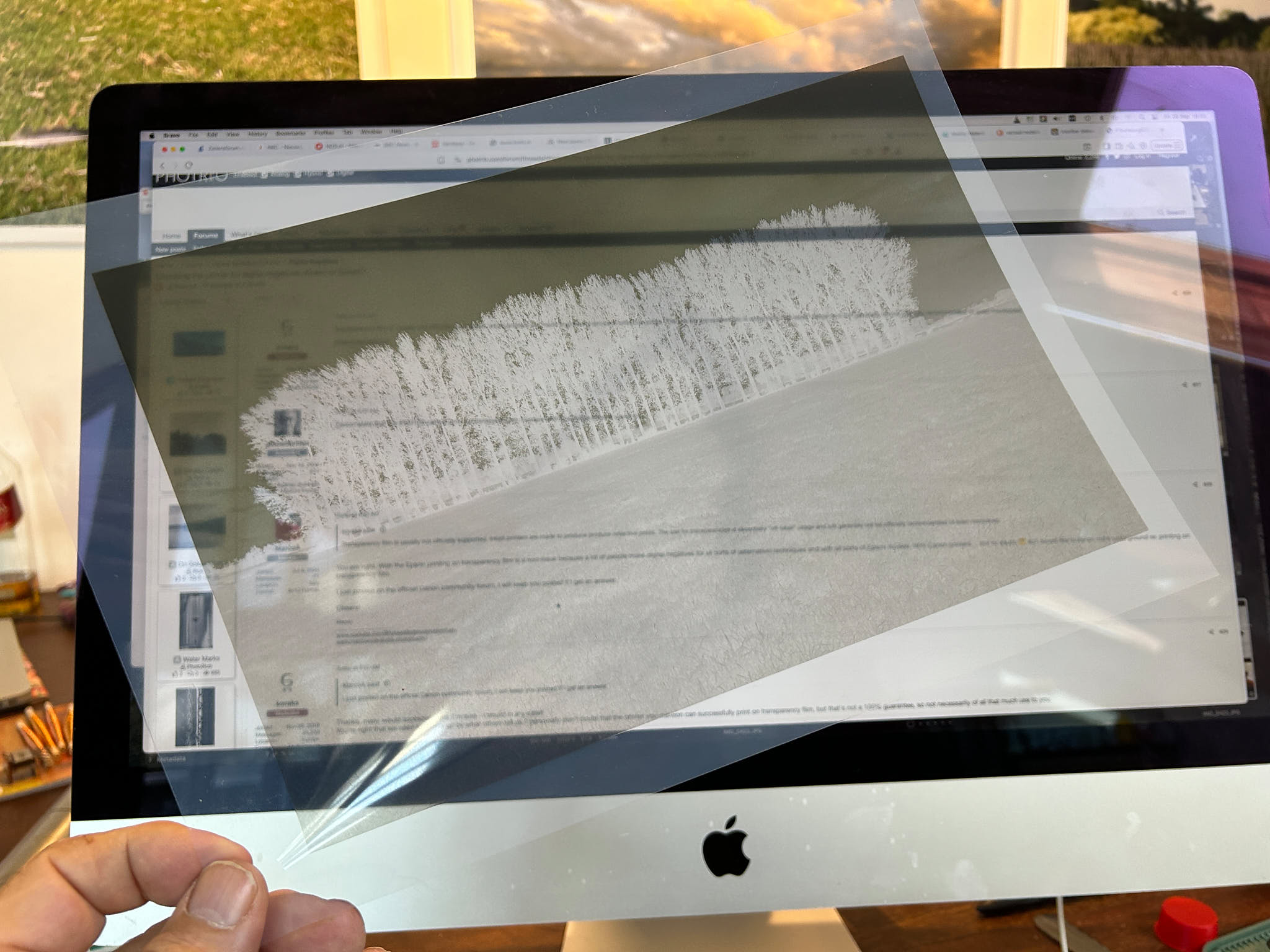

An update.
1. I bought the Canon IBF 1100-Pro.
2. Spectacular results printing color images. I profiled various Canson and Hahnemühle papers with ColorMunki+Calibrite and the results were _to_my_eyes_ (Norman Koren "target") indistinguishable (D50 illuminant) from those obtained with canned profiles of the two companies above. (Message to myself: ColorMunki makes sense for unknown papers or those without an official profile.)
The situation at the moment re: digital negatives is as follows.
I digitalize (Negative Supply setup, Leica SL2, Sigma 105/2.8 macro) a calibrated 31-step Stouffer step-wedge. The entire workflow is profiled. The Leica's DNG file is converted (no color management) to a TIFF file that I print on various transparency foils. The step-wedge reaches D=3.06. I know I will never get there (and I do not need to) but I also know that to get clean whites I must have a digital negative with at least a D=2.0 - 2.1.
Good news: the 1100 does print on transparencies. Bad news: when I print the Stouffer step-wedge on vanilla OHP I get about D=0.8. When I print on Inkpress Transparency I get D=1.4. Right now, therefore, I am not able to generate digital negatives with the Canon 1100.
I have still few cards to play, including a number of OHP I have not tried yet (Pictorico in the first place). I did not find RIPs for the Canon 1100 that modulate ink deposition a la QTR.
Let me just remind you that I do not produce digital negatives for Alt-processes but only to use them for contact printing silver (chloride and bromide) gelatin paper. Therefore, whether the inks are UV transparent is of very little interest to me.
This is definitely work in progress, I will keep you posted.
Cheers
