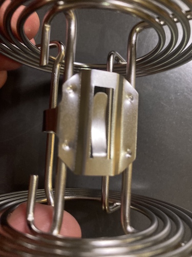

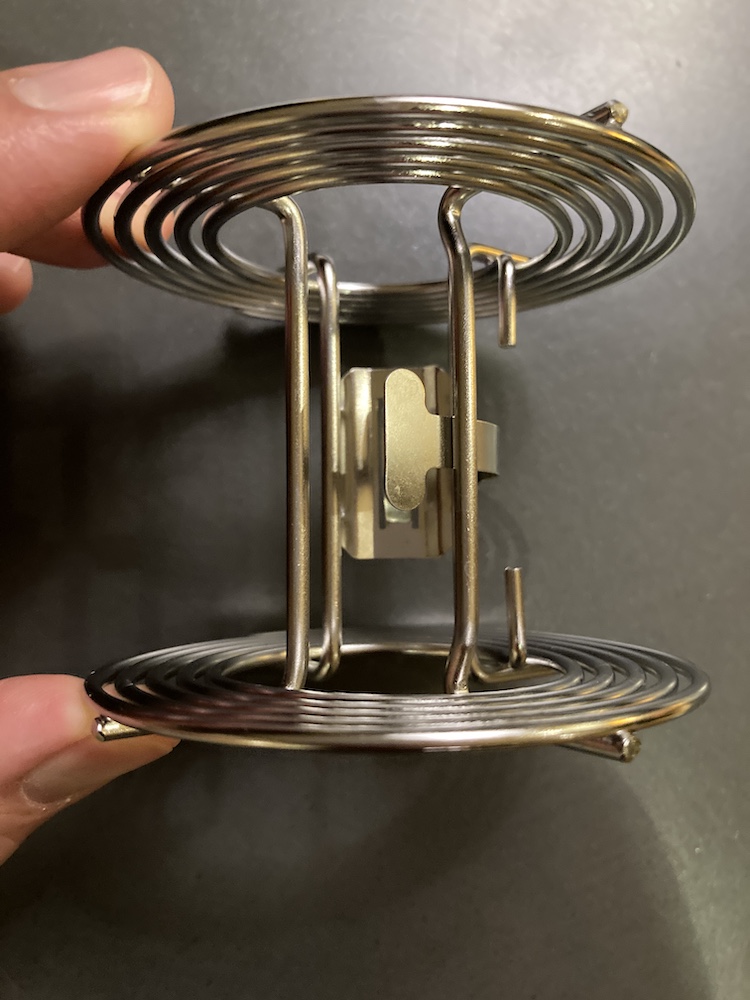

I'm used to the hewes reels in inversion tank and I do use the clip when inserting the film although I don't understand what you mean by crimp the end.
When I realised that the film was out of the reel after development I did some simulation with water and what is going on is that at first the beginning of the film is still inside the clip but the rest of the film slowly getting out of the reel. I used those reels in inversion process with a Paterson tank and did not see this happen.
I got a very subjective feeling that those reels are slightly more loose than the standard hewes reels for metal tank and the clip in the center is of a different design.

I got a very subjective feeling that those reels are slightly more loose than the standard hewes reels for metal tank and the clip in the center is of a different design. I'm trying to post a picture of it but I can't I'm told it's too large but it's only 300kb..
Resize it down to a jpeg with 1000 pixels on the long side.

Humm there is this extra clip, maybe it serves a purpose ?
The Hewes 35m reels have pins to secure the perforations on the edge of the film while the Hewes 120 reels have a clip in the spindle area fo the reels to secure the film.

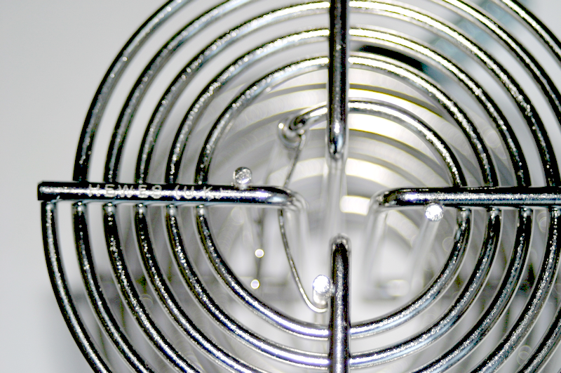

Do you see Hewes imprinted on the spirals?
Like this:
MattKing
Apr 24, 2005
53,097
Delta, BC Canada
That shows the film clip in the center.
That is from a reel not designed for JOBO tanks - I was referring to the printed words "HEWES (U.K.)
First of all the Hewes reels you have are for 1500 series tanks. Hewes makes an even more expensive, larger diameter, reel for the 2500 tanks. The "extra clip" on your reel is so the reel doesn't spin on the center column. This may be a contributing factor of the film coming off. I have a couple these Hewes for Jobo, once I learned how load Jobo plastic reels, I don't use these much anymore.
Use the volumes specified for 220 film, that will insure the film in immersed in the chemistry.
