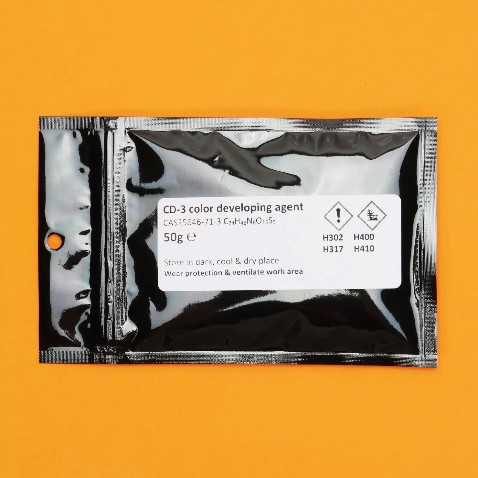

Hi, I know this is an old topic. I am looking through the table of commonly used substances for color and B&W processing and their trade names.
I want to buy Color Developing Agent CD-3. This table specifies the CAS for CD-3 25646-71-3.
On Ebay in Europe, there are currently two sellers selling CD-3. Both in the offer titles CAS 24567-76-8. But one seller in the photo of the packaging has CAS 25646-71-3. See the photo in the attachment. Two different CAS numbers, which means that these are two different chemical substances. Since I could not find an explanation anywhere on the internet, I asked Chat AI. I got an answer but I am not sure if I should trust 100% what it tells me.
Explaining the Difference
24567-76-8 (free base) and 25646-71-3 (hydrochloride) are two different CAS numbers for the same compound in different chemical forms. In photographic practice, both forms can be used, but:
The free base (24567-76-8) is more commonly listed in process specifications such as ECN-2.
The hydrochloride (25646-71-3) is more stable in storage and may be preferred in ready-mixed chemistry.
In Kodak documentation (e.g. for ECN-2 developers) and photographic literature, CD-3 is usually identified by 24567-76-8, confirming that this CAS number is more appropriate in the context of pure CD-3 for photography.
So does your table give the correct CAS number 25646-71-3? If someone has experience with this chemistry, can you tell me if both CAS are suitable for ECN2 developer and can be used interchangeably? The same amount, i.e. 4g per liter?
The material pictured in the photo of your post will work for ECN2.
I don't think there's in practice any difference between these two CAS numbers. The functional group is the same and the molecular weight is also equal. So yes, you can substitute weight for weight.

Thank you very much for your quick and valuable answer. I wonder why I haven't found similar doubts about different CAS numbers anywhere on the internet. I was most concerned about maintaining the correct pH of the solution. After all, the free base will certainly have a different pH than the hydrochloride. Or am I wrong? Thank you for your advice on dissolving the developer components. I am browsing your blog "Koraks Tinkers" with interest. It is a basic source of knowledge about photographic chemistry for me. Keep it up! Thank you again.
The note on pH is relevant, and to be honest, I've not really pursued it. All the CD3 I have used so far has fizzed quite briskly when added to an alkaline solution, so I assume they're all acidic (i.e. the hydrochloride). I never really looked into it, but the AI answer you came up with might be the explanation - perhaps the hydrochloride is the more commercially meaningful form. I really couldn't say; perhaps someone else could chime in on this. Either way, I've noticed no problems with the developer I make using this material and I have to admit that I've given up on measuring pH quite some time ago. Instead, I just mix the same recipe fresh for use every time, and rely on consistency more so than on absolute correctness. This seems to work well for me, even though I expect my developer will be slightly off the mark one way or another. That's OK as far as I'm concerned as long as it's consistently (and not too far) off the mark.
Thanks for the kind words about my blog; I'm glad to see it is of use to some.
From both of your answers it appears that you have dealt with (and used) both forms of CD-3 (CAS 25646-71-3 and CAS 24567-76-8). Since I know that you actively make prints using an enlarger and chemicals, your statement that it works well simply reassures me.
Personally, I will probably never get involved in working with color materials and an enlarger. It is too complicated and too expensive for me.
The case is different when it comes to making black and white prints.
I scan my films using a dedicated Reflecta ProScan 10T scanner and the VueScan program (48bit TIFF without any color manipulation). Then, using PhotoShop and the Grain2Pixel plugin, I invert the negative to positive, so I have a lot of possibilities for color correction in post-processing. I can therefore assume that if something works properly for you, it should work perfect for me. Thank you for your good advice and best regards.
EDIT: I read in the comments to your blog post ("Color me purple....") that the CD-3 has a tendency to fizzle. This is a really fantastic blog !
To be frank, it has been impossible for me and I never bothered to verify which species I actually had, but I do know the actual product that you showed and I know 100% that it works for this application. When you buy CD3 (or anything, really) all you have is what the seller tells you about the material. You'd actually have to do chemical analysis to figure what you have and often, that's just not feasible. In this particular case, I figure that we know what we have due to the fizzing reaction, but I'm not certain about that. All I'm certain of is that all the CD3 I've ever used (from several sources, over several years) has always worked pretty much the same for me. So I never really worried about it.
Also, scanning is great. I've just done a series of holiday snaps (several rolls of Vision3 film in ECN2 developer using the exact same CD3 you showed there), scanned and then inkjet printed. It's nice to be able to print in daylight! I might also print a few select images in the darkroom as well. One doesn't exclude the other!

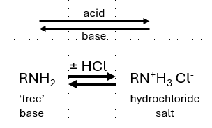

@Spektrum , if you have pH deviations (small ones, I hope), you can correct them. The Kodak official ECN-2 “recipes” advise you to correct the pH using an acid or a base. The recommendations for each bath are right under the table of “ingredients”.
A little basic (no pun intended) chemistry...
The chemicals you list are two forms of the same compound, differing only by the presence/absence of a hydrochloride acid molecule.
In aqueous solution, both forms of the compound exist in equlibrium with one another. The balance between the two forms is determined by the pH of the solution and can be shifted by adding either a base or an acid to the solution.
For CD-3 (abbreviated 'R' in the figure below) the chemical group involved is the amine (NH2) group.
I have illustrated the chemistry below...
If you make a solution starting with the free base, the pH of the final solution will be higher that if you start with the hydrochloride. How different the pH will be depends on many factors, chiefly the concentration of the compound and the identity of the other components of the system. Whether this difference in pH will matter depends on the application.
There is also another factor to consider... the molecular mass. HCl has a molecular mass of 36.46. This difference in mass should be accounted for when substituting one for for the other in a recipe if the same molar concentration of the active ingredient is critical. This, again, may or may not be important depending on the application.
Thank you very much for the very detailed explanation of the differences between these compounds. 👍
