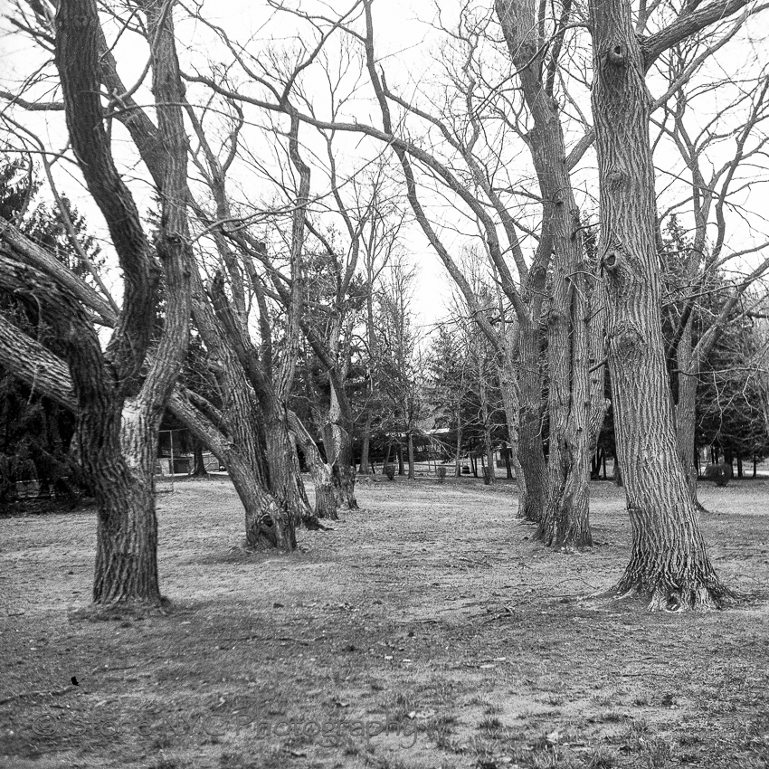

Tmax 400@400 in Parodinal, 1:50, 20.C, 10 minutes
Times in rodinal must be the same

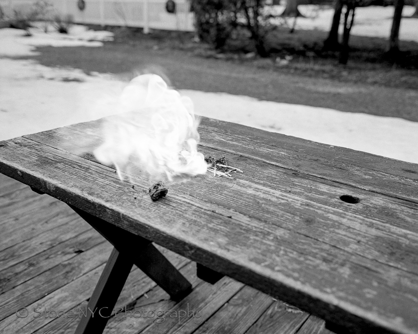

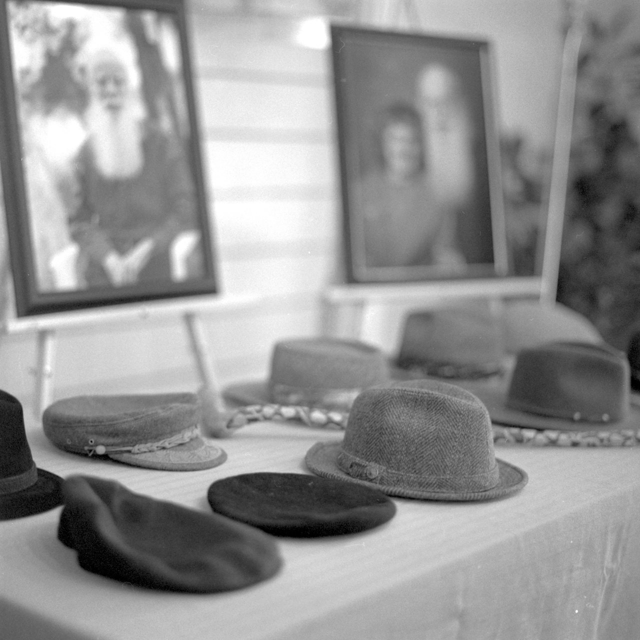

Efke100, HP5+, Tmax400, Acros100 all in Rodinal 1:50

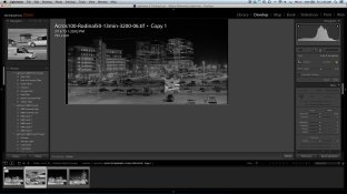

AND to give you a better example of the kind of grain you'll see with Acros100.... this is a 30-60 second night exposure I did, ignore the streaks a car went through but I wanted you to see the grain... this is the area I cropped to show you a 1:1 at 3200dpi scan of the little amount of grain i have... Screen Shot 2013-03-22 at 2.40.48 AM.jpg
Not too bad...

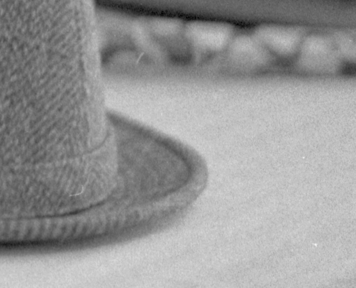

Here's a TriX 320 shot freshly dev'd in Rodinal semi-stand (1:100, 1hr)
And its 100% crop
This is a straight-up scan with my V700 @ 2400dpi, no noise/grain reduction etc., and no PP.
