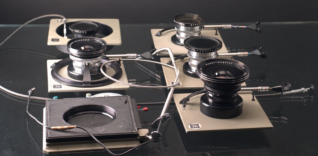

Sinar Norma Hasselblad Digital Back Norma Lenses by Nokton48, on Flickr
I'm starting to use this CFV16 Hasselblad Fat Pixel setup and I really like it. The Norma Super Angulons are sharp and contrasty, and I can apply all camera movements precisely if I desire. So also I am repurposing what I already have. With the Norma Shutter and Auto Aperture Mickey Mouse Aperture Controlled Norma Lenses (matching complete set), this will do everything I want, and is FUN to use.

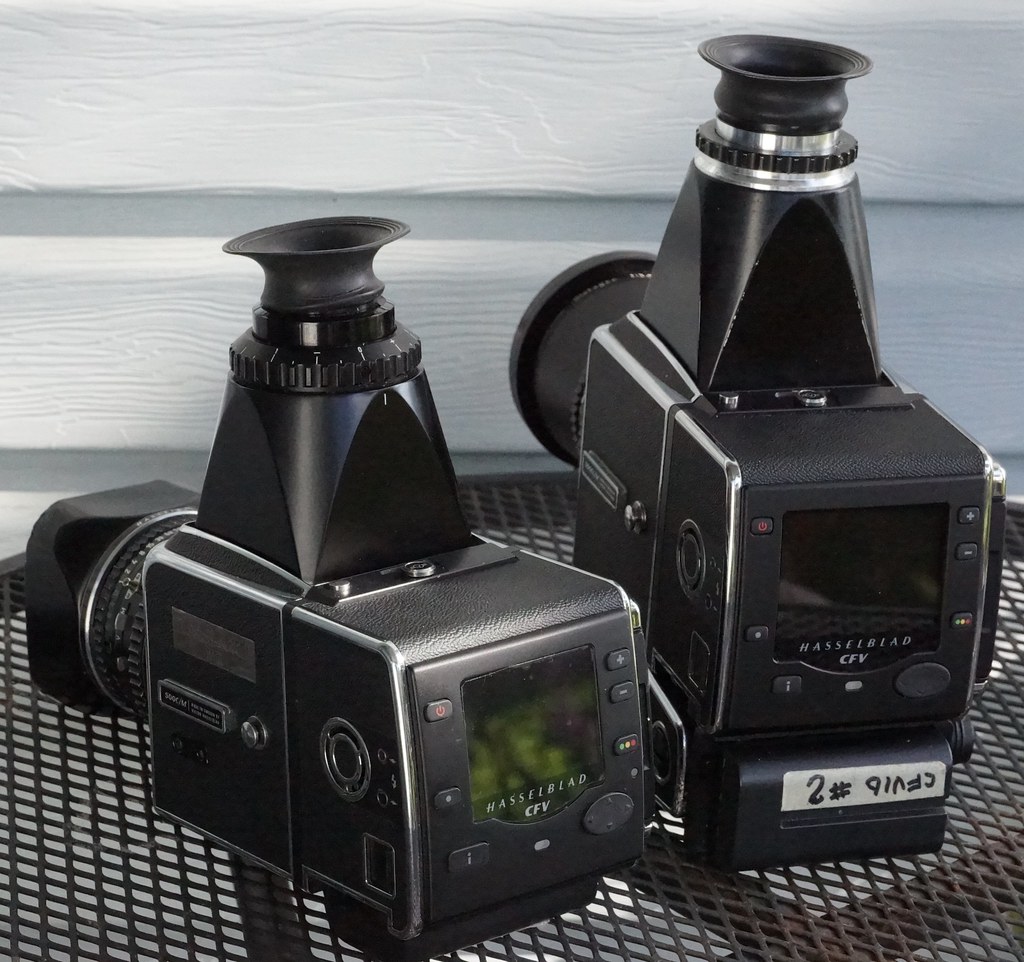

SONY DSC by Nokton48, on Flickr
Phase ! 4x5 Hasselblad V Rapid Adapter, attached to 1960's Sinar Norma 4x5 with Norma Pan Tilt Head. I masked down the edges on the glass, to the dimensions of the 37x37cm chip, and then also masked off the edges of the ground glass, there was too much backlight coming in to view properly. Now it is working perfectly with the Hasselblad CFV16 Digital Back. The Sinar Norma Shutter is connected to the back via a Hasselblad Cable which plugs into the back. I'm currently using the Hasselblad Stovepipe Viewfinders (I have several) for viewing the groundglass precisely. This digiphoto made with Broncolor Octobox 150 with 150 Grid creates beautiful catchlights. Background is Tim Kelly Beige by David Maheu.
