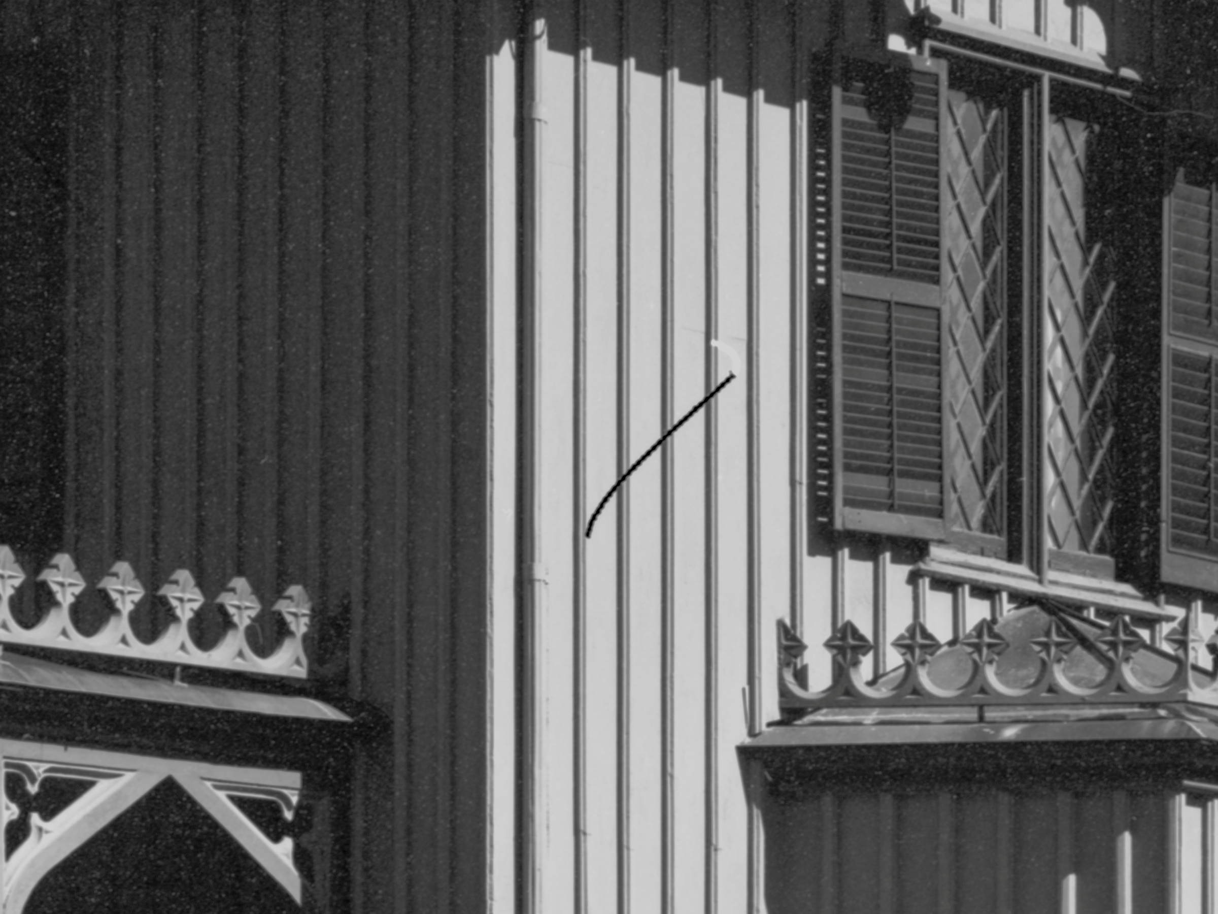

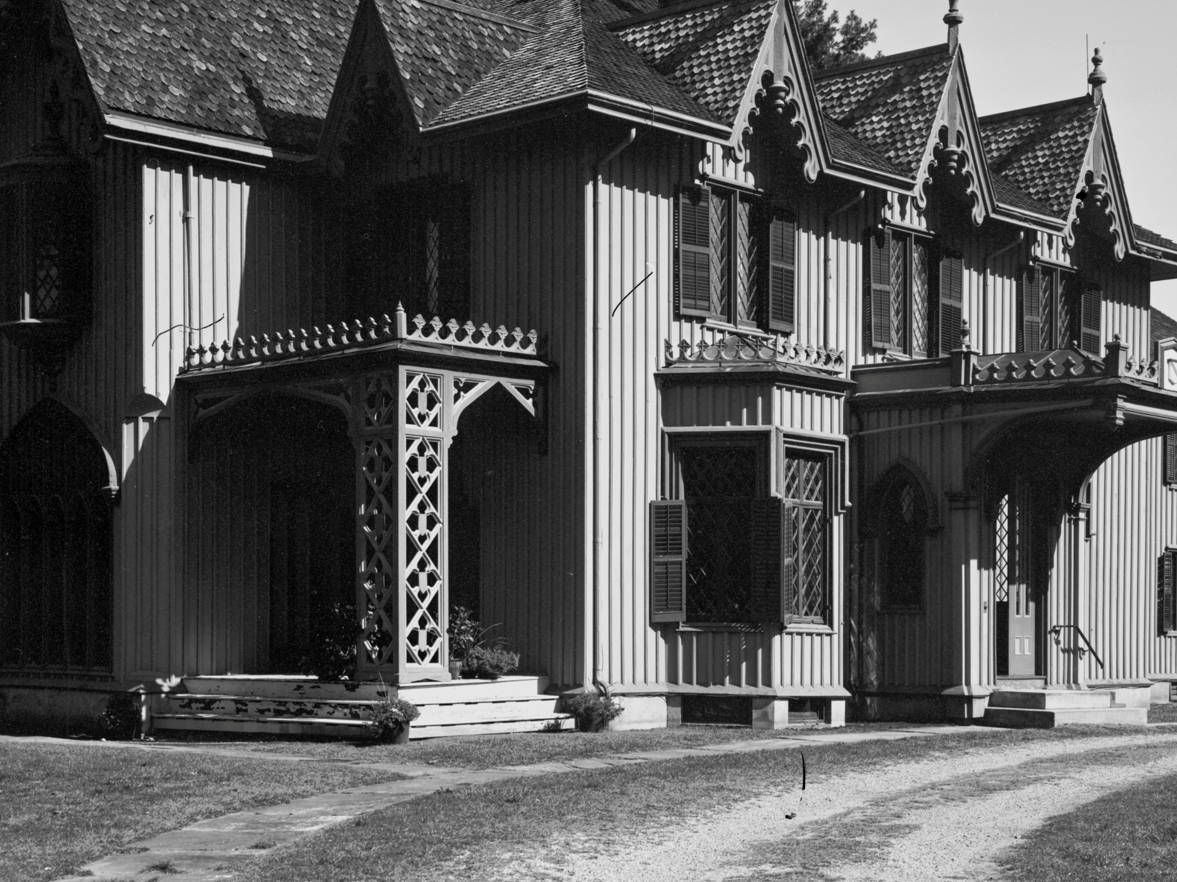

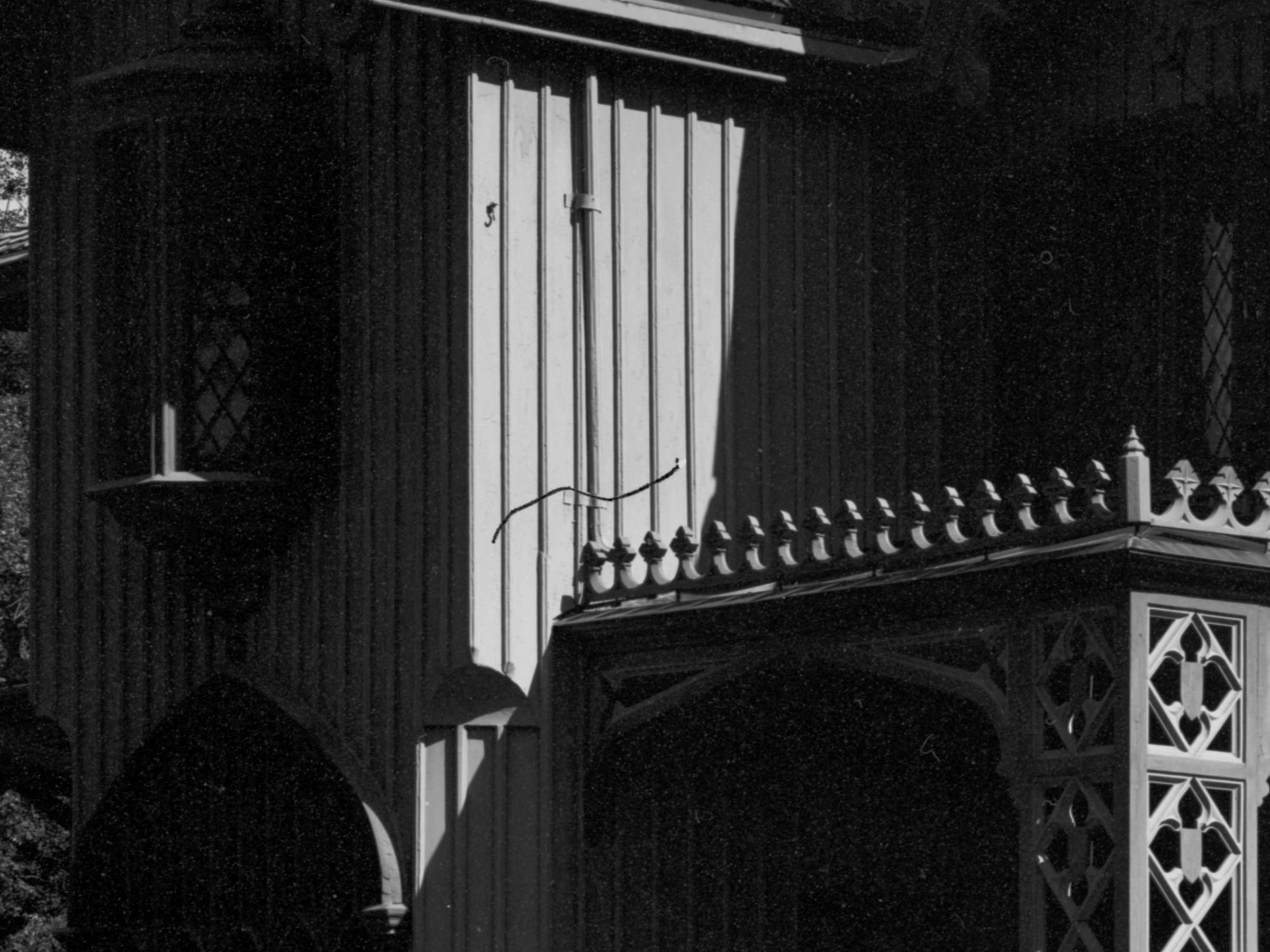

Good Morning,
Here are some examples that I found with this pack; 2 out of eight sheets had finite abrasions in the emulsion. They were processed emulsion-side in, and no rough handling involved. I never had these issues with HP5+ nor Delta 100. Maybe just a fluke batch, but I don't think that I would use this film now until I had a bigger comfort zone for the effort involved. The artifacts are on the outside walls (2) and in the middle of the driveway.
Regards,
Edd
Thanks for posting. This is the kind of abrasion I expect to see if a sharp corner of one sheet (or another kind of sharp/pointy protrusion) touches the emulsion side of another sheet when wet. What happens then is that the emulsion is locally scratched away, and the little peel clings on to one end of the scratch and forms a high-density mark there.
Scratches on dry film tend to manifest as high-density pressure marks mostly, or also low-density scratches where the emulsion is actually lifted, but you'd then also get a little high-density pressure mark at the start of the scratch where the pointy object starts to dig into the emulsion.
So my first thought is that this is caused during the wet stage of the film.

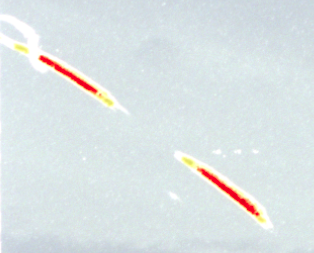

Edit: some examples for comparison.
This is on color film, but illustrates the principle I indicated above: emulsion is peeled off in places (the red & yellow stripes) and then deposits in a little curl/peel at the end of a scratch (top left in this image). The red/yellow anomalies are explained by the structure of color negative film; you get minus density/black on an inverted B&W positive.

Good Morning,
Regards,
Edd
Edd, we need to know how you processed these films. What I believe I see is in line with what kodaks has suggested: these are abrasions occurring during processing (while wet), where one sheet "gouges" into the one below it. Are you developing in trays, and more than one sheet at a time? If so, I would guess that this is an abrasion incident. Fomapan is softer than any Ilford film and is much more easily scratched when wet.

I'm doing one sheet at a time in either the Beseler Color Drum or in a Jobo Drum, rotary processed. I also have a Heath "Color Canoe" handy if needed!
I find that when using drums or tubes for processing, it's easy to accidentally dig one corner of the film into the emulsion while unloading the film from the tube or tank. I find it's particularly a risk when using BTZS-style tubes, which are very narrow. Drums like the Jobo & Beseler are less risky, although the same thing can still happen. Having said that, the location and direction of the marks on your example sheet doesn't look like the typical "corner-oops" issue as I've run into it on occasion myself.
Agreed; I've been doing sheet films since the 60's and although anyone can be "ham-fisted", I am pretty sure in my loading/unloading techniques over the years. That's why my OQ was about the film, and not handling technique. I do want to thank everyone who took the time to comment!
