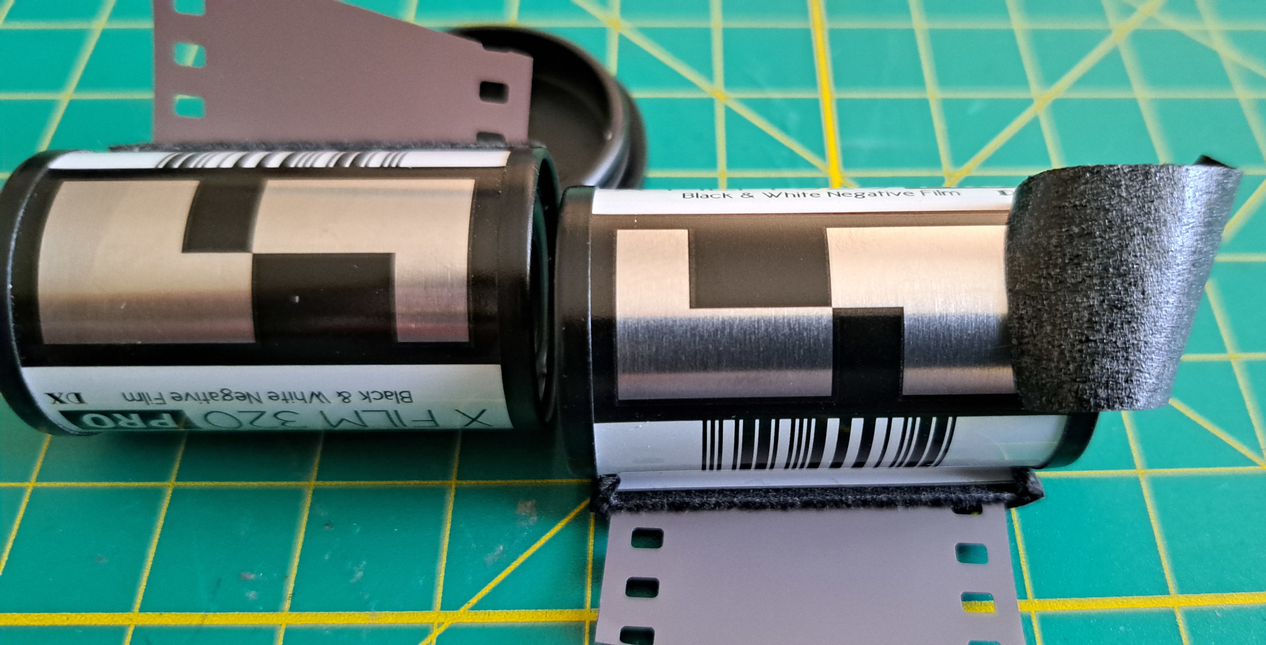

I finished running my tests. I have no reason not to like this film. In fact, I find it very easy (and pleasant) to work with. It has exceptionally low B+F density (for a 35 mm film) and it dries super flat. It also seems to resist drying marks rather nicely. The grain is fine and tight. I would imagine this film would scan really easily. I discovered no emulsion flaws, whatsoever. One interesting bit is the fact that on all three 35 mm cassettes I bought, the DX code was covered with a piece of black electrical tape. Finally, as there's been some speculation as to the film's origin, in my experience, the film does not resemble any of the current 35 mm films by Harman (including Kentmere), Foma, or Kodak. The film base, is similar to that of the Rollei Retro 80s, but I make no claim that the film is made by the same manufacturer as the Rollei Retro 80s.
I wonder why this was the case? Have you taken the tape off to see what the code underneath reveals assuming there is a code there?
pentaxuser
I think I read somewhere that cassettes are in short supply, so perhaps CatLABS couldn't find cassettes with the right DX code. Besides, ISO 320 is a little unusual, so they may have been in short supply anyway.
Thanks aparat for the photos of the code on the cassettes. Does anyone know what this represents in terms of speed?
Does Catlabs mention this use of electrical tape anywhere in its details? The problem arises with some P&S cameras such as the mju II which reverts to 100 without a DX code. Of course not a problem if the real speed is in this region. Still it might be nice if owners of such cameras were made aware of the use of electrical tape

Left cassette in pic
1250 iso
24exp, +2/-1 exp tolerance
Seems a random choice hence the black tape.
for those wondering there is a code for 320 iso.
1250 iso
Thanks It gets even more intriguing. It may be that whoever "confections" the film for Catlabs is unable to make/obtain a 320 code and using what ever it can find and then attaches (by hand?) electrical tape?
It might be helpful if others buying this film were to check their cassettes for DX codes as it might be that whoever is confectioning the film is having to use whatever cassettes it can find so other cassettes have other codes
I had no idea that any previous films were 1250 but there must have been such films for this code to exist
It might be a temporary matter of course. Maybe Catlabs will shed some light on this puzzle?
