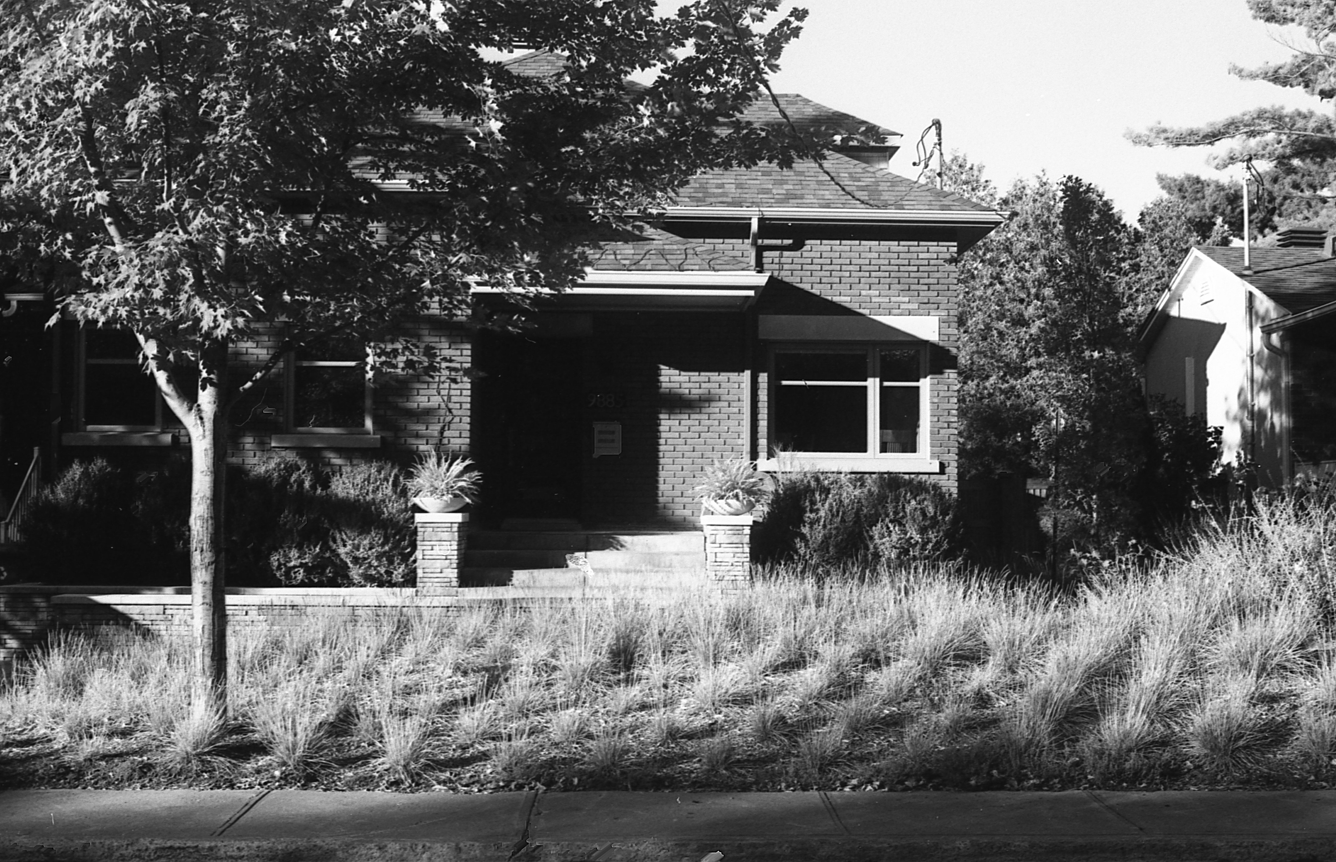

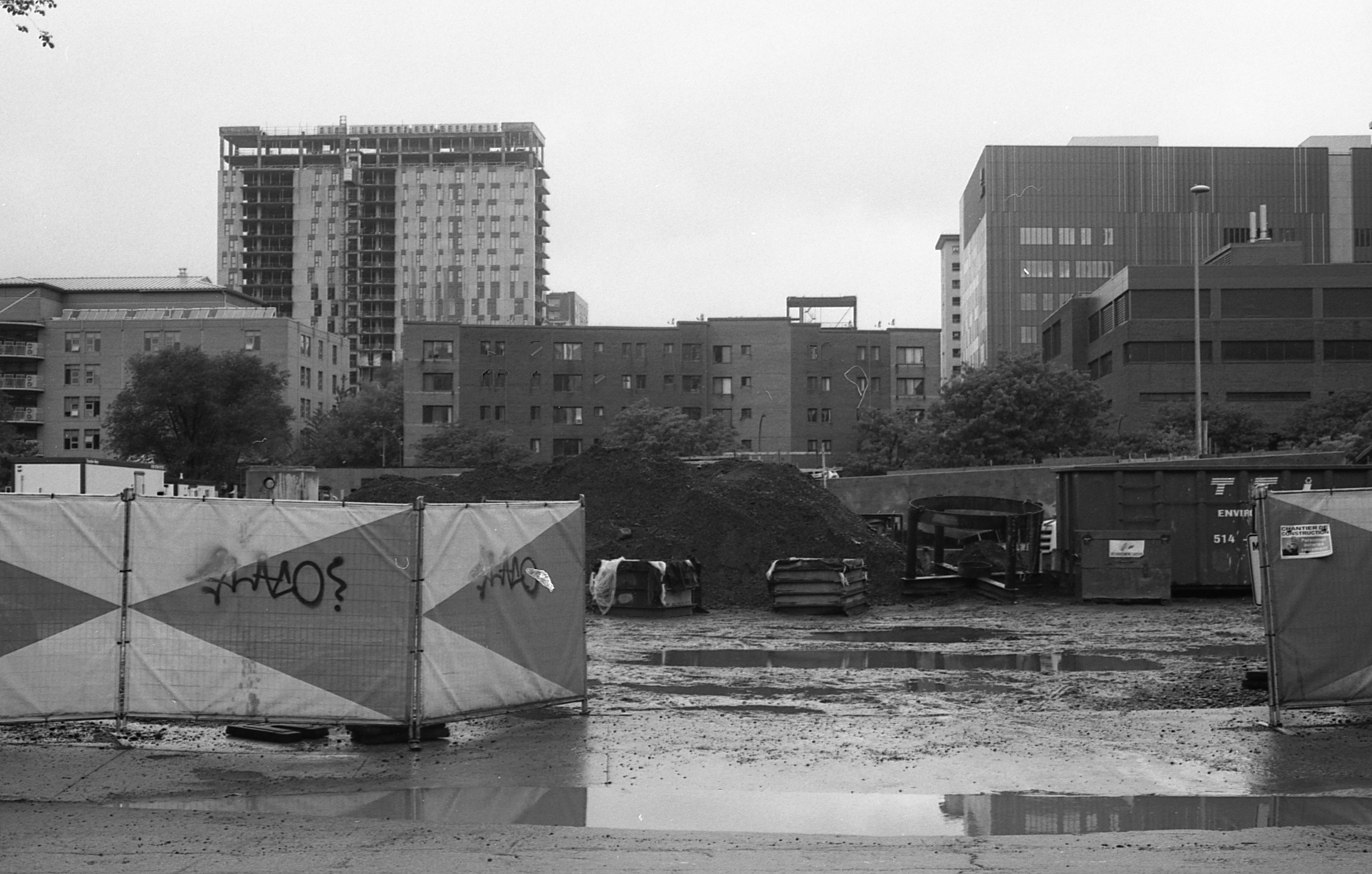

If I can take anything out of you photos Alex it would be that in overcast light at 200 there seems to be reasonable detail in the shadows but in bright sunlit scenes it may struggle at 200 with dark shadows

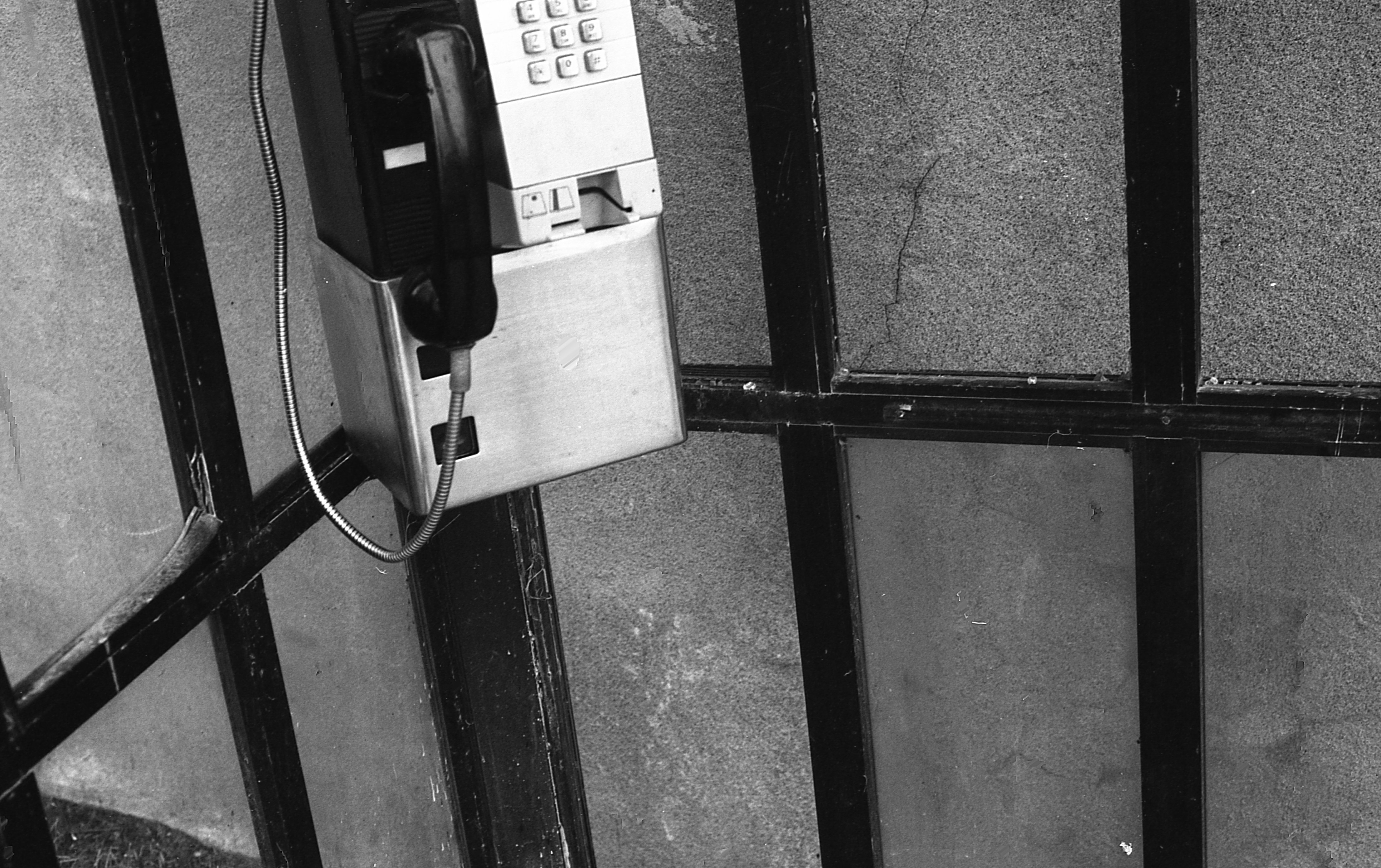

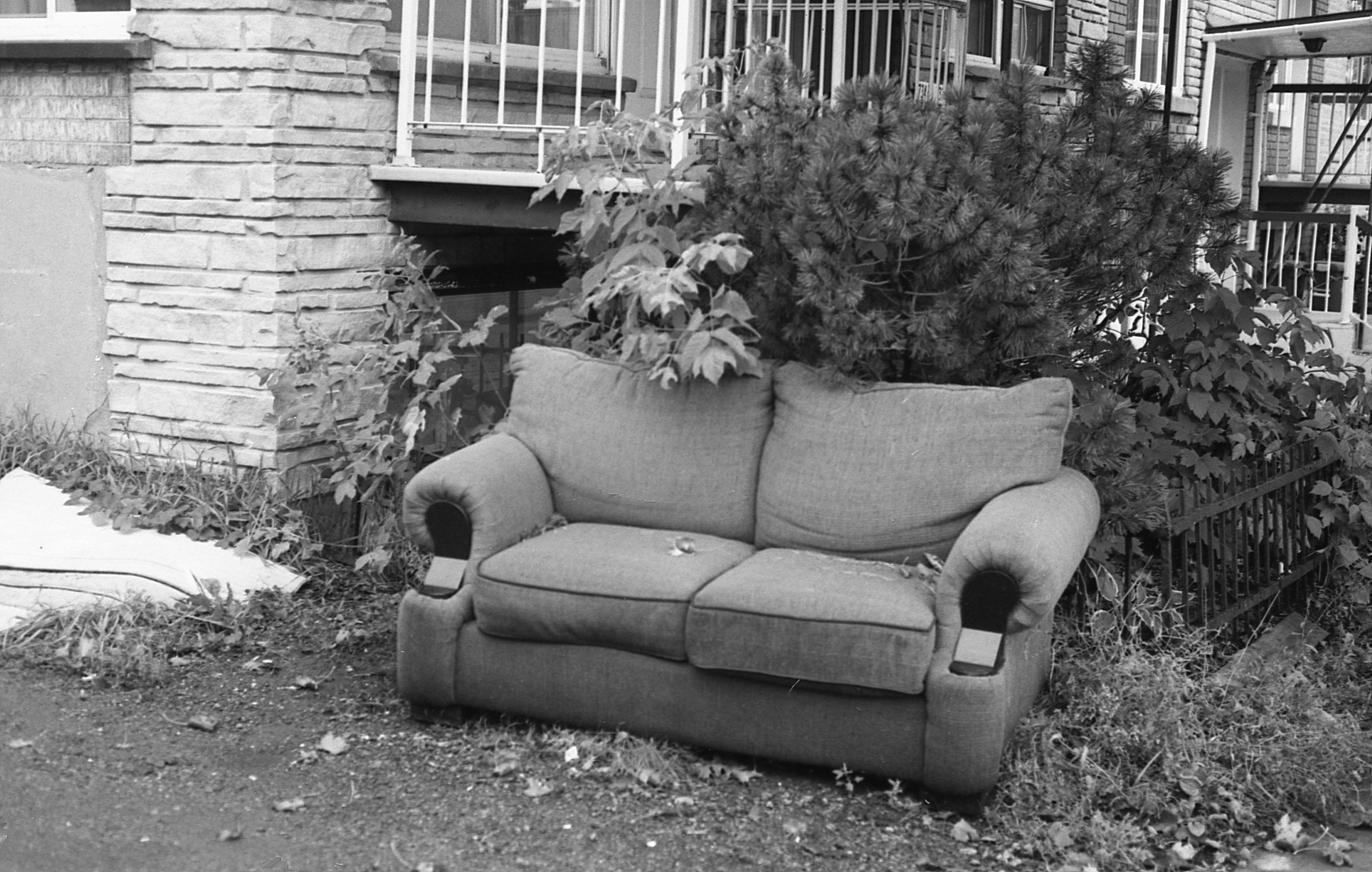

An interesting film, all in all. I prefer it in low to medium contrast situations, but with good range of tonalities — the phone booth is a good example, shot in pretty low light ; the sofa pick is also shows a nice range of tonalities.

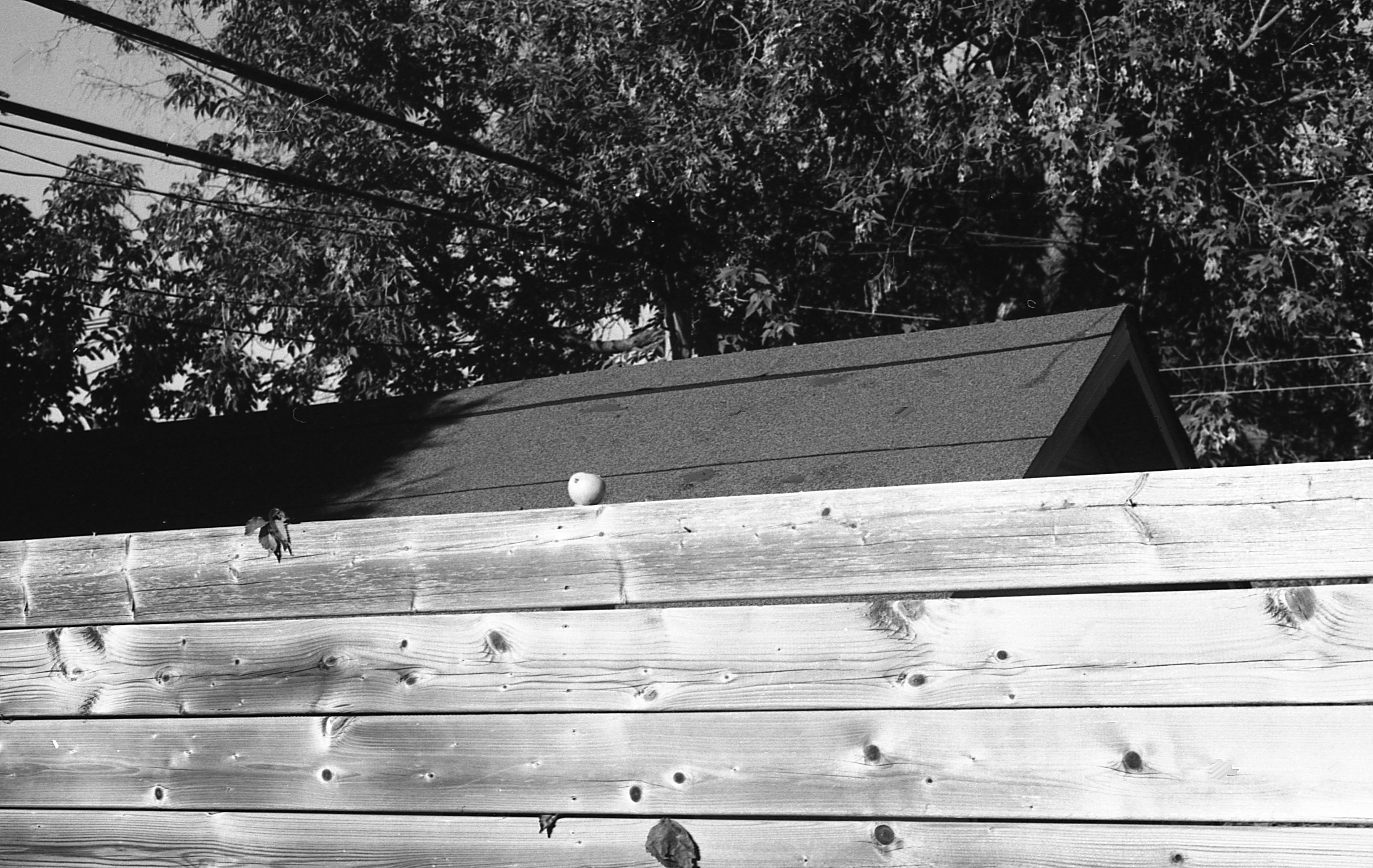

Works fine for street at 200 ISO. Not very forgiving in terms of exposure, though — I did bracket a lot, and my general feeling is you better be right on. One stop too high or one stop too low doesn't seem to give you much room to work on (but then, haven't been in the darkroom with these, so it's more of a feeling than actual experience). High contrast, if not careful, you risk blown highlights if you don't meter perfectly — see post #759: did not have my spot meter, and it was a tough scene to meter with an incident meter ; could have went down a stop, but I would have lost the little detail I had on the wood in the shadows. This said, many films would have had problems with this, especially in XTOL stock ; 1:3, or D23 at 1:3 might have saved the highlights here.

Indeed, although whether or not it's a "struggle" becomes a matter of personal choice and esthetics.
House in #755 is a good example. No details in the shadows, and if I had wanted some, the front steps would have been overexposed and tough to work with. But would this be a more interesting photograph, I wouldn't mind it, because here, I do like the effect and ambiguity it brings, and it is faithful not to what I saw (the door) but to what the film saw. In other words, and to be less esoteric, it's a film I would use if I want what it can give me specifically (rather than generically, as many modern films).
