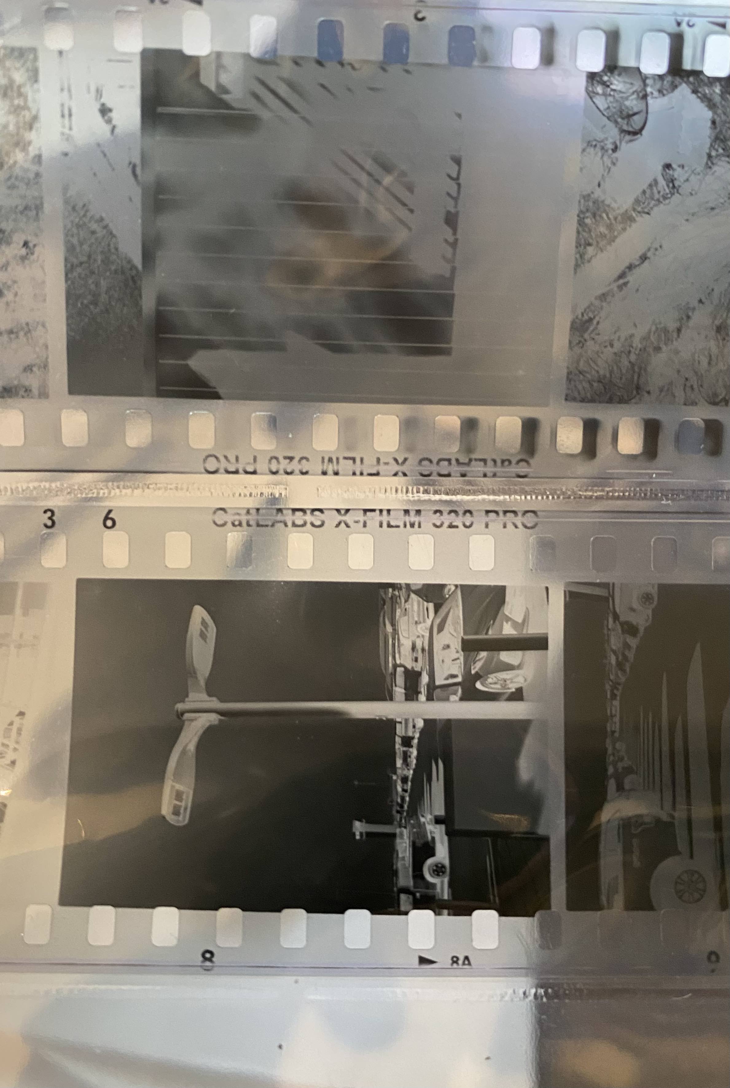

It is not Double XX. Well, it doesn't say Double-XX on the rebate.
That is why other manufacturers explicetely advise at least at such type 135 films to use a stronger shading at loading than with conventianal films and to store them in the dark (black canister).
Is there such warning by Catlabs?
Black canister. Some minor light piping. No warning that I can see.
