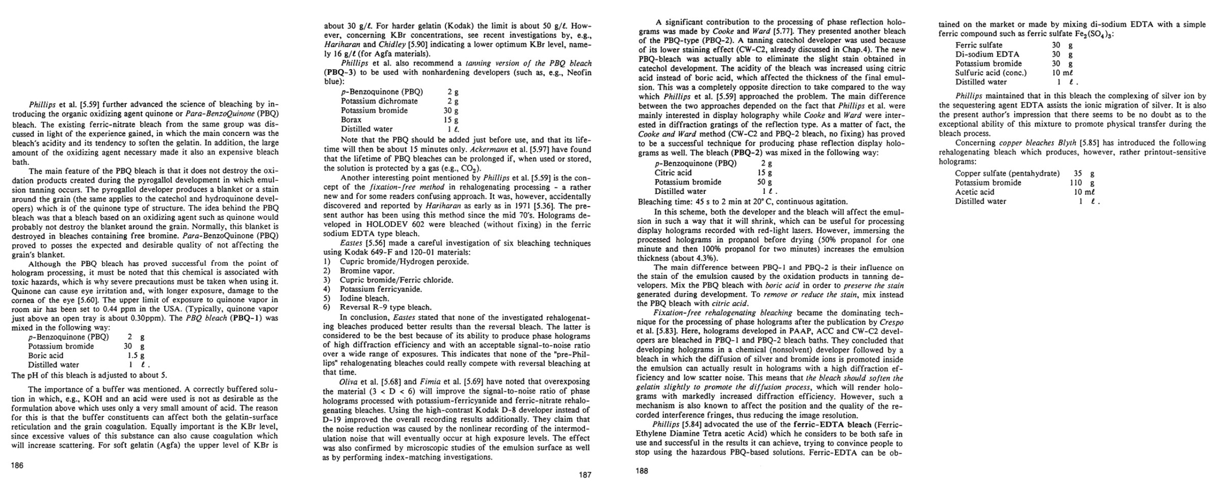

You can find a preview on Google Books that covers the relevant pages about PBQ bleaches. I've made a screenshot below of the relevant parts of the text.

Mr. Young, do you know what the best developer / bleach for phase reflection holograms (like holograms of objects) as that is what I want to process. From what the passage says, it seems that the recipes I sent will work good enough for what I want to do.

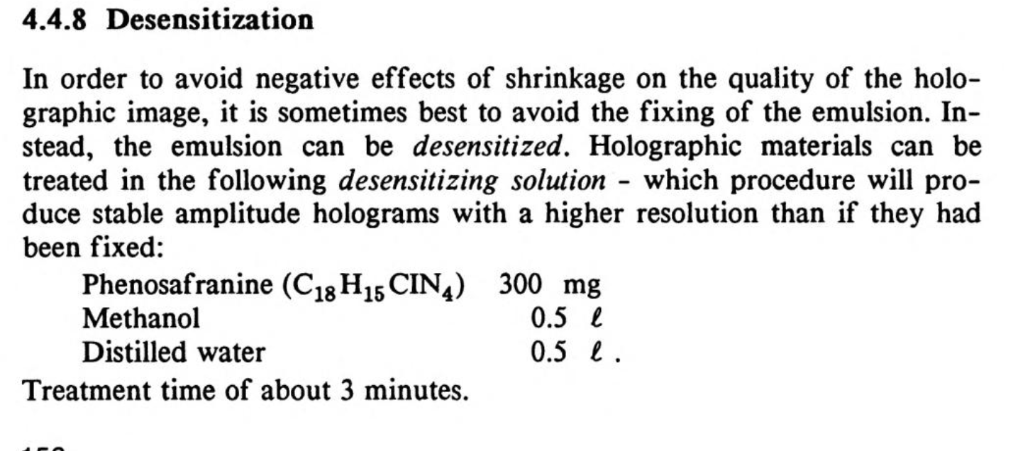

Is this what I need to do instead of fixing? I am still not sure if I need to fix the holograms or not? I read in that book preview that it would cause shrinkage
