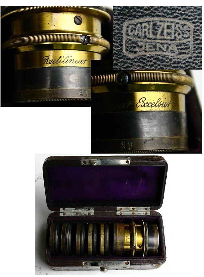

zeiss?
new casket set arrived today.
Apparently a Carl Zeiss set as it is written on the box, but no markers name on the set it self.
it sais: "reticlinear eccelsior" on the barrel.
lenses: 15- 25 - 35 - 45 - 55 - 65 - 75
anyone knows about this?
And I have no idea how to mix the lenses....:rolleyes:
but a nice looking set!
and not too expensive.

It looks very much like one of the Vade-Mecum'y Aplanat Satz sets, like the one I showed in (there was a url link here which no longer exists)

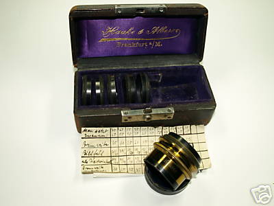

the one is called Haake & Albers with lenses from 25 to 75..

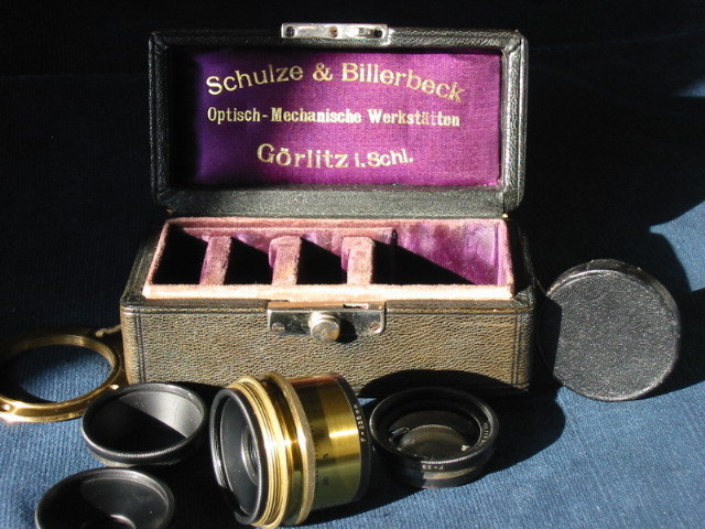

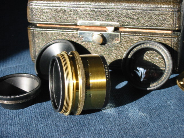

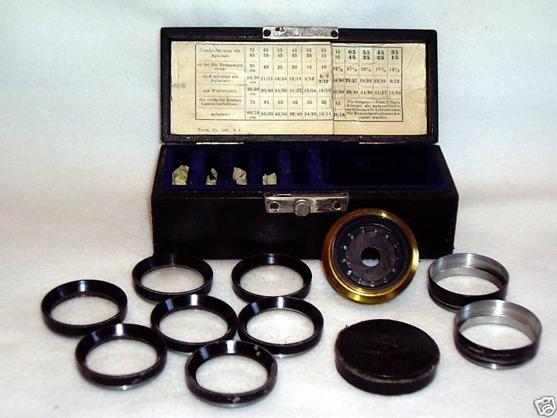

Here are some pictures of a Schulze & Billerbeck (often sold by and as Hugo Meyer) Euryplan Objektivsatz No. 2 fĂĽr 9x12cm (borrowed from the seller):

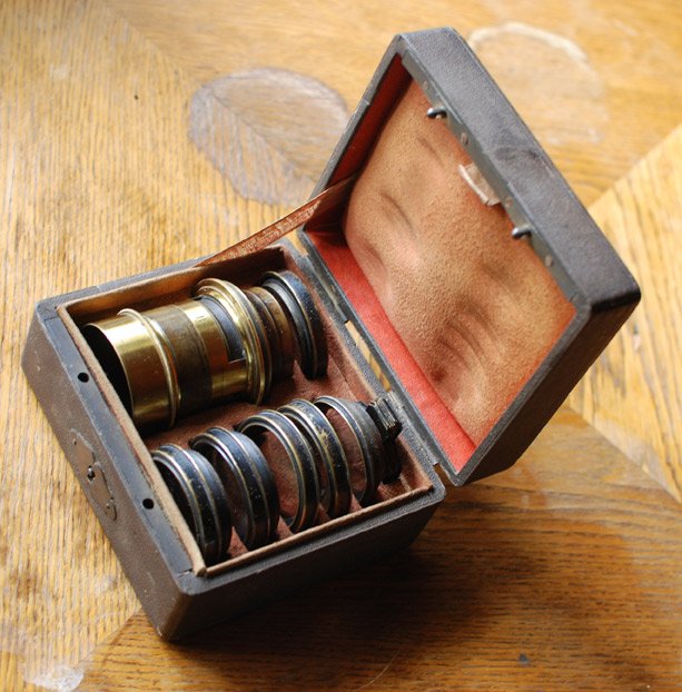

I have received a few goodies today from England. It contained a casket set in a small leather purse along with a dallmeyer + an unmarked brass lens.
Can you help me identify these small gems ?
I all 3 types of lenses
Claus
Let's start with the "easy" one: The "unknown" is most likely a Rapid Rectilinear, and is probably British or French from the aperture steps. "22" and "44" is unlikely to be German, they would either use "22" and "45" or "23" and "45". Or Stolze. British manufacturers were more likely to use the infamous "AU" (Arbitrary Units", which is why I include France as a possible origin. Focal length is then likely to be around 9½" or 240mm.
The Dallmeyer? No idea really, especially not when I'm at work in the North Sea without a lens library. F:10 is similar to what many landscape lenses have, but this doesn't look like a landscape lens. Could it be a Periskop? Or an "unnamed Rectilinear"? I think the "UR" is most likely. :wink:
Then the casket set:
I assume that the "6", "14", and two times "20" comes from markings on the cells?
If so, I think that would have to be the focal length in inches: Most metric sets only go down to 150mm (or 15cm), since anything shorter than that won't be useable in combination with another cell. Since 150mm is about 6", it makes sense that it's a 6" cell.
a 14" front and a 6" rear would give about 4.2" combined focal length, quite within the useable range for an "uncorrected" wide angle Rectilinear. 14" rear and 20" front ends up at 8.2", again quite a useful focal length. And of course 2x20" is 10"; quite within the capabilities of most small cameras.
That 17mm thingy - does that consist of two short empty tubes? If so that's a spacer set, to be used in the "normal" configuration, and removed when extra wide coverage is needed. One goes on front of the barrel, the other one on the rear.
Given the markings in inches, a British maker is again most likely.

Yes it has a name - forgot to mention
Primus No. 1
// Ole - the 17mm thingy does contain of two tubes. most likely the inner is approx 7mm and the outer is 10mm
does this make sense
claus

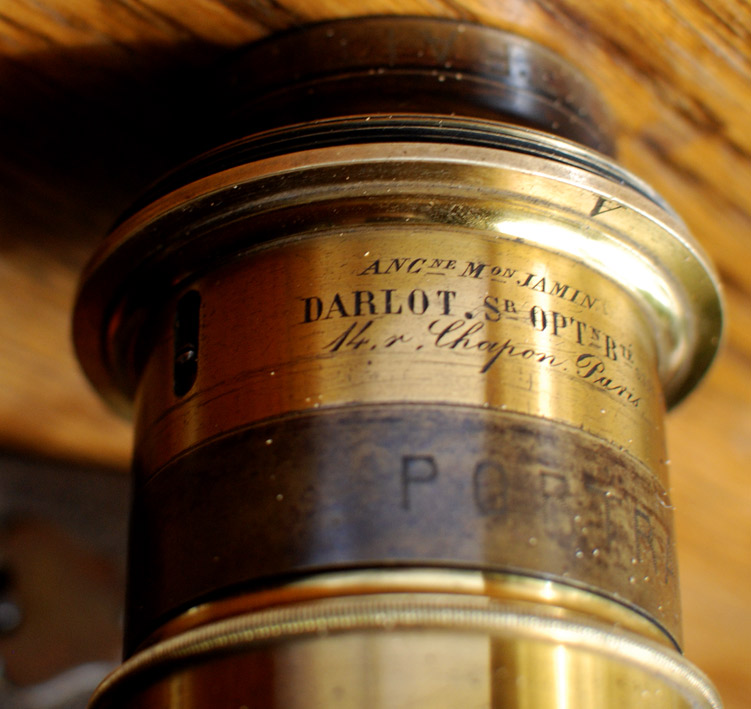

Darlot/Jamin casket
:smile:

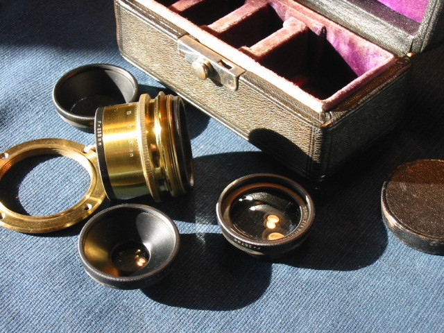

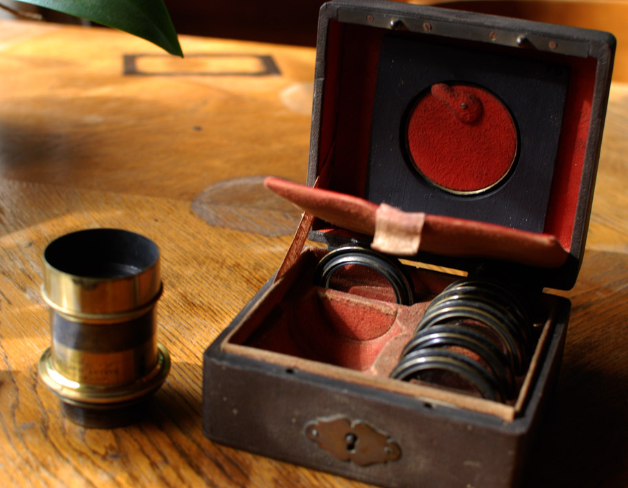

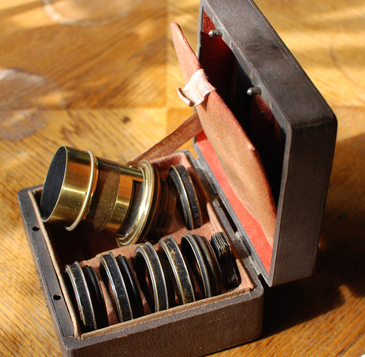

just got one...
But I don't know anything about it. The VM doesn't mention a lot (just "several"), and the one description is dated much later than this one must be, as the Jamin name is written on it.
Original case - "secret" compartment in the lid where the original flange and a front plate was hiding..
beautiful condition.
Compleate as I can tell.
on the lens is written "B" and "PORTRAIT" - on the base of the barrel it says "A".
I am almost sure the Portrait "mode" is a petzval...
6 extra lenses to combine - 8 waterhouse stops.
Anybody know about this kind of set?

Wow! That's the sweetest casket set I've ever seen bar none! Does the piece that says portrait effectively lengthen the barrel, ie. when it's in Portrait (petzval) mode, it has that piece to make the barrel longer, and when it's in regular mode with some of the aplanat components, the barrel is shorter?
hi Jim.
yes, I think so, but I have to check it closer... I'll get back asap..
