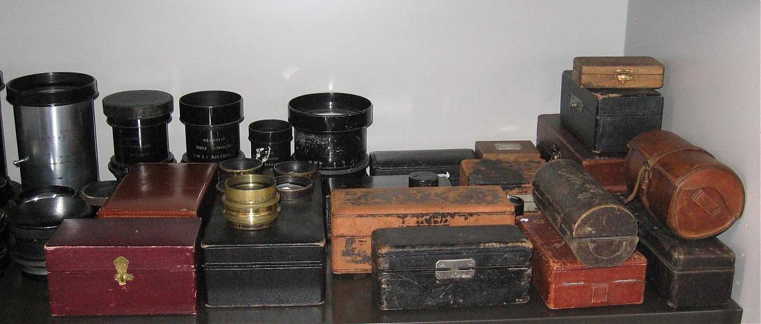

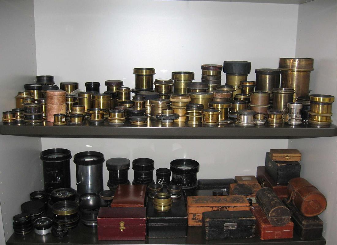

I have a very heavy brass addiction.(see Scrigno n.1)
It started many years ago with the curiosity to see how the oldies lenses for LF I saw around me could perform.
This the first part of the addiction (home collection) and the last part (office) will be, if someone is still interesting (too much is too much) next week. I tested most of the lenses I have in a undity way, for some I recorded the datas for others impressions, results sleep in some shelves.

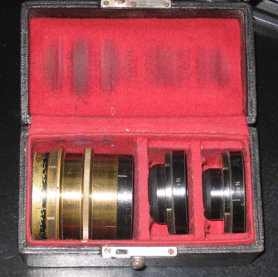

I have a soft spot for casket sets (see Scrigno n.2) and some I collect are really bizzare like a Meyer for stereo camera or a Schulze und Billerbeck Euryplan.
Some are very similar and belong to Vademecum family, others are not so usual.
In the next days I will send photos and comments on them.

Here are pics of my one casket set that is incomplete. I hope someone will have the complete set and be able to tell me about it. It is a bayonet style and someone has fashioned the copper barrel so it can be used with no aperture. Present are #1, #3, #4BIS? #5, & #7. #2 and #6 obviously with the original barrel and aperture where ever it has gone. Does anyone know what this is?
Jim,
I saw a very similar casket set: it was a Darlot and it belong to a friend of mine.
It had the same casket with red spacers and elements (cells and numbers on them) are the same of yours and I took with it some color pictures in 8x10 some years ago.
It had a very interesting set of cells, some are only for the back and they are divide to be use as wide angle (grand angulaire) the other as normal or semi-tele. The coverage is not so huge and back cells used single are really soft focus. The apertures are waterhouse stop.
I will ask to my friend to send me a photo to confirm my memory
Jim,
Thanks! Very helpful and interesting. Yes, the knurling and construction looks like something from Darlot. Do you know what 'Bis' was short for on the #4? Best, Jim
I think I have some orphaned Darlot cells somewhere! If I remember correctly, two of them are marked "pays" and one "bis". will look for them tomorrow.

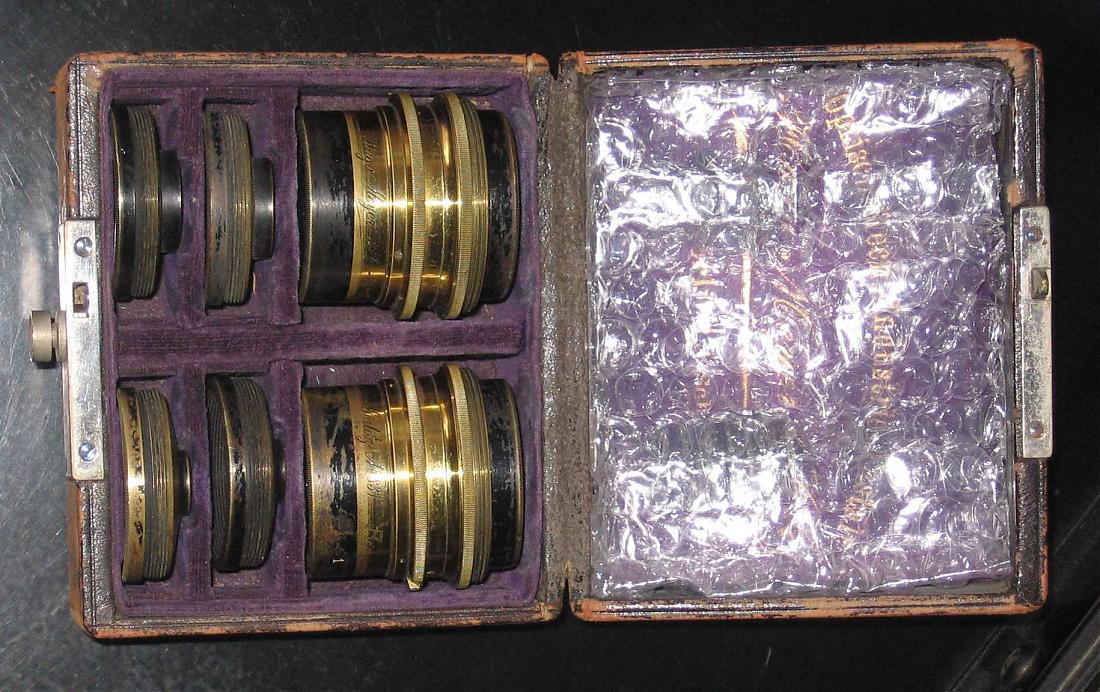

Speaking of double here there is the Meyer Stereo casket set.
Manufacturer is Hugo Meyer & Co - Gorlitz n.831
It is composed of: two same barrells with the number aperture sistem, very common in the casket sets of beginning of last Century.
The cells are four for every barrell:
1=43 cm.
2=35 cm.
3=22 cm.
4=15 cm.
It is an Aplanat or rectilinear and there is no instructions in it.
Someone had inscribed roughly on one barrell R, on the other L, this is a clear statement it was used, probably in England, on a stereo camera.
Never used with film only see its performances on the ground glass. It is in the wave of the Meyer Universal casket sets.
Meyer casket set story will continue.......

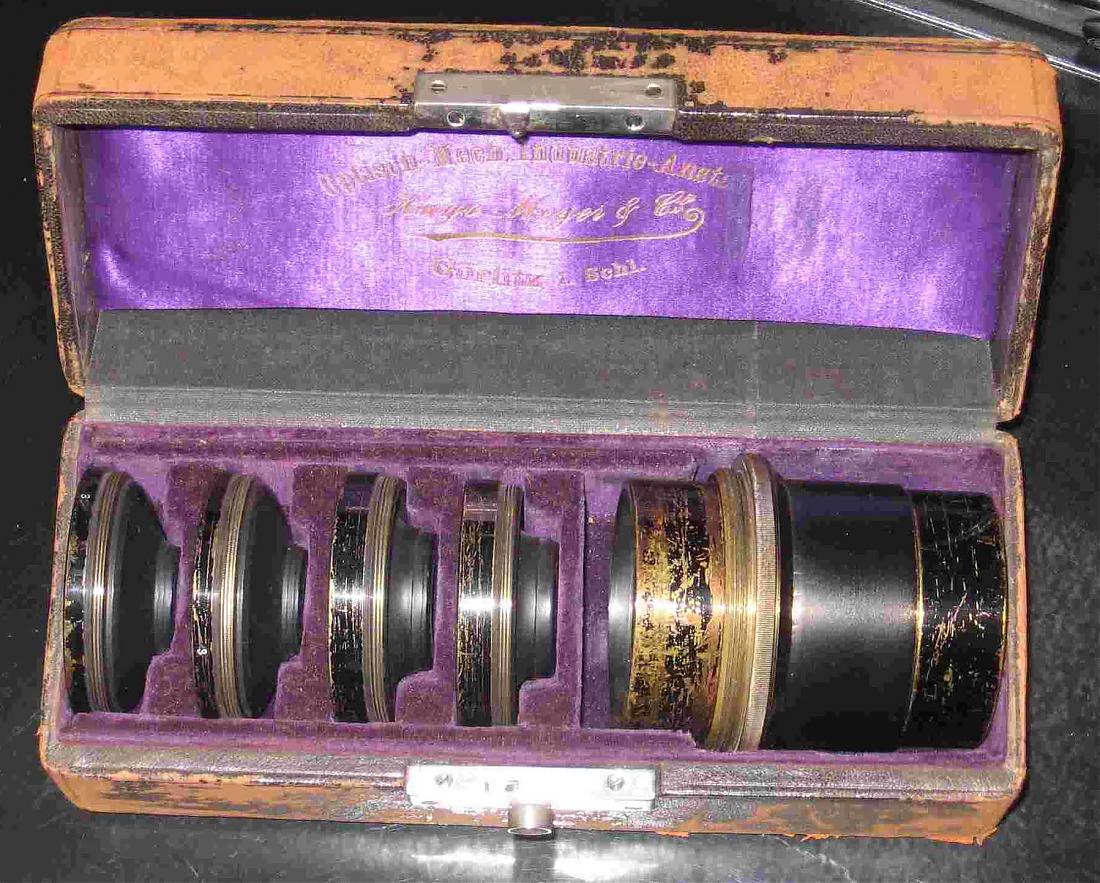

HUGO MEYER Satz Rapid Group Aristoskop
Manufacturer is Hugo Meyer & Co - Gorlitz no number, neither incription on the barrell.
I determinated the origin by measuring the aperture wide open and it is f 5,5 and the design of the lenses, symmetrical aplanatic construction, is the same of Aristsoskop. For this purpose I have consulted an old Meyer catalogue.
It is composed of barrell with one washer stop, I had have made the others to test the casket set.
The cells are six, two for every focal length:
1=50 cm.
2=40 cm.
3=30 cm.
Combined cells with coverage in centimeters
50 ¦ 50 ¦ | 26 ¦ 13x18
50 ¦ 40 ¦ | 23 ¦ 13x18
40 ¦ 40 ¦ | 21 ¦ 13x18
40 ¦ 30 ¦ | 18 ¦ 10x12
30 ¦ 30 ¦ | 16 ¦ 10x12
Coverage single cell
50 ¦ 30x40 ¦
40 ¦ 24x30 ¦
30 ¦ 20x25
It is an Aplanat or rectilinear with a medium/small coverage around 60 degrees and it was used mainly for portraits and groups as catalogue said.
Images on the ground glass wide open are very portraitist-style, plastic and soft in the same time, close down it became more sharp.
Photo will arrive very soon
Here there is the photo of the Aristoskop Rapid Group Satz, it was a long battle, but somenthing was wrong with the computer, maybe the name of the casket:smile:
Brian the adoption is open, get a ticket to Verona-Italia and you will have the opportunity to test every "brass addiction" you want.....naturally with moderation not to induce dependence

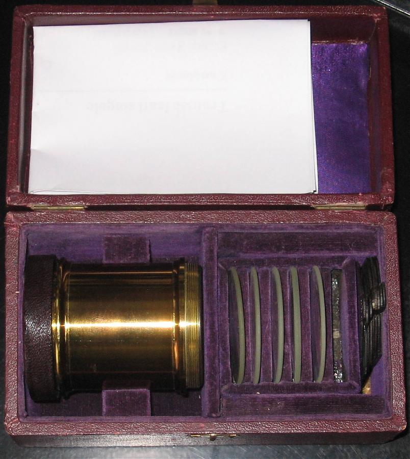

That's right Brian here I'm and to improve the dependence I introduce you the most simple casket set I saw and used.
No name or indications, it seems a French manufacturer but it is only an assumption.
It is composed of the following sigle lenses: 60, 48, 40, 30, 25, 20 centimeters.
The focal length is roughly script on the edge of the lens.
They get in position on the barrell with two very large washer stops.
The combinations are these:
60 ¦ 48 ¦ | 26.5 ¦
60 ¦ 40 ¦ | 24 ¦
48 ¦ 40 ¦ | 22 ¦
48 ¦ 30 ¦ | 18.5 ¦
40 ¦ 30 ¦ | 17 ¦
40 ¦ 25 ¦ | 15 ¦
30 ¦ 25 ¦ | 13.5¦
30 ¦ 20 ¦ | 12 ¦
25 ¦ 20 ¦ | 11 ¦
There are waterhouse stops as follows: f25 f20 f15 f10 f5 f2 and the place for the waterhouse is very near to the front lens.
Results wide open, with a combination, are very similar to an Holga lens, very small focus in the centre of the image and a complete out of focus for the rest 35% focus and a big amount of blur. This for 4x5 format and medium combinations of lenses.
With small apertures the focus increase until 55-60% and with long combinations it cover barely.
Single lenses are usable but with more or less the same results of the combinations.
I put it in front of a Copal 3 with adapter ring in a 8x10 camera and it is weird!
I will post some 4x5 photos as soon as I print them, for 8x10 you have to wait until Christmas.
There's nothing more "basic" than that, that's for sure!
Are the individual lenses meniscii, or biconvex? It's a bit hard to tell from the picture...
If they are meniscii, the usable angle of view with two lenses should be around 40 degrees at f:32, according to my own Voigtländer W.Z. But then again that one was made as a soft-focus enlarger lens; I have no experience with using meniscii (or Periskops) for photography.
Pardon me.
They are slightly biconvex, very light weight.
The place of the stops, very near of the front lens could also be used with a single lens in the back for portrait, as in the Bausch & Lomb Plastigmat Portrait, even if I doubt this casket set was for portraiture.
It seems to be used for very small format, maximum 9x12 centimeters.
