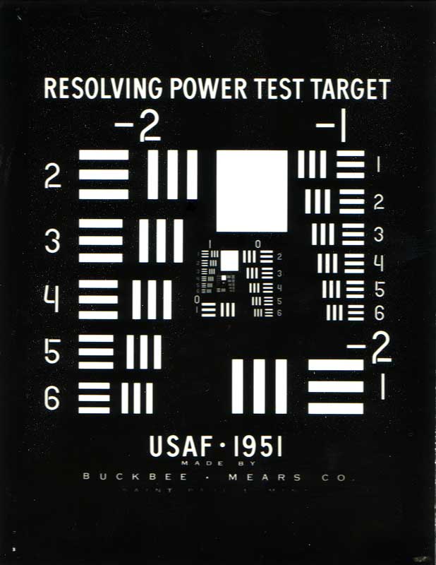

I need to do some more "official" testing. aside from photographing actual test targets in a controlled environment, what do people generally hold as a good test subject for a lens? City scape in varied lighting? It's cloudy and a bit gusty here this weekend. I think portraiture is way too subjective.
On an overcast day, I think all I could really get is a good idea of coverage and resolution. I would need some sun to start testing for flare and other light related artifacts I think.
