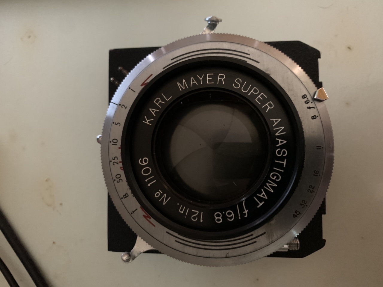

I impulse purchased a lens today: Karl Mayer super anastigmat 12" f6.8 in an Alphax shutter (almost as big as a technika lensboard, 1-50 plus T and B) I'm pretty sure that makes it a #4 It has the M-X switch, and the bi-post sync pins.
I did some googling, and I was continually bounced back to the "Carl Meyer" spelling. I got on the Butkus site and sure enough, "Carl Meyer" is all over within the Burke and James catalogues. So, what gives with the alternate spelling?
It's a heavy little bugger.
If it's coated (I couldn't tell for sure) it's only single. The glass is in great shape, and the shutter seems to be in good order as well.
I'll dig around a bit more on the web but in the meantime, does anyone know anything about these?
Can you post a photo of the bezel of the front cell so we can see just how it looks?

Here’s a picture

With the lens sitting on my desk under fluorescent light, I see 1 subtle reflection that almost looks like it is floating above the lens, and 2 very distinct reflections further into the elements.. The biggest reflection is the "deepest" one, the middle reflection has a slight lavender hue, and the "floating" reflection simply shows a hint of the fluorescent tube.
Blue Moon camera and machine has a "Karl Mayer" 10" super anastigmat in a copal 3 that has "dagor type" in parentheses on the barrel face.

Thank you for the picture. I caught the "Karl" with a "K" in your post but missed the "Mayer" with an "a" (vs. "Meyer" with two "e's"). Maybe as JPD suggests, who ever was operating the pantograph engraver at B&J that day turned out a bunch of Karl Mayer instead of Carl Meyer lenses...

Yes. It's an Alphax shutter. I'm pretty sure it's a #4 size. (I haven't measured anything with calipers yet)
When trying to evaluate coverage (both actual and potential), should I keep applying rear movements until I can no longer see the aperture through the clipped corners? Or, focus at infinity, pull the back off of the camera, and see how large a circle is projected? (there must be a thread or 2 on this already)
OK. I can't find published data for the lens. No angle of view, etc. Trigonometry is out. I can mount the thing in my front standard and essentially remove the rest of the camera. Would this help me figure out coverage? I've read that looking through the clipped corners only gets one a rough idea.
Get lens mounted 12" away from a wall (12" focal length), shine a light through it, measure the circle? Is that a valid methodology?

Hmm. IF you want the circle at infinity, the lens' diaphragm will have to be 2 focal lengths (24") from the wall. Your procedure may measure the circle illuminated. The usual definition of coverage is the circle of good definition, whatever good definition means.
It would be better to put the lens on a camera, set shift and rise to maximum and take a picture. The subject should have fine detail in the corners. Many of the photos posted here and elsewhere have nothing in the corners. Nothing in the corners = no information about how far off axis image quality is acceptable.
The lens may be a Dagor type. If so, a single cell (remove the cell from the barrel when counting reflections) will show 2 strong and 2 weak reflections. The weak reflections can be hard to see. If it is a dialyte type, 4 strong and 0 weak. Tessar type is unlikely, but if it is one the front cell will show 4 strong, 0 weak and the rear cell will show 2 strong and 1 weak.
If an f/6.8 Dagor type, the angle covered is usually claimed to be 85 degrees. If a dialyte, 45 degrees. If a slow Tessar type 60 degrees.
