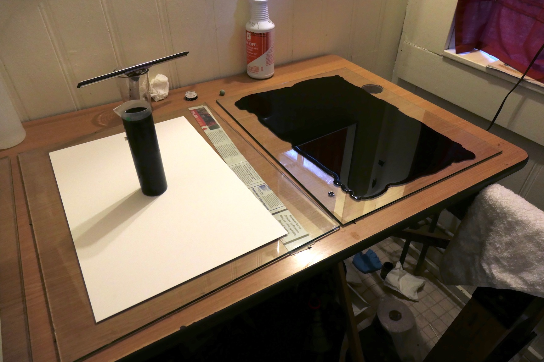

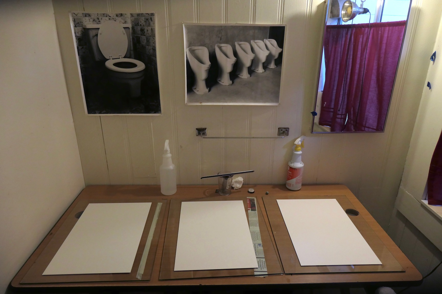

Now I tend to coat 12.5"x19" sheets of Yupo (86 wt). Then I cut it down to the sizes I need (I print 4x5 to 11x14). Pouring big tissues just saves time. If I sensitize a whole sheet, then cut six 6x8 tissues from that sheet, all six tissues will be identical. I have 14x17 xray film I can also fix-out, but I cannot get two tissues for 8x10 out of it. The size of one of my batches of glop (about 850ml) is just enough for three 12.5x19 sheets of Yupo...which is the number I have room for at one time.

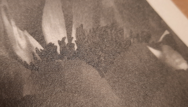

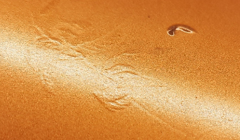

Here's a small snippet from the relief on a drying DAS print after the second transfer; at this stage, the relief is already virtually gone, but it's still a bit visible:
In the dried print, it's totally gone; here's a section of a nearly identical print, but after drying:
This is photographed at an angle (hence the odd contrast, which is due to the paper texture) and as you can see, there's absolutely zero relief.

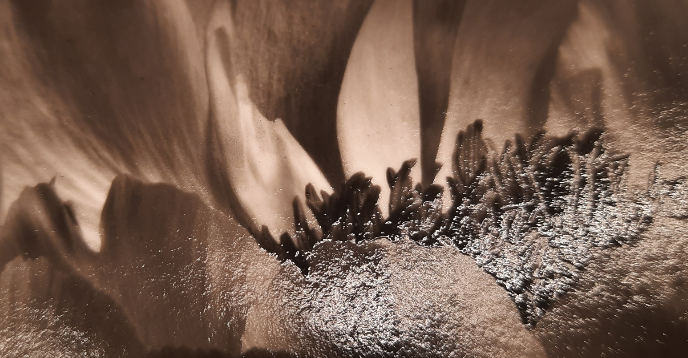

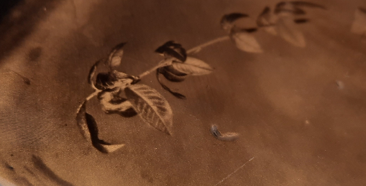

In principle the relief is there alright with DAS; it's just masked by the double transfer process. Here's a small section of DAS carbon on glass, backed with another gelatin layer with gold print to make a kind of orotone; this is looking at the front of the glass:
The back of the plate where the image actually is (with the gold layer on top of it) still shows the relief of the image:
