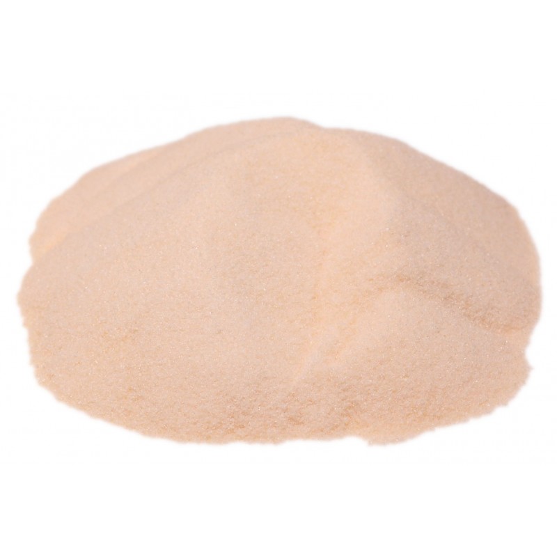

Gelatin: I've looked through a lot of product data. I cannot find a "bloom rating" on any of the food service brands of gelatin. The only "rated" gelatins I have found are those sold by photographer's formulary and Blick. What gives?
Has anyone seen a "Bloom rating" for good old Knox gelatin? I will likely buy it on Amazon, as I don't have any local groceries that stock gelatin in anything other than the Knox 1 ounce envelopes.
I used to use Knox unflavored gelatin from Walmart in the big box, it works well but depending on who you purchase from is pricy. I buy bulk from Artcraft Chemical current price is $17.29/lb plus shipping. I wait til I need other chemicals and order all at one time to make shipping easier on my wallet.

I get gelatin fro a bulk food store not too far from me. I'm sure it's no different than Knox gelatin... 🤔 I've been using it for years, and quite happy.

I buy food grade gelatin online from Bulk Foods in 5 pound packages. Last time I bought it, it was about $5/lb but that was awhile back. I see that it has doubled in price since Covid hit.
Still cheap at twice the price.

Thank you. I think I got hung up on specifications once again. It's good to know what the "standard" Knox gelatin is rated for.
I did find a few packages that are clearly marketed towards commercial baking that had specific bloom right on the package, but they were really expensive.
Yes Vaugh, $10 per pound seems to be really cheap comparatively. The one I was leaning towards was $18.50 for 1.5 pounds.

That's pretty much on par with what I pay here for a comparable bovine food-grade 240 bloom gelatin. It's currently close to €15/lb if purchased in a 1.5kg tub: https://www.naturalspices.com/gelatin-240-bloom This gelatin prints fine with both dichromate and DAS. Its only downside is that it's somewhat yellow and therefore a little less suitable for color work and (heavy) sizing. Otherwise it's quite nice - and it certainly smells a lot better than the more colorless Gelita porcine photo grade gelatin I use for most of my printing these days.

@MTGseattle there's quite a bit of experimentation going on in the pigment printing arena, with people trying other sensitizers besides dichromate and DAS, and also plant proteins instead of gelatin or gum.
Keep in mind that the reason why gelatin works in carbon printing is because of the long-strain molecules that get entangled and linked up ('crosslinking') by the use of e.g. dichromate or DAS. Polysaccharides like gum arabic and agar agar behave differently; they sometimes exhibit somewhat similar behavior (at least superficially). See e.g. gum printing, where gum arabic is hardened with gelatin. However, the chemistry is different and the mechanics of producing a print, too; e.g. with gum printing there's no 'transfer' as such and I don't think it would actually work if you tried.
Agar agar does play a small role in the Chiba system that uses ferric ammonium citrate as a sensitizer. Here, the agar agar isn't the actual binder for the pigment, but it seals off the gelatin matrix so that oxygen doesn't create problems with the hardening and subsequent adhesion of the gelatin to a substrate. I've read recent reports from one printer who does away with the agar agar and simply uses gelatin and FAC. I've tested this too about a year ago but the results were problematic; no transfer seemed to be possible. However, in these cases gelatin is still used as the pigment binding medium.
The alternative plant proteins are so far mostly/only used in direct printing process, so processes without a transfer, like gum bichromate. I've seen reports of lupin proteins in particular being successfully used in a brush-on method, using FAC as a sensitizer. While such prints are also pigment prints and they also employ proteins, the printing mechanics are quite different from carbon transfer as we know it, and the results are, too.
The short answer is that so far I've not seen a drop-in replacement for animal gelatin in actual carbon transfer printing. If you broaden the scope to pigment processes, then there certainly are other options out there.

I use both bovine and porcine gelatins and apart from the smell, I notice no particular difference in the sense that one is more difficult to print with than the other. It really doesn't matter.

Yes, and I did not care for it. Expensive and had issues with it setting, even at room temperature. I'll stick with animal gelatin. I like the smell of road kill. 😁
