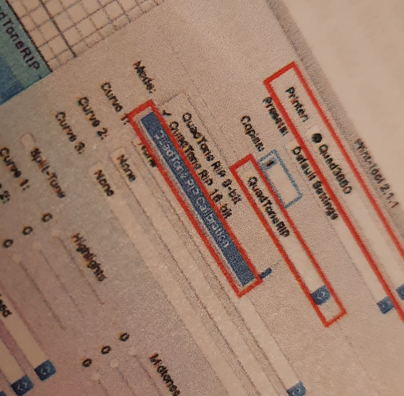

This is a sample of the print quality on one of the illustrations on calibration:
The smaller text in the illustrations is virtually unreadable.
