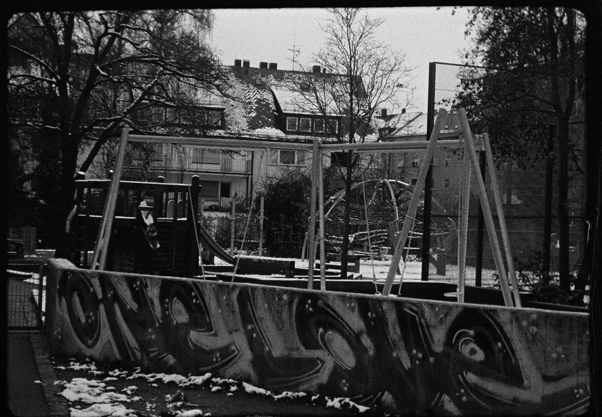

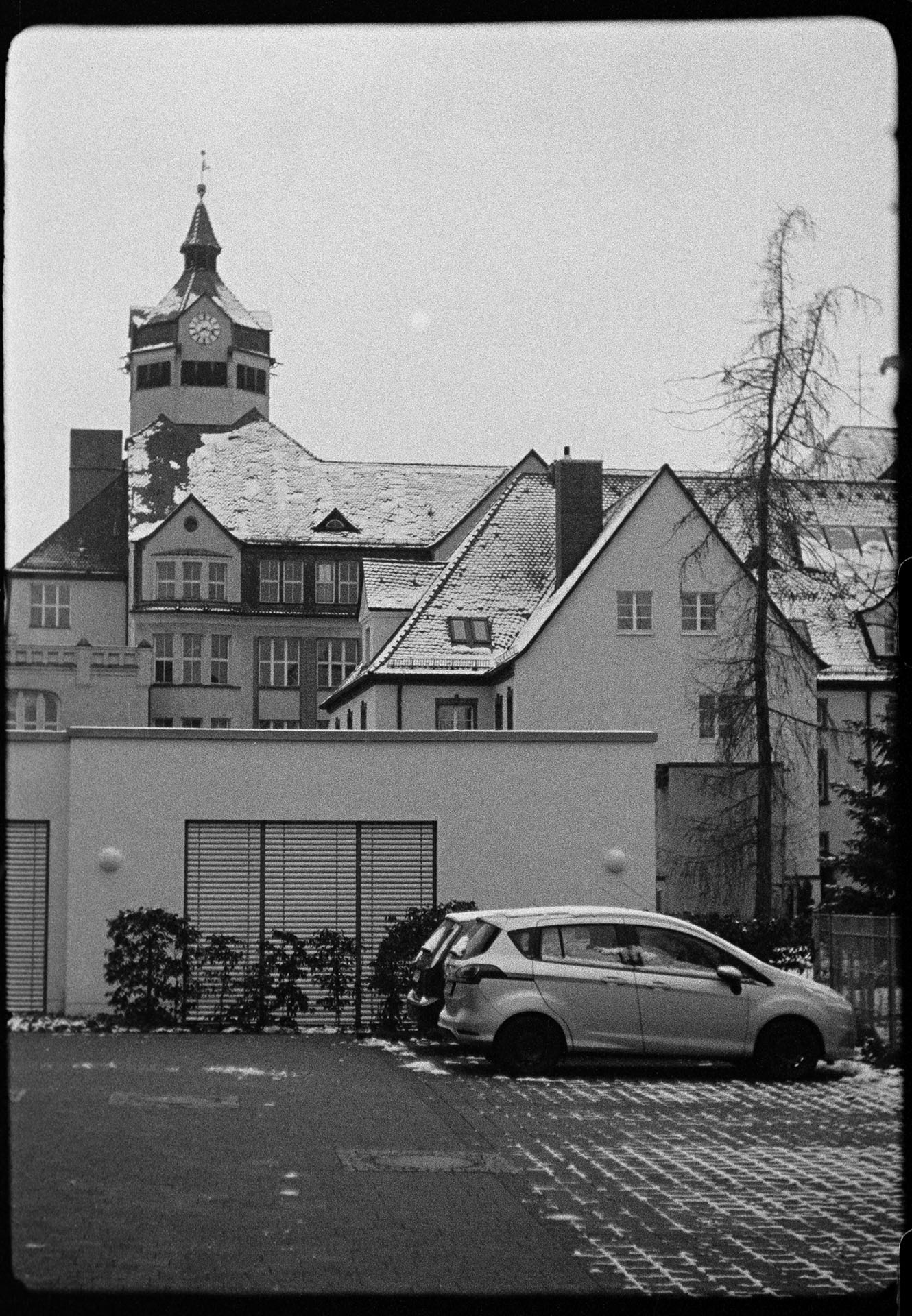

Shot of Kodak Double-X in Mamiya 16 Automatic.
Development:
1. Rinse film with tap water (20°C)
2. Develop with Ilford Perceptol (20°C) for 7min (10s/min)
3. Rinse film with tap water (20°C)
4. Fixing (20°C) for 10min (10s/min)
5. Rinse
6. Wash with tap water + Adox Adoflo II
I mean just look at the pictures! No grain overload! They are a little bit underexposed but even increasing the brightness in Lightroom doesn't increase the grain too much.
As far as I know Ilford Perceptol is the finest grain developer there is? I could not get my hand on D-76 or Xtol so I thought Perceptol is the next best option.
This even shows how sharp the Mamiya 16 lens really is!
