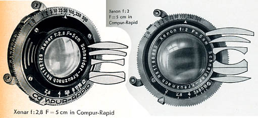

It seems that in the mid-50's all Xenars slower than f3 were of the Tessar type and the ones faster than f3 of the 5-lens type (with an additional meniscus between the two front lenses).

I am getting confused, AgX. When I refer to a Xenar in this context, I am referring to the lens installed on Rolleiflexes and Rolleicords. To the best of my knowledge, these were ALL 75mm, f/3.5, 4-element "ZTessar-type' lenses. Did a different style of Xenar get used on Rollei cameras?
Yes, all Xenars for the Rollei TLR's were of the four element design. 3,5/75 (and a few 4,5/75 for the late Rolleicord II).
Not really, Schneider also made four element f:2,9 and f:2,8 Xenars during the same period, so it's confusing. The five element Xenar was made in 50 and 75mm focal lenghts and the production started in 1935/36. I'm not sure if they still made them in the 1950's? The 2,8/50 Retina-Xenar from the 50's has four elements.
I was surprised when I found that the 2,8/50 Xenon on my pre-war Retina has the five element Xenar design. Even though it's uncoated it's much sharper at larger apertures than the coated post-war four element 2,8 Xenar.
The five element 2,8 Xenar and 2,0 Xenon:
The Patent:
http://www.google.com/patents/US2105799?printsec=drawing&hl=sv#v=onepage&q&f=false
