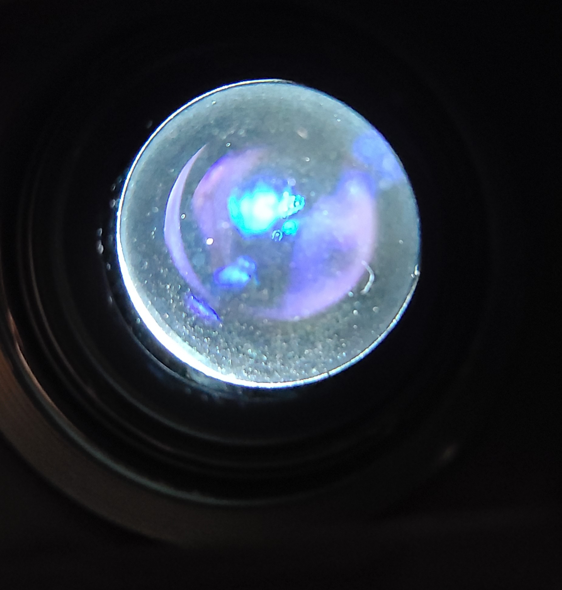

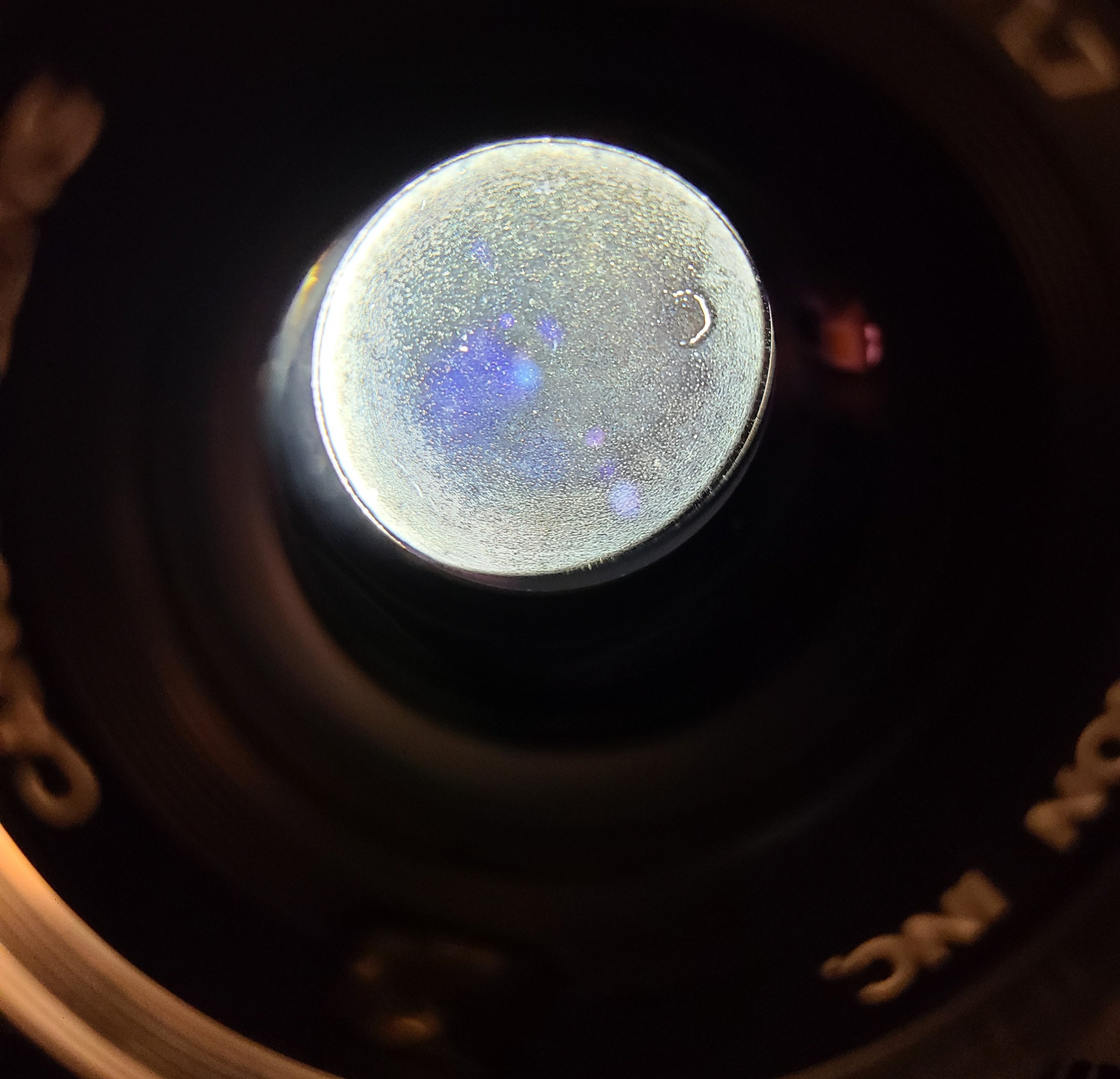

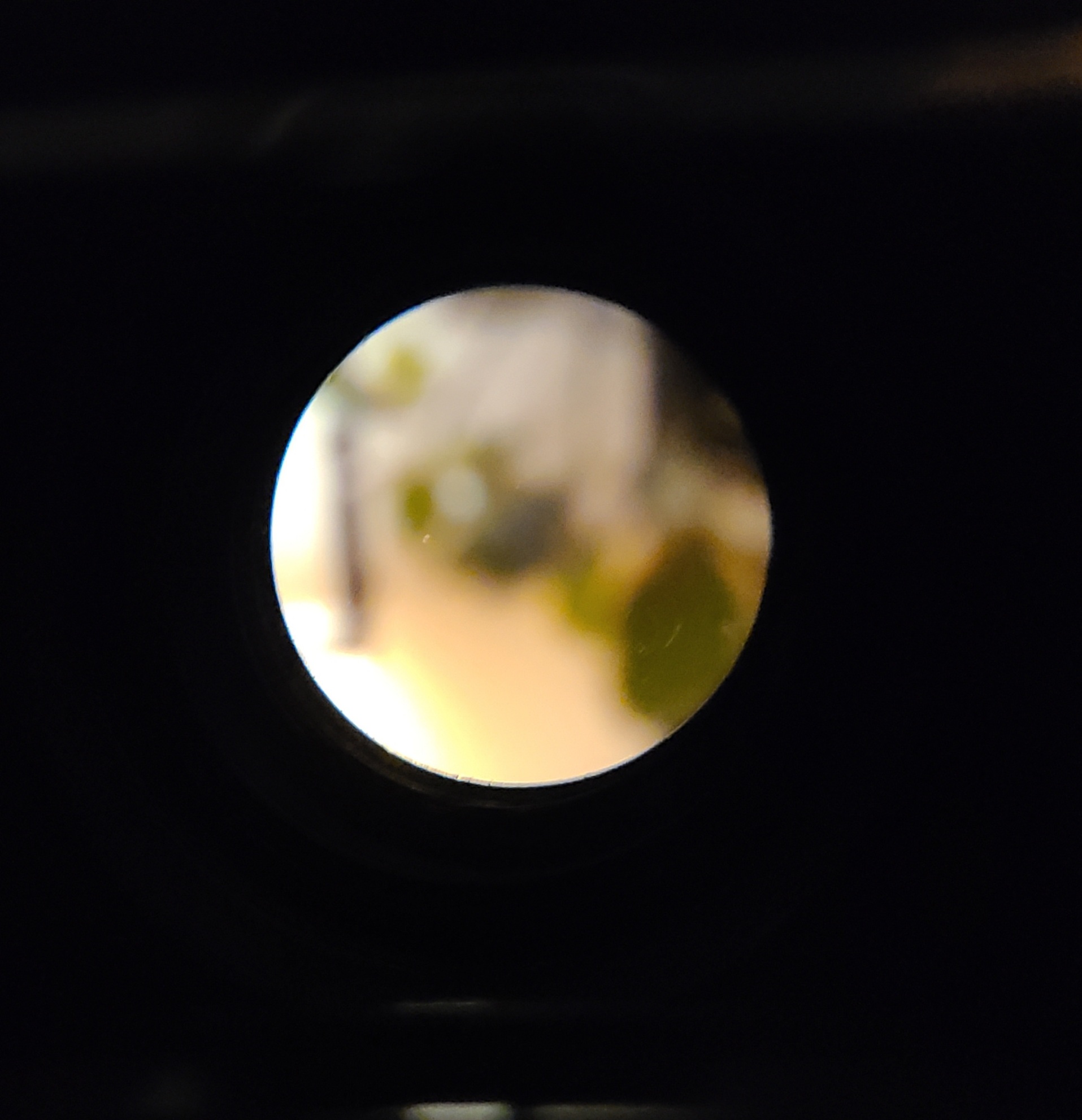

Hey just bought a canonet giii I was just wondering do you guys think it would benefit form a lens disassemble and cleaning and I was wondering is that a scratch what do you think it is ?

Is it worth or recommend taking it to get the haze/dust cleaned ? Or it won't affect picture at all. I know the flash light magnifies the problem and makes it look a lot worse but I've been told that's how you check a lens when purchasing. Now I can't stop thinking about all the fog in the lens lol.

Looking at the haze- I would try to disassemble and clean.
Have you disassembled a Canonet lens before? Do you have a spanner? Also a pair of fine needle nosed pliers helps get the first retaining ring off that holds down the name ring.

No I haven't but I have a local camera repair shop, I've taken my ae1 for a shutter squeak. Do you think that the lens can be cleaned ?

It is impossible to know until opening up the lens and getting to the surface. Most of the time, the haze cleans off. With the type of glass that Canon used: sometimes it becomes etched.

Do you think it'll affect the pictures since it really only shows up with the flashlight ?

I think it will lower contrast. I've worked on several of these, 20 or so? It's been 10 years since I opened the last one. I kept one stand-out, and it is clear.

Cleaning the glass would cost more than the camera is worth. Even when the camera was new I doubt that it's worth it to have someone disassembles and clean it.

The first one I returned bcz it had one look liked fungus and some coating issues. This one I was more picky and asked the ebay seller a lot of question ans additional pictures he sent one of the lens but with light off to the side instead of a flashlight directly behind it. But I bought it bcz it looked clear and was listed as mint. I also noticed what sounds like a shutter squeak with slower shutter speeds like 30 ans slower. If that possible for this model I had thag issue with my ae1. But yeah it was about $200 imma just ask for a refund.

The Slow Speeds will have a winding sound, it uses a clockwork mechanism- kind of like a toaster oven.
