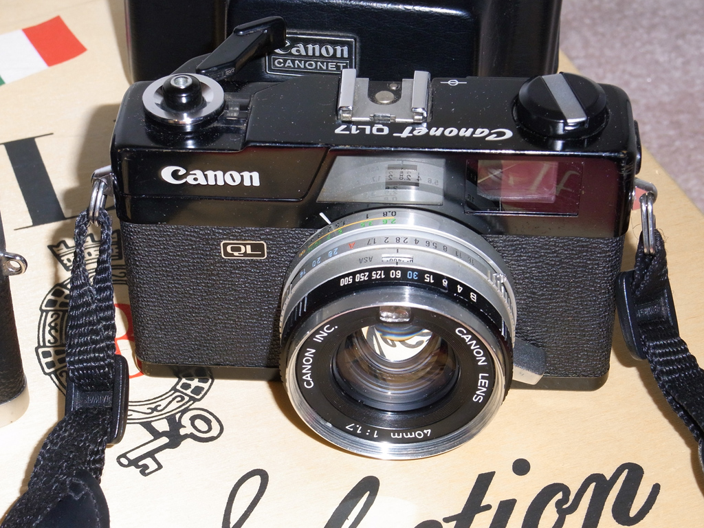

Hey I took it to my local repair shop just to make sure and within 2 hours after dropping it off they told me there was nothing to clean i also sent them the pictures I posted here ans said most like condensation bcz they aren't seeing anything to clean.

Yeah but idk I can still see the hazyness if I look with a flash light n scratch/hair in the lens. Idk about lens at all lol but still looks dirty to me Imma find someone willing to clean it, but yes everything else looks brand new.
At this point- just use this 40+ year old camera. If the repair Tech thought it not worth opening up to clean, that's because it is clean enough to use and a repair attempt might make things worse. "Been There, Done That, Regretted It, Learned that 95% is good enough". The images made through this lens will tell you what you need to know, rather than a flashlight test.

I found the attachment with my camera- mine is the Canonet QL17L, the version before the GIII came out. Some subtle differences, metal light baffle for the RF internally, uses needle for battery check instead of a lamp, and most were made in Japan.
canonet_ql17l-jpg.232729
This one- "Pick of the Litter" lens out of a dozen or so QL17l and GIII cameras that I went through. I fixed quite a few of these.
This one is a "Panda", top and bottom plates transferred froma very-dead black body, the chrome top and bottom went to fix another body.
Thankyou- The GIII is well known, many more produced than the "new Canonet Ql17" and the "Canonet QL17L". These models often get overlooked, not as many made, and was not marked as the GIII model was. I picked them up cheaper than the GIII, found the overall quality a bit better.
