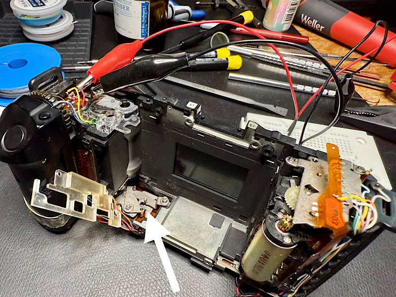

The charging motor is housed in the handle. I connected it directly to a 2-volt input voltage.
It drives the shutter charge lever and the mirror charge lever (white arrow) via a transmission. (The shutter is removed.)
The transmission is located on the left under the motor flex, which is heavily wired. I can only lift the flex partially to get to that spot. I would have to do extensive disassembly.
I decide to abandon the unit and destructively remove the flex. It's important to me to understand its function.
An eccentric (white arrow) via a lever (yellow) drives the mirror charge lever (green) and the shutter charge lever (not visible here).
The problem is that the motor isn't driving the eccentric. This means the shutter and mirror box aren't tensioned. The motor rotates, but there's no power transmission.
I can't determine the cause. So I have to give up on this T90 as well.

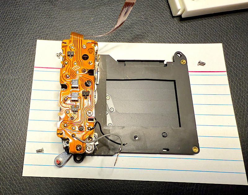

So I removed the shutter for examination.

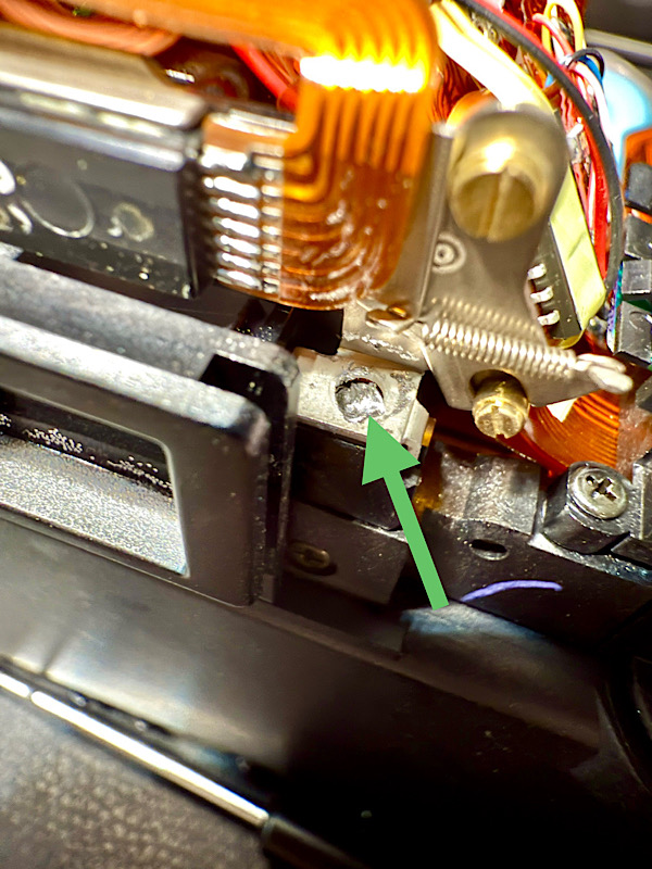

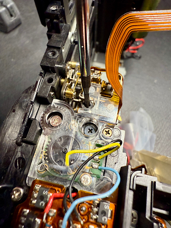

There was a screw here at the sensor unit that wouldn't come off. I could only insert the screwdriver at an angle because the rear structure was protruding. I used the diamond cutter on my Dremel to remove the screw head.
I will later substitute the screw with epoxy.

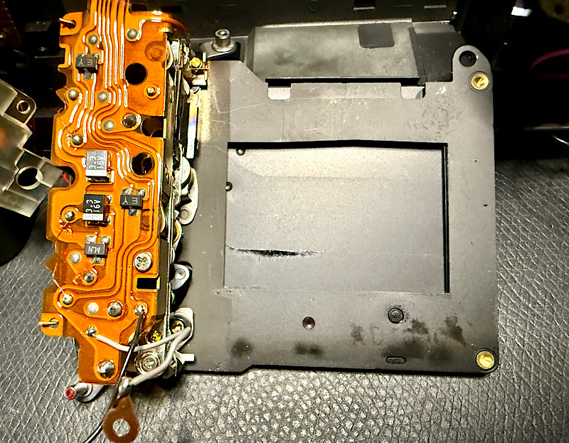

The shutter housing is glued to the rear with a seal.

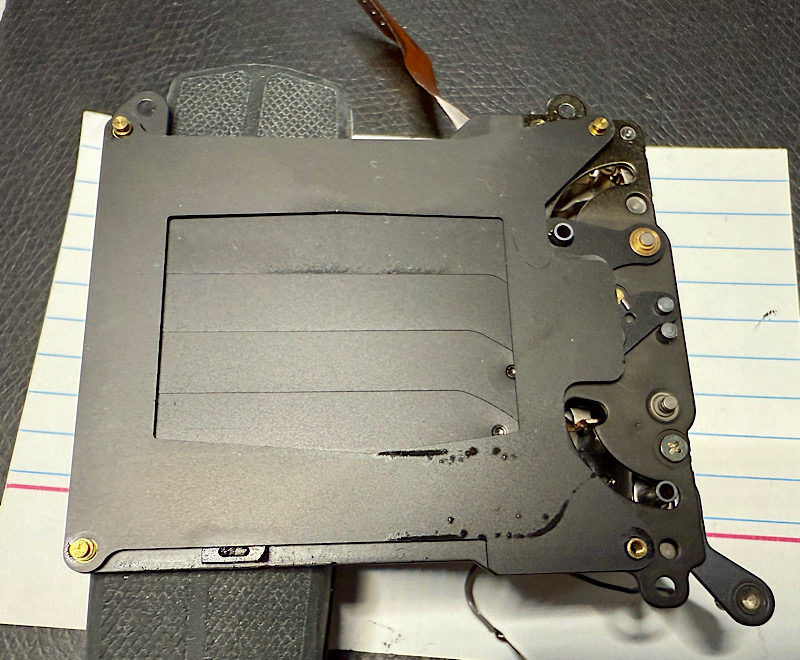

Shutter removed.
Traces of oil on shutter curtains and part of the front shutter housing.
This could be the cause of the EEE/HELP error.

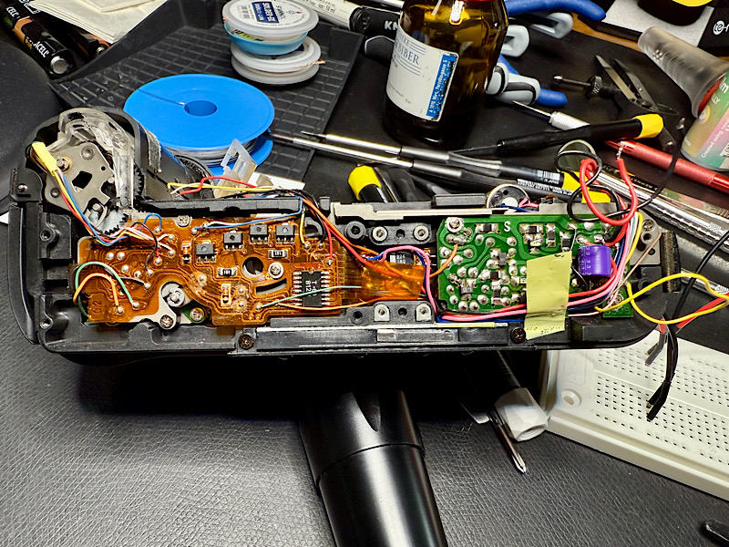

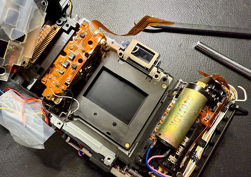

Here, in the handle, is the charge motor with its two connectors.
To connect the laboratory power supply and test the function of the clutch mechanism, the trigger unit must be removed.
The charge motor in action. Now the coupling mechanism on the camera base is also moving. Finally!

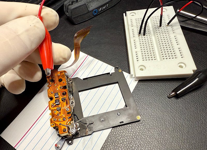

Testing the shutter mechanism, transistor TR1 and magnets
The shutter can be manually cocked and both shutter curtains released.
This is an important result, as during the previous test, the magnet of the first shutter curtain did not trigger electronically when installed.
This could indicate that the magnet is dirty, as the more oil is visible on the unit. Then the contact surfaces can stick together, even though the magnetic force is canceled out by the coil. The magnet then does not separate and the curtain does not start.
I will clean the magnets and their two associated switches.

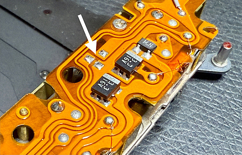

Before I open the shutter to clean it, I test transistor TR1 on the shutter control, which is also mentioned as a possible cause of the EEE/HELP error.
Since I can't test the transistor built into the circuit, I desolder it with hot air.
As an SMD component, it is soldered onto the surface of the circuit board.
To attach it to the spring hooks of my electronic component tester, I solder tinned copper wire onto the terminals as an extension.
Now the transistor can be measured automatically.
The tester displays the most important parameters.
No errors, the transistor is OK.
Soldered back into place.
Removing the shutter cover.
Some oil is visible. I don't know where it's coming from; perhaps from the shutter mechanism or the mirror box.

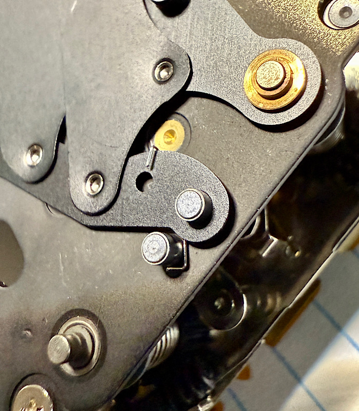

This Copal S shutter is easy to disassemble and clean.
Only one screw secures the cover, the top of two springs stays in place, no dampers need to be adjusted, the alignment of the parts is clear, and the assembly is straightforward.
The shutter is in the released state. The first curtain (opener) is compressed, the second curtain (closer) is expanded.
Spring 1/2
Oily traces on the separator.
Spring 2/2

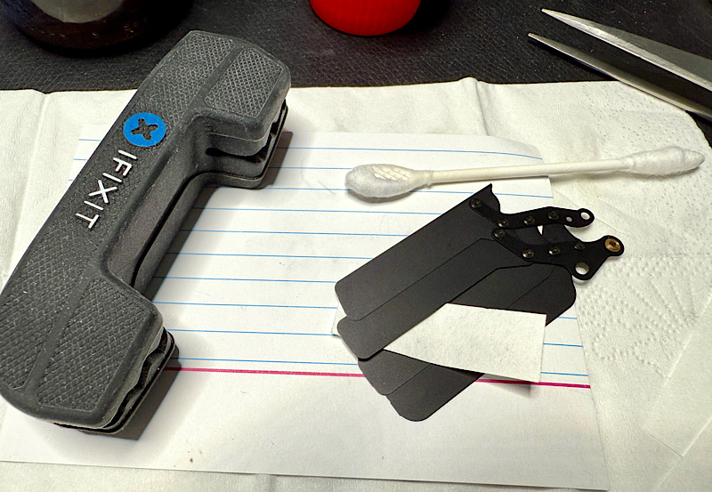

This is the cause of the contamination. The second curtain damper is decomposing; it's sticky and secreting oil that spreads inside the shutter.
This is its back, the damper for the first shutter, which is the cause of the infamous sticky shutter. This damper causes the most problems; it can be removed from the outside.
Here I can separate and remove it cleanly.
I'll leave the larger damper installed. It stabilizes the shutter, and it will be a long time before it starts secreting oil in that amount again. If any of it gets on the curtains, I'll clean it from the outside.
Overview
Cleaning with acetone and blotting paper strips.
The shutter is cleaned and reassembled.

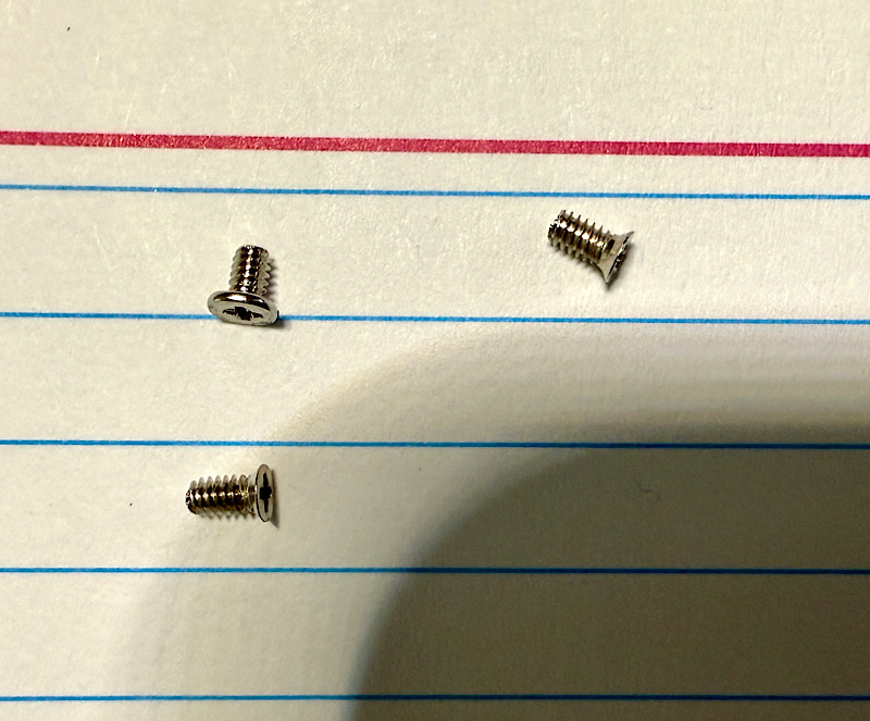

The lower shutter fastening screw was too high and blocked the charge lever. This prevented the shutter from firing.
Here you can see the marks left when the charge lever was moved over the screw. The motor provided sufficient power for cocking but the lever could no longer swing back freely. It got stuck halfway.
There are two variants. The screw on the top left has a higher head. In the lower - wrong - position, under the charge lever, it caused the blockage.
Here is the correct arrangement.

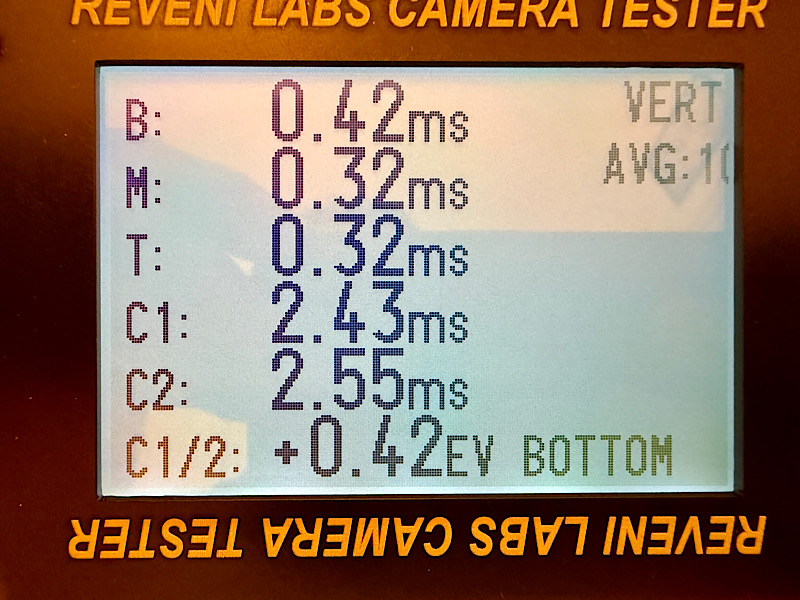

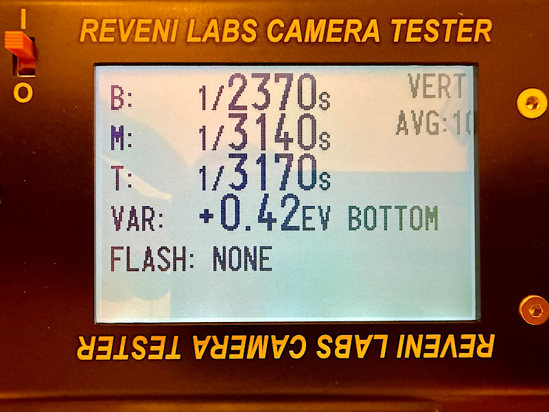

Setting the curtain travel times on the camera tester
The first shutter curtain (C1) was 3.28 milliseconds, the second curtain (C2) at 3.22 ms, at a spec of 2.7 ms for each.
This meant that the T90 produced evenly exposed images, but the shutter speeds would have been shifted toward slower. Therefore, I had to tighten the springs of both curtains.
On the T90, this is easily done using two worm screws that can be turned in either direction. Also, the shutter doesn't have to be removed for this; the two screws are accessible after partial disassembly:
once on the bottom (C1) …
and once on the top (C2).
To adjust the shutter, I mounted it in the back of the camera and connected the charge motor M2 to my lab power supply. After each shutter charge via the motor, I manually triggered the two shutter curtains on the camera tester using a probe.
After a few passes, the curtains travel times are adjusted. The spec is 2.7 ms (+/- 0.2 ms).

Results on the Reveni Labs Camera Tester
Testing the shutter at the fastest (most critical) shutter speed of 1/4000 second.
The shutter test results in summary:
Even exposure of the image, shutter speeds close to the target.
Initially, the values were bad, but the shutter obviously needed to get used to the movement again. After a few series in high-speed mode, the speeds were stable.

I just received a roll of 200 ISO film shot on a Canon T90, and it produced 18 blurred photos and six well-exposed ones. I thought I could get one of the two cameras I bought working properly, even though the message "HELP" "EEE" appears after each shot. I had read somewhere that pressing the battery check button cleared the error message, readying it for the next frame. I noticed they don't have light seals on the rear door guides, so I don't know if that's the problem. Best regards.
Andreas Thaler
Nov 19, 2017
4,863
Vienna/Austria
Hello Andreas
You can reset the camera's controls. There's an internal switch in the battery compartment that activates when you pull the battery holder out slightly. This clears the error codes EEE and bc. Unfortunately not permanently.
"Blurred" means out-of-focus or poorly exposed images?
If the rear shutter curtain is sticky (black traces), the shutter will no longer function properly.
