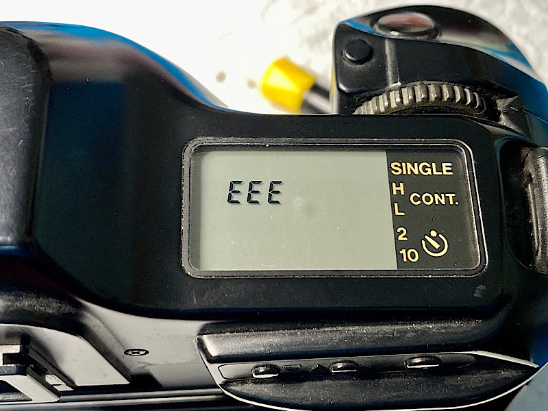

  • The LCD display is normal.
  • The mirror is triggered,
  • both shutter curtains don't open,
  • EEE appears on the LCD, and HELP appears on the LEDs in the viewfinder.
  • After removing/reinserting the battery holder and trying again, the same sequence occurs.

I try this several times without a lens attached, but the camera still doesn't work. EEE/HELP continues to appear.

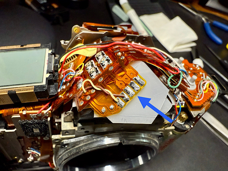

Therefore, we continue with the covers removed to check the solder connections of the shutter-flex connector on the upper circuit board.
I resoldered the indicated solder points on the board, even though they looked normal. However, there was no change in status.

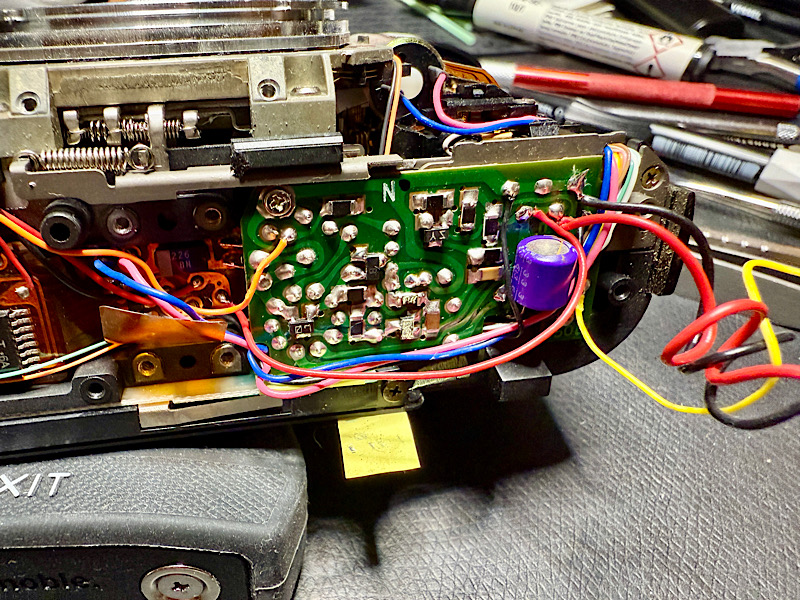

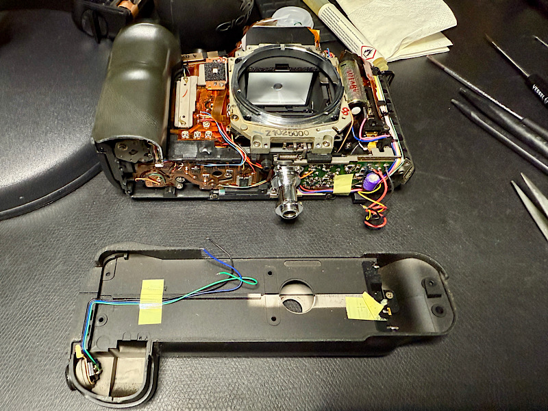

I continue with a voltage measurement on the DC/DC converter, which is located at the bottom of the T90 and provides various voltage levels from the 6 volt battery voltage to power the individual circuit components.
To do this, I have to remove the battery compartment.
Since I have also disconnected the cable connections from the battery compartment to the camera, I connect the T90 to my laboratory power supply.
The circuit can be reset with the yellow cable by shorting to ground, which corresponds to pulling out and reinserting the battery holder, see first troubleshooting instruction above.
On the orange cable, I only measure a maximum of 15 volts after a reset, instead of 18 volts. The voltage drops rapidly afterward. The purple electrolytic capacitor on the DC/DC board is obviously discharging.
It's possible that the capacitor is no longer fully functional. To check and measure it, I have to remove the board.
I perform a few more resets with the yellow wire to ground, and suddenly the shutter fires. Then the T90 goes back into EEE/HELP mode, and after another reset, the camera works. I run the motor in high mode to keep it moving and resolve any contact issues with the magnets.

Removing the DC/DC converter, measuring the electrolytic capacitor
The DC/DC converter is housed on a separate circuit board at the bottom of the T90. I removed the converter to be able to measure the electrolytic capacitor.
For testing, I desoldered the electrolytic capacitor from the circuit board.
The nominal capacitance, according to the label, should be 33 microfarads; the tester confirms this value. The ESR value is very good at 0.12 ohms. There's no electrolyte leakage visible at the terminals. There's nothing to indicate a defect.
Before reinstalling the DC/DC converter, I measured the voltage on the converter of another T90. Here, too, the maximum reading was only 15 volts, not 18 volts. This suggests that the converter, including the electrolytic capacitor, is OK.
The converter is back in place, the voltage is correct.

After loosening the front flex connector, the circuit board on the shutter can be accessed.
The green and red arrows point to the connections of the magnet for the front shutter curtain (test points TP-19A and TP-19B). This is where I apply the 6 volt supply voltage.
Both shutter curtains are triggered.

Highlights removal mirror box and shutter
With Larry Lyells' excellent instructions in the SPT Journal, I made good progress.
There are quite a few connections to be separated, most of them soldered, but relatively few parts to be removed. See the SPT Journal for details.
Flex connector loosened.
Desoldering connections.
Eyelens removed.
Area under the LCD. IC3 from Toshiba.
Shutter connections desoldered.
Mirror box separated with main flex.
Shutter removed.
Details shutter.

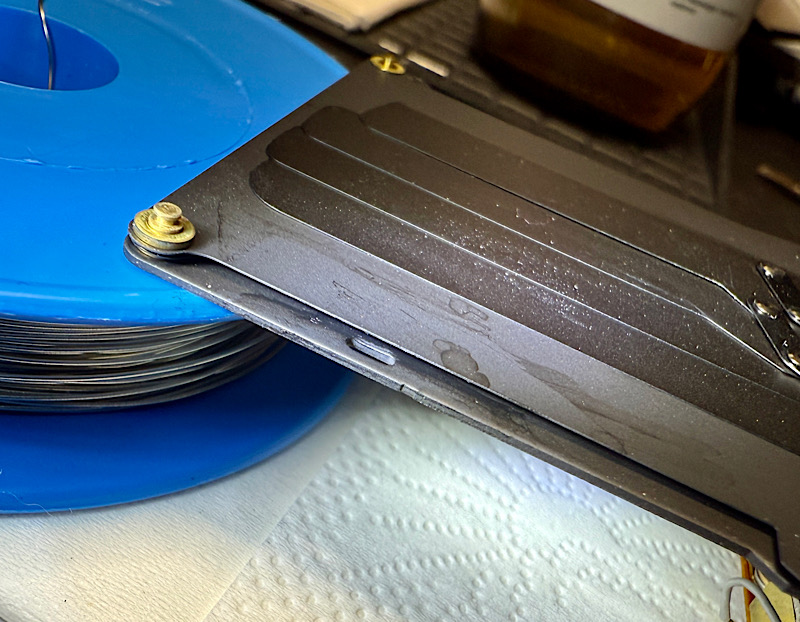

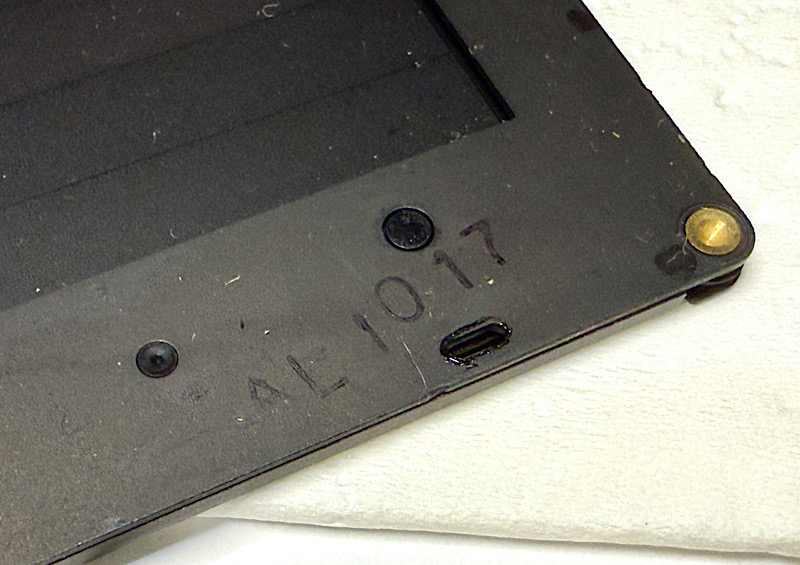

Before testing the shutter, I remove the sticky rear curtain damper from the bottom of the shutter. To do this, I open the shutter.
Only one screw needs to be loosened.
The two springs on the right remain in their position.
The damper, a known weak point on the T90.
The camera has obviously not been used for a very long time, as there are no sticky traces on the shutter curtain.
Anchoring on the front. The damper is inserted into both openings.

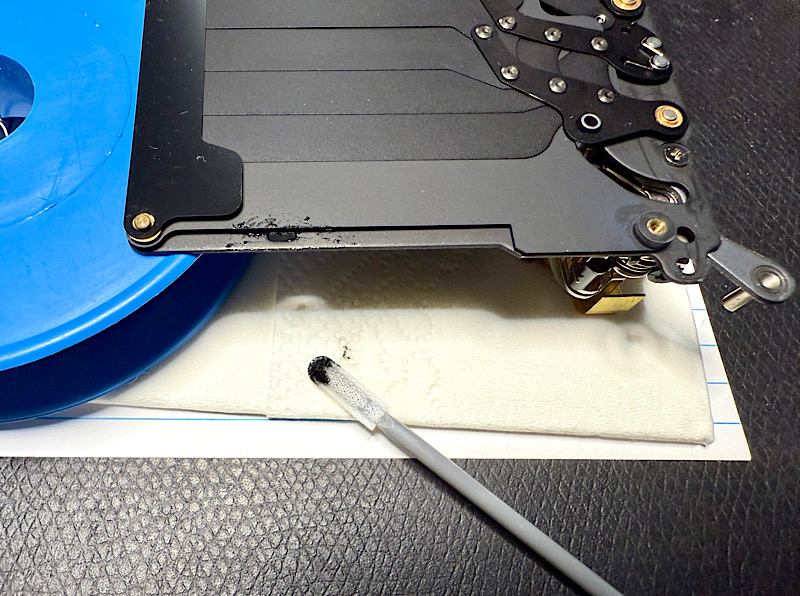

Remove the damper with the probe. The material is soft and extremely sticky. Clean the tools carefully with acetone.
Fine cleaning with acetone and cleaning swabs.
The small opening on the cover is also cleaned.
The cover is reattached.
Cleaning the opening on the front.
I'm not installing a replacement for the damper. This corresponds to the status after applying the shortcut with external cleaning, see link above.
I want to leave the shutter in its original condition as much as possible so I can focus on the cause and resolution of the EEE/HELP error.
Since the camera has obviously not been used for a long time, this could have contributed to the magnets not separating.

When the second release lever is pulled, its switch opens, and the curtain expands. The film gate is closed.
When the shutter is electronically triggered, the two permanent magnets open the switches.
Current flows through the coils, which generate a magnetic field and thus cancel out the magnetic field of the permanent magnets.
Testing the magnets
Connecting the laboratory power supply with two crocodile clips.
Setting 3 volt output voltage.
Apply voltage to the two contacts of the first shutter curtain.
The curtain opens.
Apply voltage to the two contacts of the second shutter curtain.
The curtain closes.
Result
The shutter works mechanically and electronically, and is not stuck by remains of the sticky damper.
What I can still do is clean the switch contacts and contact surfaces with electronic cleaner respectively benzine.
Now it's time to assemble the T90.
This requires some preparation and testing to connect the shutter, mirror box, and charge motor.
Stay tuned!
