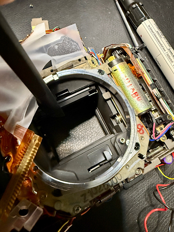

But whether it's a mechanical problem with the shutter or with the circuit board on the shutter, I would have to work my way through the camera to get there.
To remove the mirror box, Larry Lyells describes about 30 steps during dismantling. The chance of not breaking anything or getting everything right when assembling is small, very small.
And even if I should manage to do it, I have to understand the processes at the shutter in order to fix something there. Or the error lies in the mechanics of the mirror box which seems even more complicated to me.
This means that troubleshooting only if there is suspicion involves a lot of effort and risk.
I should listen to Thomas Tomosy, who writes about the T90:
It is not recommended that you attempt to repair this camera. It is included here only to show what you’re up against when it comes to fully automatic electronic SLRs.
Thomas Tomosy, Camera Maintenance & Repair, Book 1, Buffalo/NY: Amherst Media, 1999, Kindle edition, position 2218.

Also impressive under the hood: Canon T90
Final thoughts on the T90
  • I just have looked through Canon's service manual for the T90 (suaudeau.eu). Right at the beginning, additional information material that is not available is pointed out. Material that we lack for deeper understanding.
  • After replacing certain parts such as ICs, extensive adjustments must be carried out, among other things. with devices that are also not available.
  • A limit of what is possible in DIY service and repair has been reached here, at least for the hobby workshop at home. But I am not aware of any workshops that would accept the T90 for service, with the exception of one workshop in the USA.
  • Anyway there is no reason to be sad, almost all common problems with the T90 can be resolved or prevented, as we have seen 👍
  • And if an electronic camera still works after around 40 years of manufacture, it should continue to do so for another 40 years. All I see here is quality and electronic circuits do not suffer from wear and tear, even if components such as electrolytic capacitors can age or fail due to overload.
  • Since the T90 only has 6 volts of input voltage, which is converted internally to 18 volts, overloading should not be an issue, in contrast to devices powered by mains voltage generating heat by power dissipation.
  • The T90 is also excellently sealed against dust and dirt, but there is no seal against moisture.
  • The shutter and mirror mechanism are solidly designed. The three electric motors should run without wear.
  • The T90 is also insensitive to shocks and impacts, as shown by the infamous method against stuck magnets. Here the camera is placed hard or worked with a rubber mallet.
  • If you want to work with the T90, you should buy several copies as a backup that are kept fit through regular exercise. You get a lot of performance for relatively little money.
  • It is a camera still far beyond its time, the best photo machine ever made for manual focusing.

But since the motor is running, it could be a mechanical problem, for example, a clutch isn't engaging.
To find out, you'd have to open the T90.
The rewind motor M3 is located up front, in the picture on the right:
To get there, all you have to do is remove the front cover. This is easy with the T90.
You'd then have to look into the mechanics of film rewinding. This probably won't work without research and tools.
