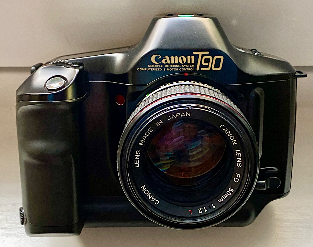

Based on my previous (repair) experiences with the Canon T90 with regard to preservation/problems/repair options, I would like to give a summary of the following recommendations/hints:
  1. Sticky shutter - gummed-up shutter blades: Can be permanently repaired, damper in the shutter area that has become sticky can be removed without dismantling. Lighter fluid/acetone on blotting paper and, if necessary, a probe are used.
  2. Shutter does not release - flashing arrow in the display: The cause is the mirror magnet, which no longer works due to magnetization. Can be fixed with a magnetized screwdriver blade or replaced with only little disassembly.
  3. Shutter does not release - “EEE” is displayed on the display and “HELP” in the viewfinder: If gummed-up shutter blades are no longer moving see 1. Other cause: locking magnets that do no longer separate. This can only be fixed by deeply dismantling the camera; I am not aware of any report on this yet.
  4. Light seals and mirror shock absorber should be durable in the long term. I haven't had a T90 with any problems yet.
  5. Any corrosion in the battery compartment due to leaking batteries: One should always check whether the decomposing battery acid has already worked its way through the connection cables towards the circuit board. Dismantling necessary, if necessary cleaning and replacing the soldering points/wiring.
  6. The T90 should be moved regularly to prevent problems with the magnets (2., 3.). I trigger my T90s every month and check the function.
  7. A display that displays incorrectly can be replaced. Dismantling the top cover and soldering skills required.
  8. Backup battery for ASA setting: Same as 7.
  9. Dial wheel with dropouts - for example, increasing aperture values are not displayed per click. Contact error, probably due to oxidation. Point accessible by dismantling, but complication due to short cabling to the trigger. Therefore cleaning of the contacts can be tried by turning them often.
The T90, introduced in 1986, is a fascinating camera that still has the potential to overwhelm due to its diverse features.
Known as “the tank”, it is robust and valuable. The mechanics are heavy duty and designed for hard work.
Together with the FD lenses and system flash units, you get a fully motorized complete package for first-level analog photography 😍
All information provided without guarantee and use at your own risk.
