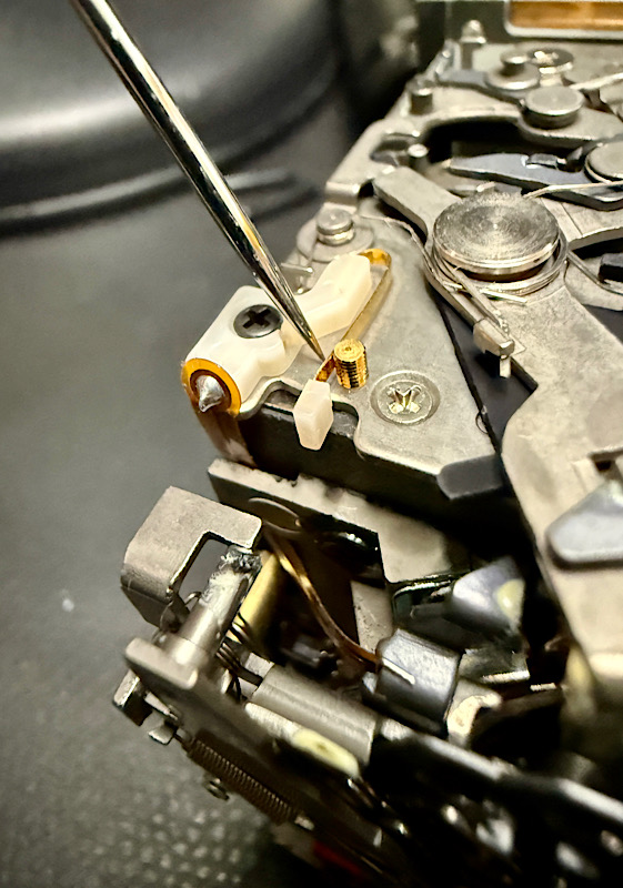

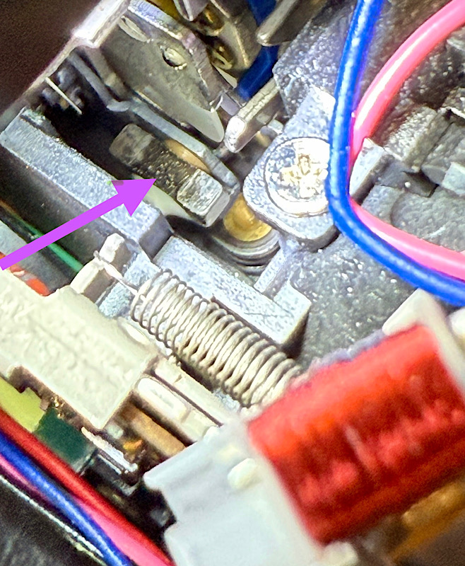

The epoxy is now solid.
When tightening, you can see that the spring moves slightly under the epoxy droplets on the left screw.
This is perhaps a good thing; in any case, the curtain travel times have remained stable and have even improved 😌

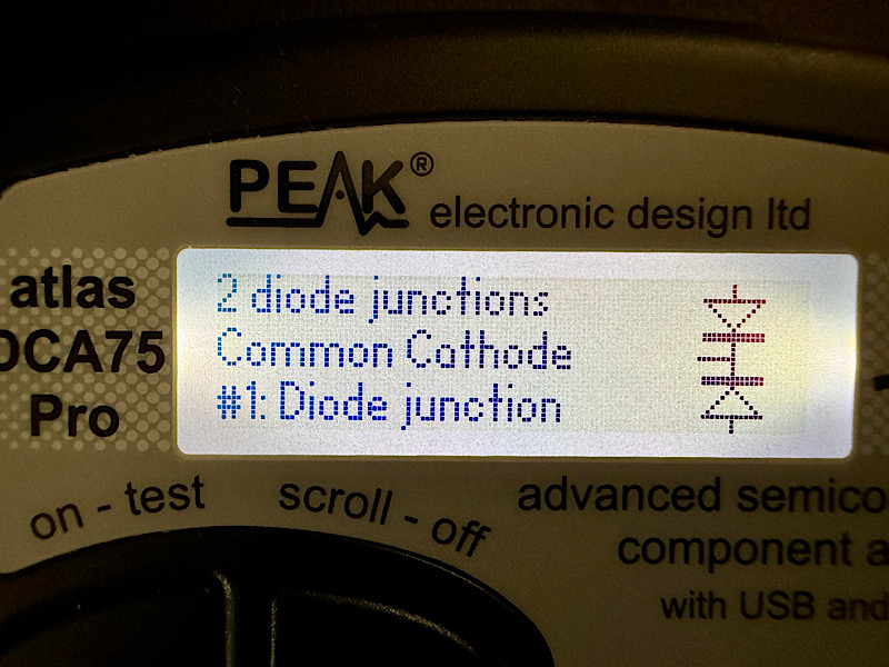

I went through the troubleshooting instructions, removed a double diode to test it, re-soldered the circuit board connections, checked the connectors, as well as the magnets, which worked.

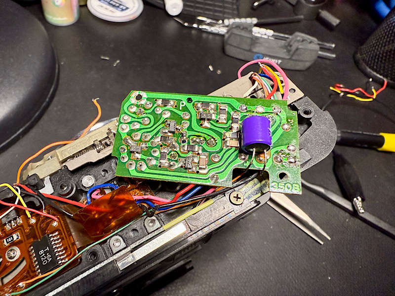

I then replaced the DC/DC converter three more times because a reference voltage was not appearing there.

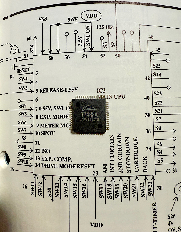

Voltage measurements on IC3, the main CPU under the LCD, did not match the specified values. So I finally replaced IC3, but that didn't work properly with the soldering of the 60 pins. I'm not equipped for this fine work. And I was already outside the service instructions, which don't recommend it, but recommend replacing the entire mainboard 😌

What surprised me was that 15 volts weren't measured on the DC/DC converter; the voltage wasn't reaching the terminal. And that was the case with three DC/DC boards. So that rules out a fault.
But voltages were measured on the board. So, it wasn't a short circuit.
The only explanation I can think of is that IC3 was actually faulty. The voltages that weren't appearing at certain pins support this. And the technical documentation also says that.

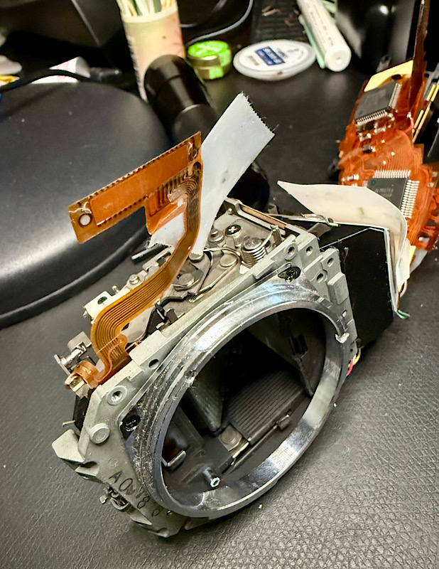

Replacing the electronics to fix the EEE/HELP error
After a long sleep and a hearty breakfast, I took the T90 out of the spare parts box and continued working 😌
Since I couldn't locate the fault, I replaced the entire mainboard, providing most of the circuitry and connected to the mirror box which I also replaced. A spare parts T90 was looted.
But that didn't solve the problem either. As soon as the camera is turned on, the winding motor still moves briefly and EEE/HELP appears.
So today I removed the motor flex board from another spare T90 and will install it in my patient tomorrow.
Then most of the electronics will be replaced, and hopefully, the error won't have too many possibilities anymore.

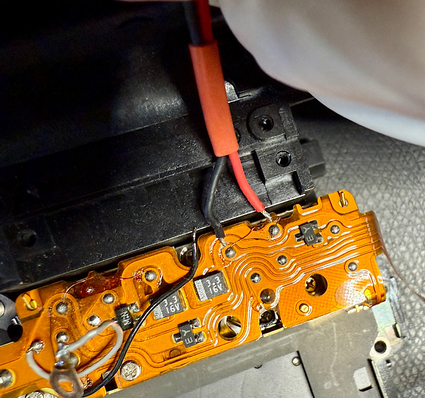

Simple tool to trigger the shutter magnets
To test the electronic triggering of the two shutter magnets, I built a double contact that is fixed with shrink tubing.
It is connected to the laboratory power supply, which is set to two volts.
This allows the magnets to be triggered directly via the contacts on the shutter board.

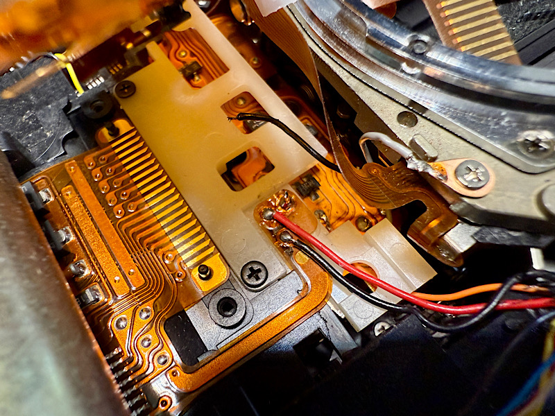

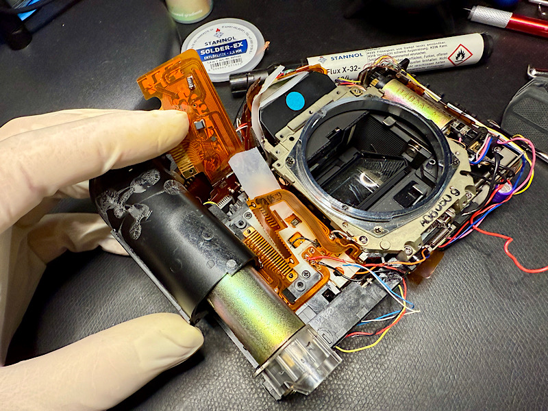

Check and repair of soldering connections
Before replacing the motor flex board, I checked some solder joints that had been damaged during desoldering. Perhaps that was the cause of the problem.
Damage to the contacts that could lead to wiring problems.
Continuity test contacts to DX contacts in the film chamber for automatic ASA detection.
Bridging a defective connection with tinned copper wire. Flux shines at the solder joints and on the board.
A test showed that this was not the cause of the problem.

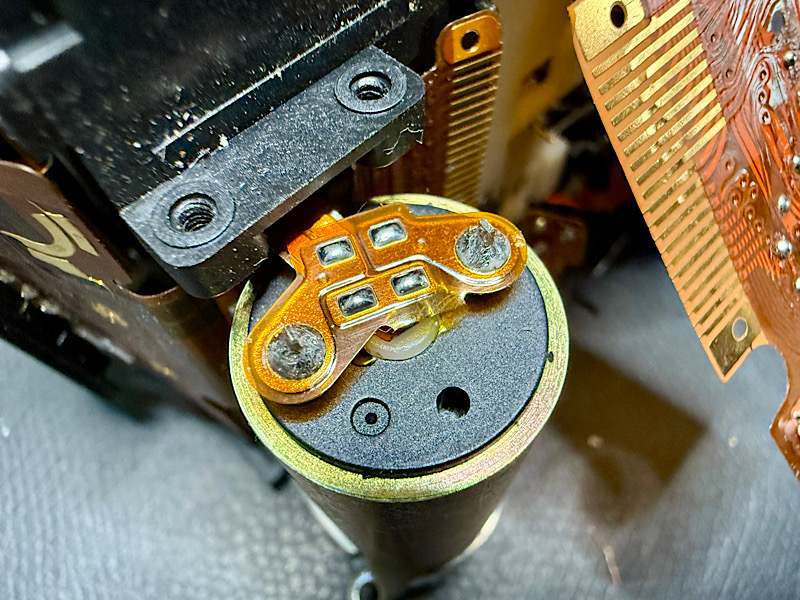

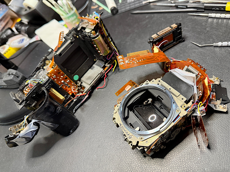

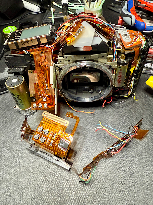

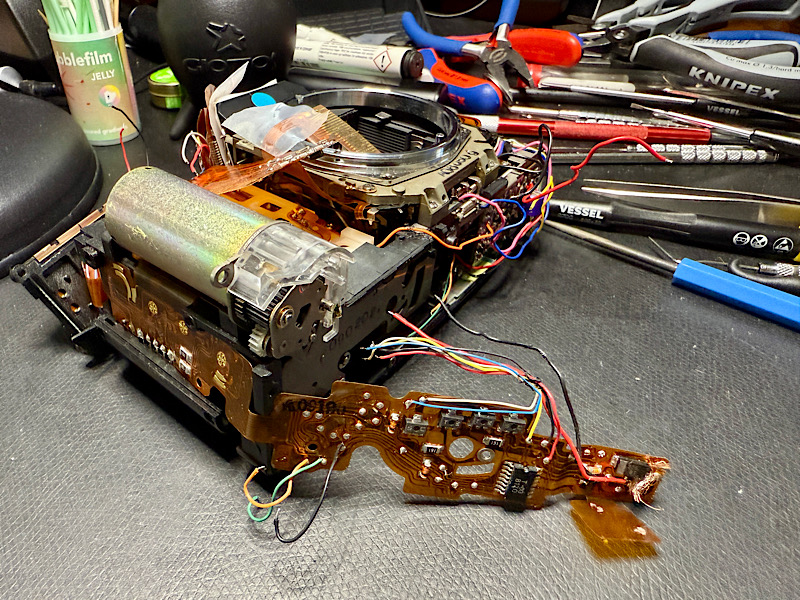

Removal of the motor flex board
Upper part of the board with red and black motor connectors.
Power supply for the motor flex board on the release side at the front.

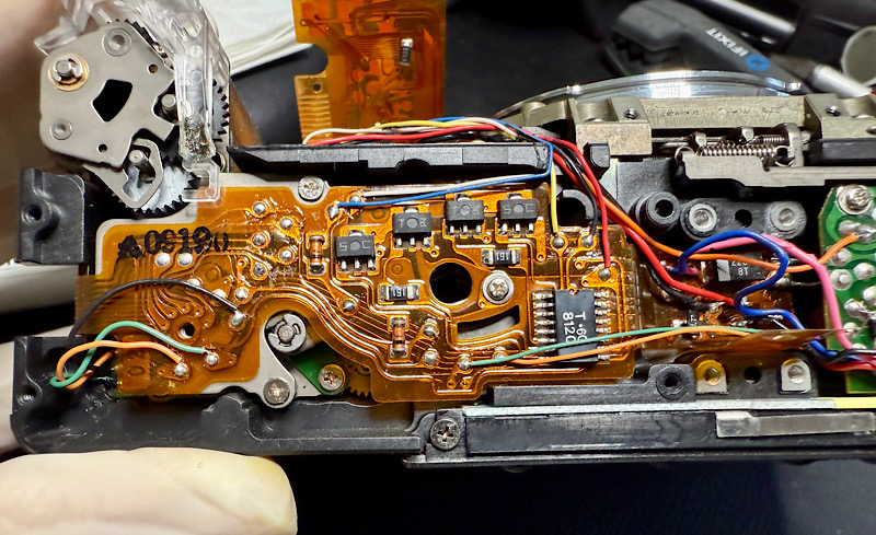

The lower part of the motor flex board.
Removal completed.
Area under the board.

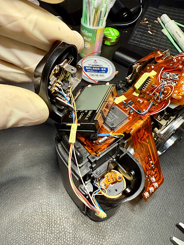

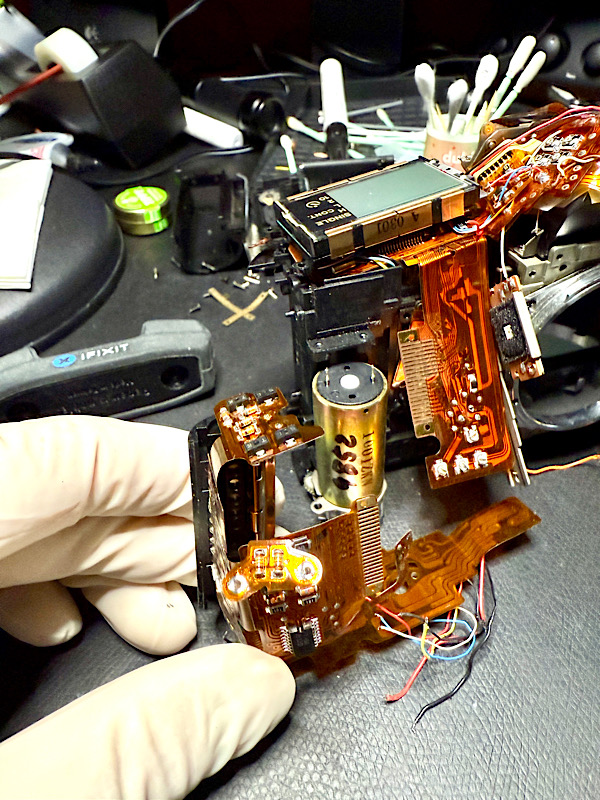

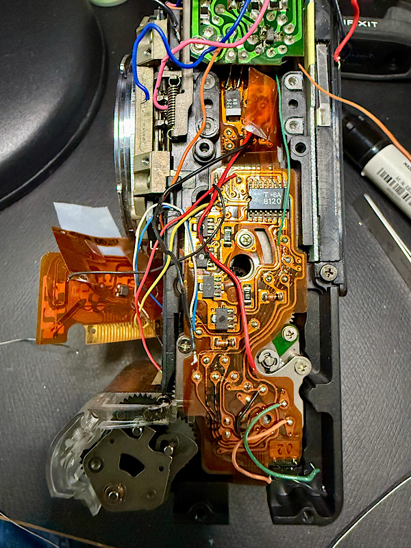

Installing the replacement board
Everything in reverse order.
The new board is installed and still needs to be connected. There's a lot of soldering to do.

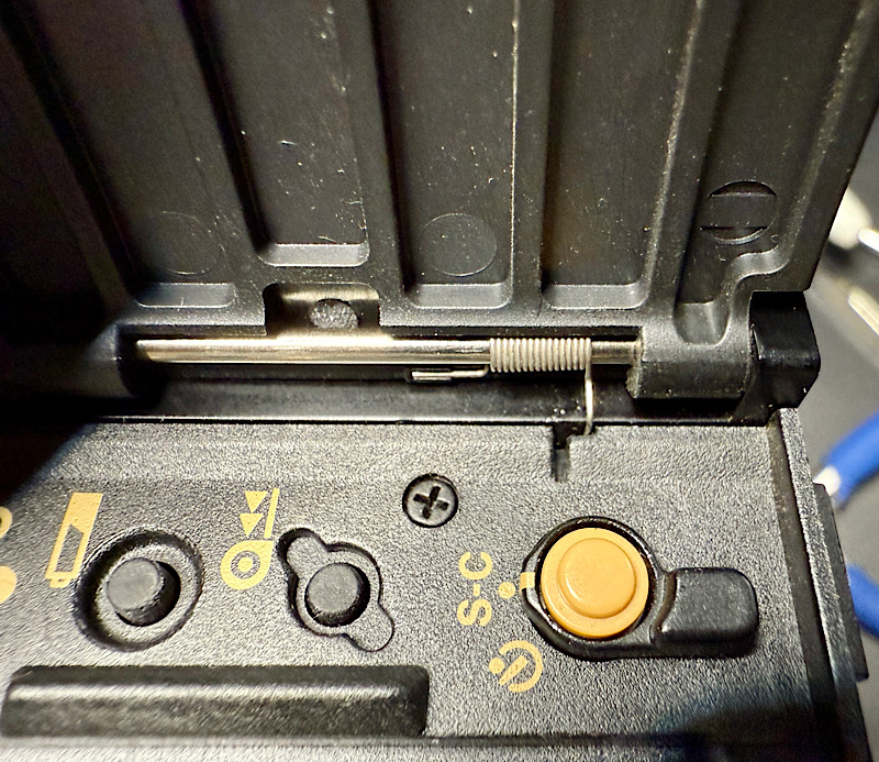

The handle goes back into place.
Switch panel assembly.
Inserting the spring into the cover flap was a game of patience.
The wiring of the trigger unit is threaded through the handle.
Done

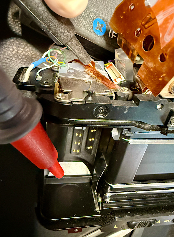

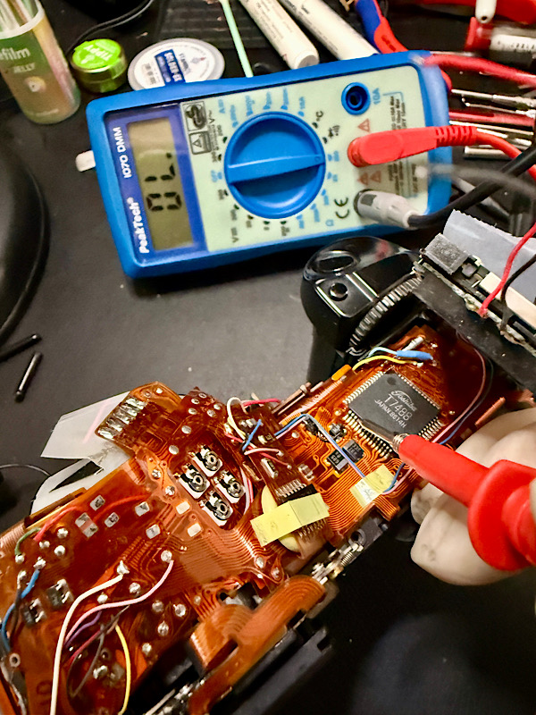

The C&C Associates Troubleshooting Guide for the T90 includes a multimeter troubleshooting routine, which I followed.
Here, I measure the resistance at a pin on IC3, the main CPU.
Suddenly, success arrived. Problem solved!
Switch 13 on the mirror box was obviously contaminated/blocked.
After pulling the mirror housing out a bit, I was able to clean the switch with electronics cleaner.
And with that, the T90 was suddenly alive again. All its functions were there 🙃

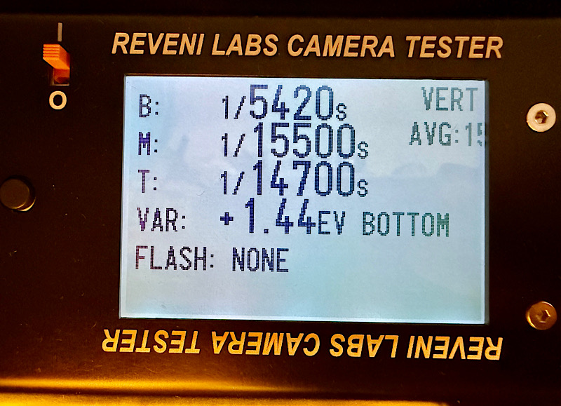

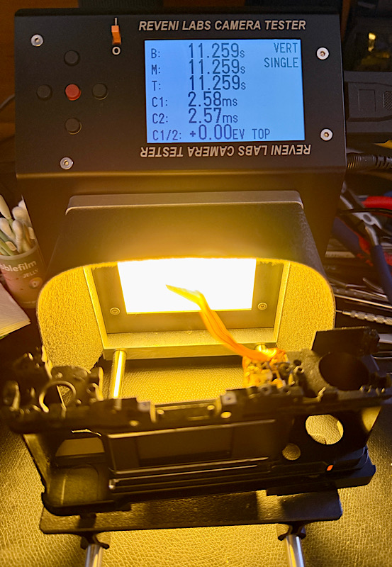

On the camera tester

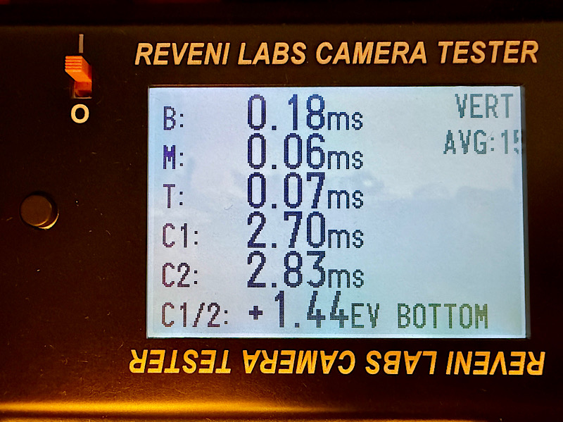

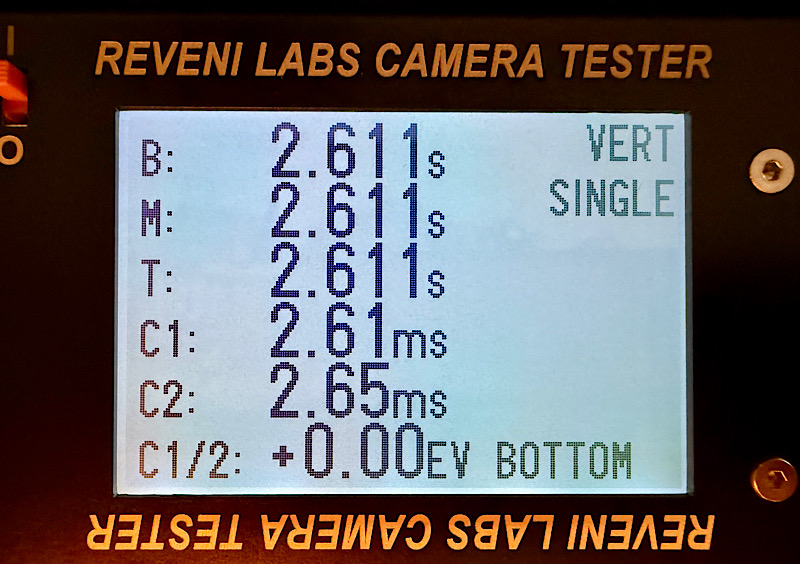

Now I could finally test the shutter, which I had disassembled, cleaned and stabilized with epoxy, on the camera tester.
The curtain travel times (C1 and C2) remained stable.
It's hard to believe that these sensor data add up to 1/4000 of a second.
But it was meant to be. Here I tested the 1/4000 second in TV mode with a lens. The exposure result was correct.
An acceptable result in Program mode too.
Many hours of work paid off. I was able to rescue another T90 from the spare parts bin 😊

I replaced the DC/DC converter twice, as one was probably defective and not delivering the specified voltages.
After that, I went through the troubleshooting instructions again.
Charge motor MD2 (handle removed), on the right part of the front connector.
The problem seems to be with the front connector. I got a bc and an EEE once, then the LCD worked, but no LED in the viewfinder.
I cleaned the connector and placed paper under the pressure plate to increase the pressure, but it didn't help.
I suspect a connection in this area is broken as I couldn't get continuity from a pin on IC3 to a diode.
