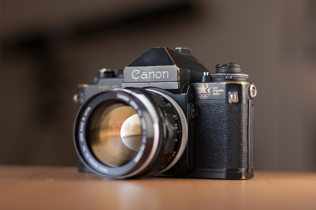

One way around the depreciation of those mint cameras, buy 'em pre-brassed!

Nice shot. Which FL lens do you have mounted? My favorite 35mm lens is the Fl 35mm f/2.5. But yours is looking like it might be a 55mm f/1.2.
It is the 58/1.2. I recognize it easily (the front decal ring is narrower than in the 55)
McCooltouch, is your favorite the FL 55 over the FD 55?

It is indeed the FL 58/1.2. I haven't tried all the other Canon 1.2 offerings besides the FL55, which beats it, but the 58/1.2 is "better" than the LTM 50/1.2 as far as contrast especially wide open, and flare. The later FD 50/1.4s are again "better" which is to be expected.
I happen to like the look of the FL58, it's very similar to my Rokkor 58/1.2. Not quite as smooth out of focus as the famous Rokkor bokeh but very very good and great for mid length or full portraits. Any tighter and noses get too big for my taste. I'm not a fan of round head portraits though, so YMMV.
Actually, I had the opportunity to do a direct comparison between the FL 55/1.2 and the early chrome-nose FD 55/1.2 and I could tell absolutely no difference between the two. I have since read a couple of different articles that claim that the FD 55/1.2 is indeed the same optical formula as the FL 55/1.2. So I don't really have a preference. Well, the FD's coatings might be a little better. I eventually sold the chrome nose after buying a later FD 55/1.2 SSC, cuz I figured its SSC coatings might be better than those found on the chrome nose.
BTW the R 58/1.2 was the first f1.2 lens for SLR cameras, ever. The FL 58/1.2 is supposedly optically identical.
It has its own distinct look, different to the 55
