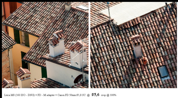

Do you mean this test: http://www.marcocavina.com/articoli_fotografici/Canon_FD_lenses_and_Leica_M/00_pag.htm
I see that Canon lags far behing the Summicron at any apperture. Obvious even at f/5.8, even more at wider settings.
Both pictures courtesy of Marco Cavina.

Miha,
You are looking at the images of the FD 50/1.8 S.C.
Now look at the images of the New FD 50/1.8, included in the same comparison.
True, my mistake.
Your statment is thus correct, but have a look at the lenses wide open! Summicron is still excellent, something that cannot be said for the canons at f/1.8-f/2.

True, my mistake.
Yes, the Summicron is a better lens, and at 20x (?) the price of the Canon lens, it should be.
But my point is that, taking the Summicron as a benchmark, at f5.6 (the ideal aperture for a 50mm lens), the Canon New FD 50/1.8 is behaving really really good... Even more if you consider its cheap internal construction (barrel is plastic, lens retainers are plastic).
Even compared to the illustrious Canon New FD 50/1.2L, a "dream lens" for some, the 50/1.8 at f5.6 comes out really well, with an extra of 'crispness' and contrast over the f1.2 lens.
