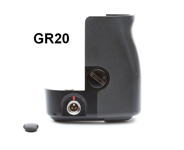

Is the grip properly installed? Is the retaining screw, screwed all the way in?
Either one will cause the camera to not power up.

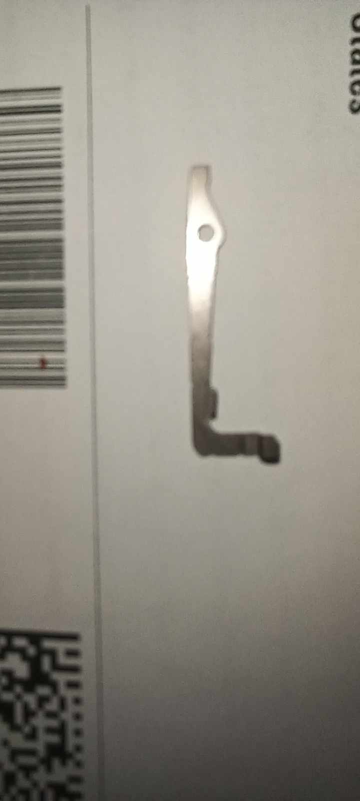

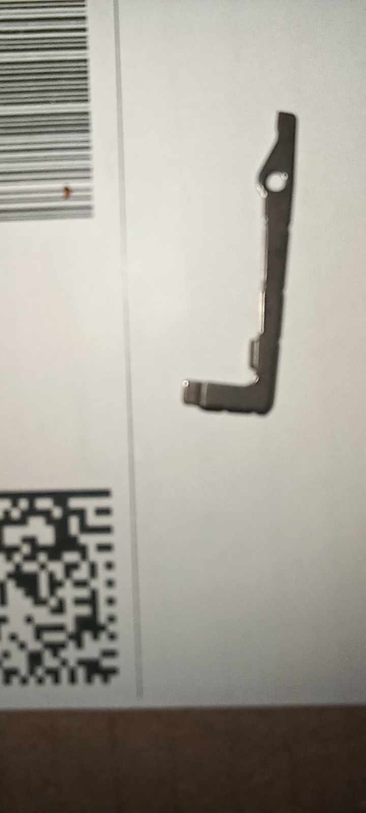

While I was removing parts a part fell out. I did not notice it while I was taking of the front plate and bottom plate. If you know what this is and where it goes, message me.

That part is part of the latching mechanism for the film door. That part alone won’t stop the camera from working.
The EOS 620 does have a history of the backlight circuit draining the battery. Cutting the wire eliminates the battery drain, but it will never prevent the camera from turning on.
It seems that you caused some other damage when you opened the camera to modify the backlight circuit.
