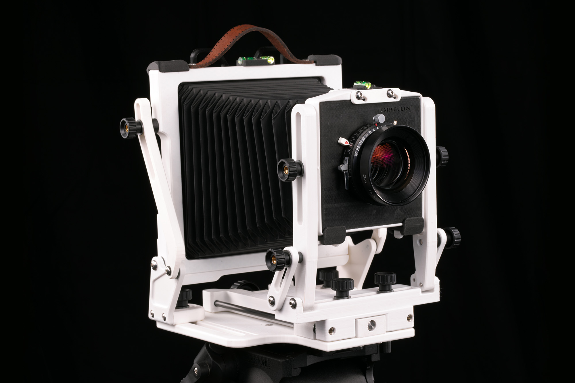

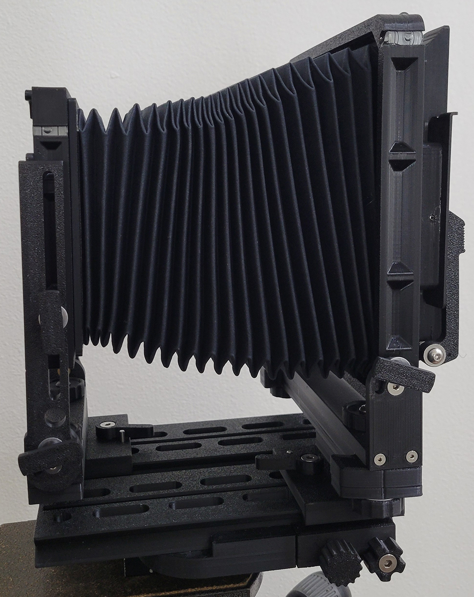

dang--lighter than an Toho FC-45X:
1.39kg, 488mm of bellows, 3D printed in PETG, $875
Neat idea. I wish them well.
I wonder if there's a bag/universal bellows available. That would be great with short focal-length lenses.

I guess 3D printing is the way to go, unless you go for super nice yet super pricey CNC like Stenopeika. I do 3D printing with PETG as well, but the knobs probably won't last that long.

I do wonder how his son's PETG camera compares to Walker's ABS cameras in terms of stability and durability.
ABS is harder and heavier, and can be brittle if it's too cold. Walker cameras are almost entirely out of production. Wood is definitely easier to DIY repair, unless it's just a simple gluing issue.
PETG as a printable plastic is outside my own sphere of experience. I wonder how well it dimensionally holds in hot weather. I don't think it can be conventionally glued, and heat welding things back together can get tricky. But if the camera model in question catches on, perhaps spare parts will be available.
It's not going to win any beauty contests, but that's a moot point out in the wilds n' weather, where some battle scars are inevitable anyway.
Another question would pertain to linear flex at full extension; I'd expect it to be inferior to wood or machined metal in that respect, but a lot depends on how tight the gearing and extensions sections lock onto one another too.

PETG is a polyester compound so it is pretty resistant to heat. It’s also less likely to fracture compared to something like PLA (polylactic acid—the most common material for 3D printing.) PETG requires higher heat and takes longer to print, but that’s more a matter for the manufacturer than the user. When I send off to have someone with a printer print lens boards, I have them use PETG. I also read concerns that black PLA wasn’t fully light tight, but I don’t know if that was speculation.
My biggest concern is flex at full extension. Also it’s not really ideal for wides—with something like 78mm minimum extension. My Nikkor 75 would need a recessed lens board. I would hope that it can use DLC wide angle bellows, one less part to design. It’s clearly inspired by the DLC.
