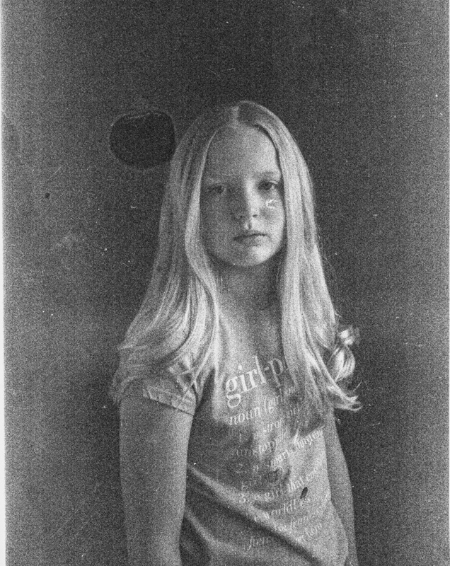

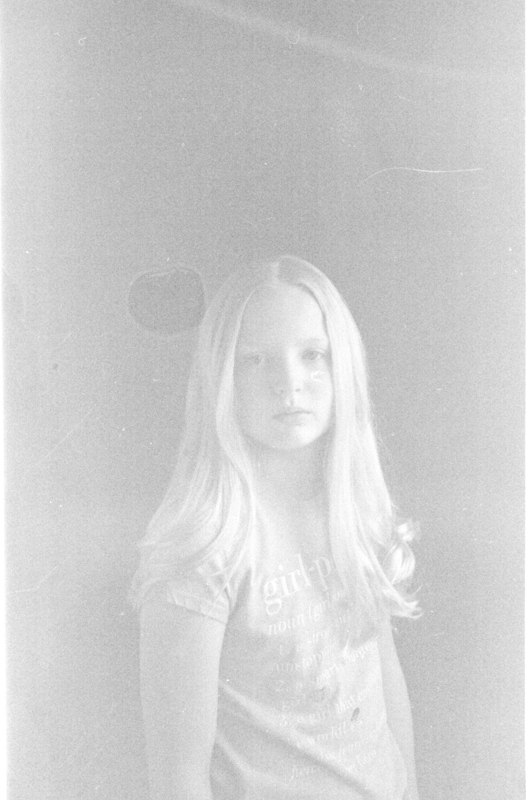

Yes. I've done it. But I don't remember what chemicals I used (I really need to take better notes). I do remember that a pre-soak was involved. I developed a roll of Kodak Gold 200. It was in the camera when it was gifted to me. Before sticking in another roll, I wanted to see if it still worked. The orange mask was still there. A faint image could be seen when held up to the light, and when scanned a definite image was seen. The negatives needed a bit of help in LR, since they were rather thin. Here's one (unedited and edited).
