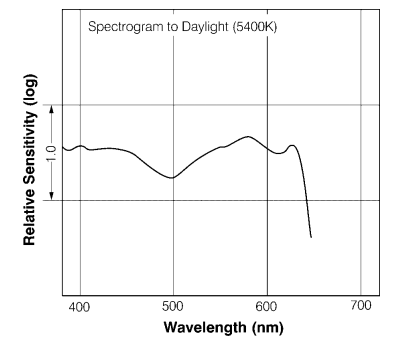

Hi Drew, You're right, but I think it's both.
Here's acros:
And here is Adox CHS 100 II:
I think there are four things that "characterize" these films:
  1. sensitivity does not skyrocket and get extreme at wavelengths below 450 ( does not over-emphasize blue, violet and UV )
  2. the "dip" near 500 helps suppress that end of blue ( including some sky ) and separate the green
  3. the sensitivity is increasing again in green ( probably helps separate the different shades of green )
  4. not much sensitivity above 650
Those graphs match my experience... I'd say acros has a more pronounced "good clouds, good green separation" than CHS II, but they are similar. Maybe acros has the blue toned down a bit more and the greens tuned up a little higher.
No. It's the red sensitivity that's trimmed back a bit - clearly evident in the published spectrograms. But the complementary effect is to make the film seem proportionately more sensitive to green. Blue sensitivity per se differs quite a bit among various pan films.
Yes, it's trimmed "back" in terms of wavelength cut-off at 630-ish, but I was speaking of the amplitude across the spectrum before cut-off where it seems to me the blue end is lower than the "near red" end compared with some other films. Anyway, I think NedL has a good explanation for what's happening, and as noted, I've observed that.
I'd pretty much agree with that assessment too.
