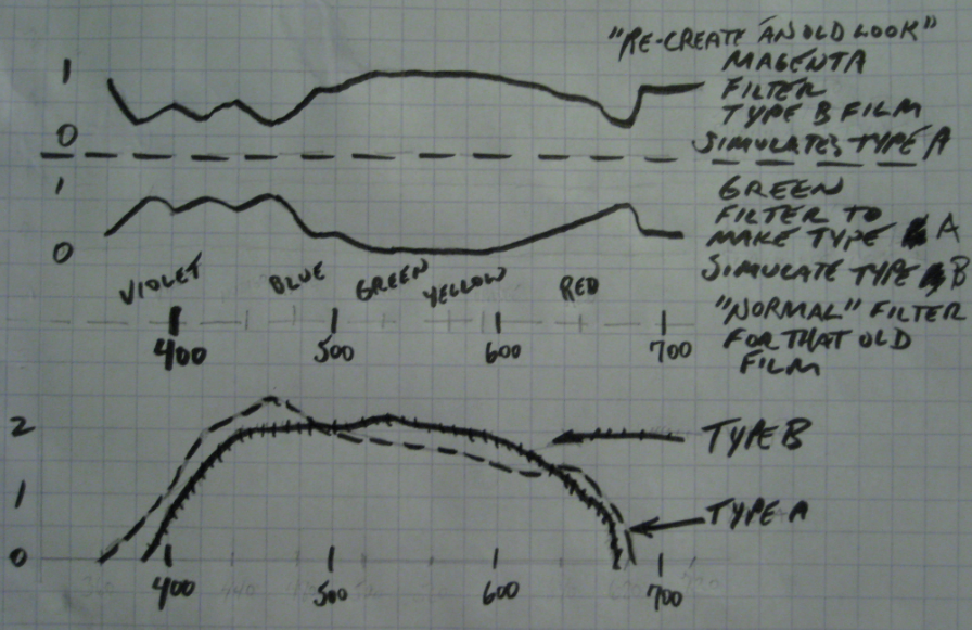

I drew a graph roughly superimposing Type A and Type B panchromatic films' spectral response curves and above that I drew the differences...
The differences between the films tells you the kind of filter you would have to use to make one film act like the other.
Why would you need a green filter? When you have a Type A (old) panchromatic film and wanted the results to look normal. That's why Green filters were important in the old days.
Why would you ever want to use a magenta filter? When you have a Type B (readily-available today) panchromatic film and want to try to re-create the look that early photographers got when they had Type A panchromatic film and didn't use a filter.
I think it would be a neat experiment to use a magenta filter and try for an old look. Since the numbers are logarithmic, and the peak is around 1... the magenta filter that might do the trick might be a 100CC Magenta filter.

I thought you would agree with the way I approached this, so I'll give a little explanation of what I did...
I drew the curves from the 1942 "Principles of Photographic Reproduction" and those are prints of a spectrograph through a step wedge with "daylight quality" source. Miller acknowledges Kodak for the charts. I have other books that show the device.
I like the older graphs more than the new "clean" graphs because it's not hard to estimate the data points to copy to graph paper.
For the "suggested filter" curves, I only estimated displacement between curves, for example at 460nm the two curves differ by 0.5 because the Type A shows 2.5 and the Type B shows 2
Because I intended to describe the curve of a suggested filter, I displaced the difference graphs to zero (because I was getting negative numbers that wouldn't conceptually work with filters). Then, to illustrate the differences from Type A to B ... and Type B to A... I reflected the curves.
Then I browsed the Kodak Filters for Scientific and Technical Uses booklet, looking for filters which dip in the green/yellow region.... (Kodak No. 11 looks like a good fit) and peak in the green/yellow region... (this looked to me like Magenta CC 100).
I often get fascinated by the idea of simulating an old-style film because I don't get blank skies with 400 TMAX and I never seem to block highlights. So I am curious about the problems photographers used to struggle with, and I am sometimes charmed by old photographs.

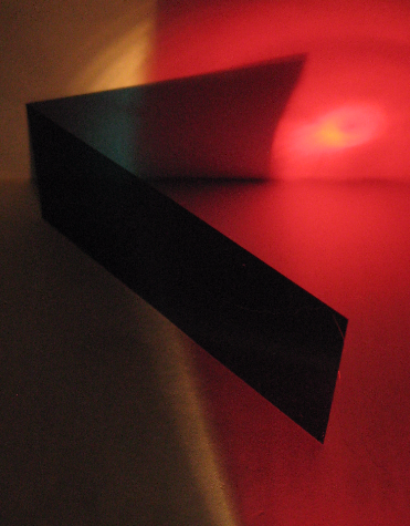

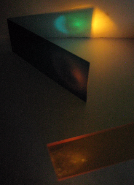

Red light is blocked by a cyan filter...
As yellow light passes through the cyan filter, the red gets blocked. Cyan filter allows through the green part of the yellow.
