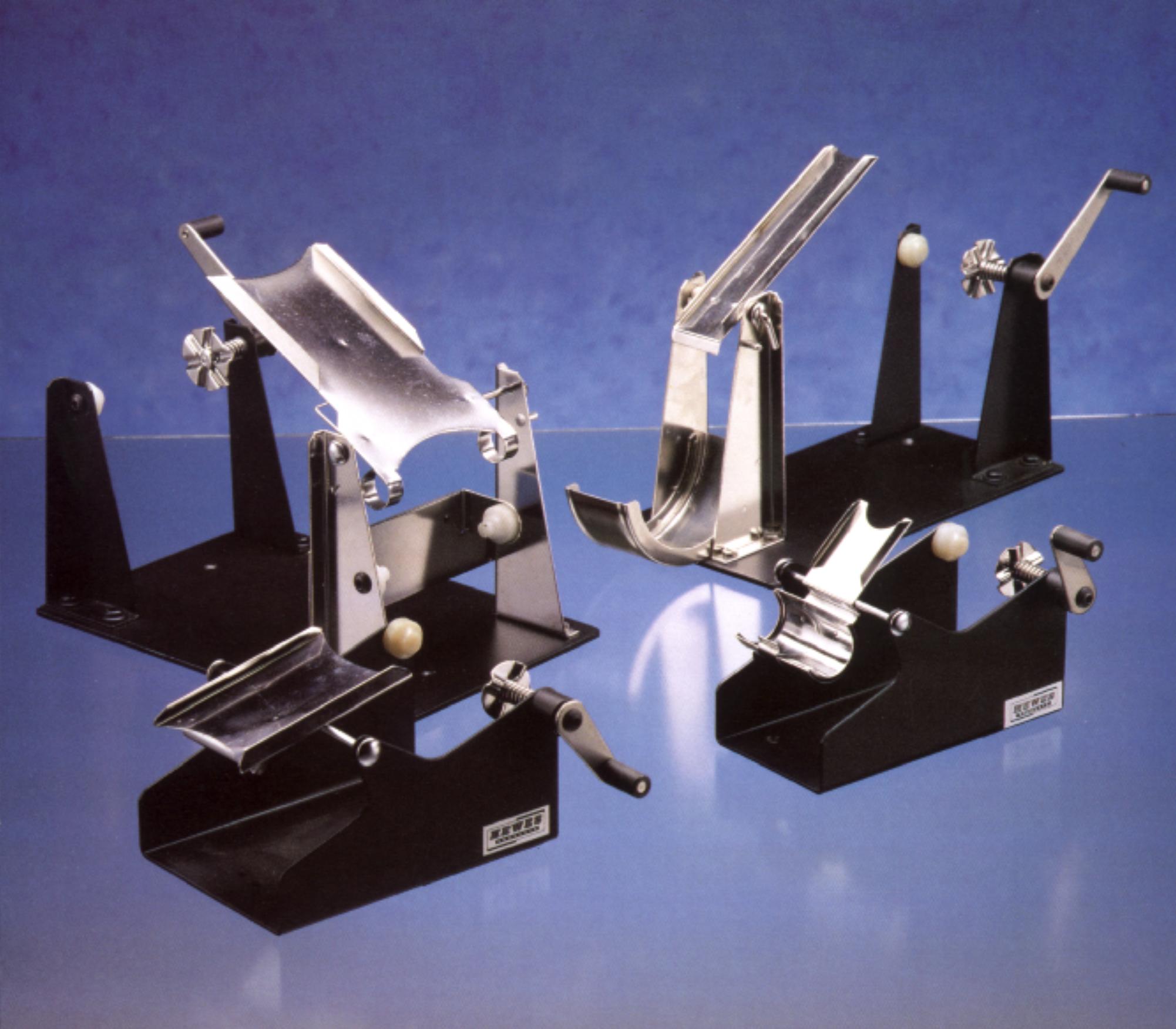

Wait they have a daylight loading tank for their 70mm reels?? Are you sure?
The Hewes loader is a spiral loader not a cassette loader. It holds the spiral and has a tongue to put a little curl in the film so that it goes into the metal spiral neatly.

This is from the Hewes website. I think they're just for spirals and the previous poster was mistaken. Anyone know how they work?

You can see they're for spirals because the cranks have notches to support the wires at the core of a Hewes spiral. And there's a place for the reel to be supported and have the film pulled off it and follow the metal strip (guided by the folded edges) onto the cranked spiral.

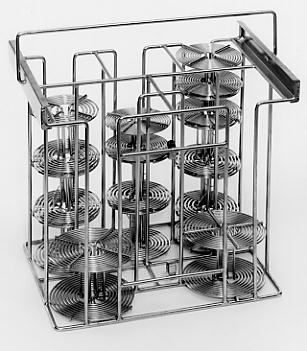

My question related to whether anyone had used Jobo spirals to do 70mm, since I have a CPP2 and lots of spirals.
Jobo #5025 = 70mm loader and guide
Jobo #3075 = 70mm reel 5 meters
Jobo #3035 = One-reel tank for above reel
Jobo #2517 = 70mm reel for 2500 tanks (film length??)
Daniel.
First the ones on the site say specifically 35mm only? Or I remember reading that.
Secondly I don't seem to understand what "for spirals" means... Aren't all developing spools spirals? Am I missing something?

They're for transferring exposed film from the cartridge to the spiral, i.e. they are spiral loaders. They are not bulk loaders for transferring unexposed film from the bulk spool into the cartridge.
You can see in that picture several sizes - note the widths of the film tracks (the flat bit of metal) and the diameters of the little cartridge-holding sections.
Thanks, I was confused before, haha got it now, and yay! Can't wait to find out the prices... I'm now inspired again about 70mm :smile:
Thank you for correcting me (post #8)!
I never saw these before and thought they were intended for darkroom spooling bulk film onto cartridge reels.

Found this: developing 70mm in unmodified Paterson. Shorter lengths, obviously. I just tried the exact same arrangement on a couple of Jobo 25xx spirals and the gap between them is... 70mm.
So at least I know I can shoot & soup 220 lengths without a special tank.

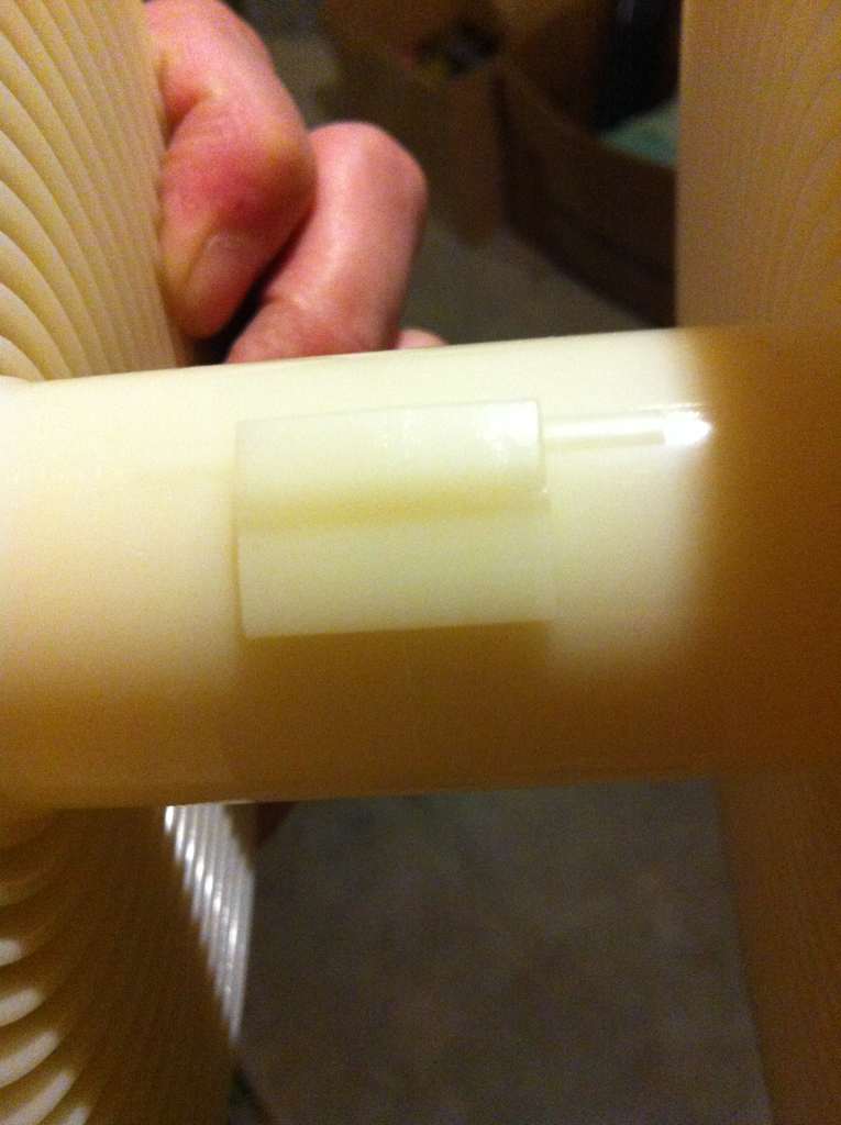

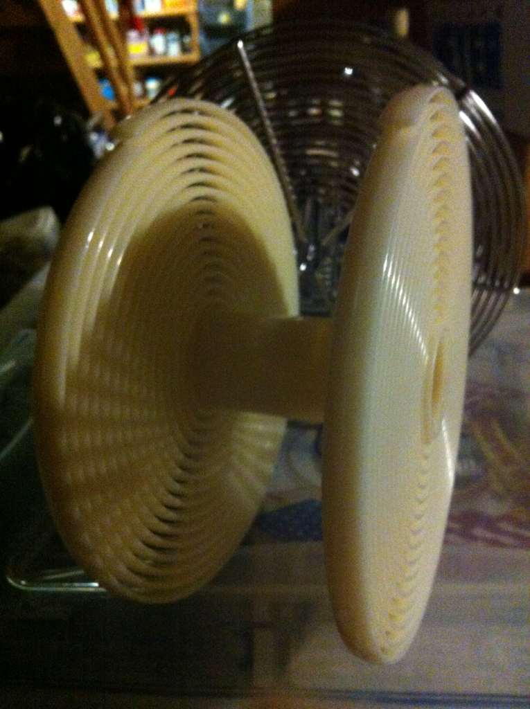

I thought I had mentioned that 116 spools would fit 70mm?
Well glad you found a video that's neat :smile:
~Stone
The Noteworthy Ones - Mamiya: 7 II, RZ67 Pro II / Canon: 1V, AE-1 / Kodak: No 1 Pocket Autographic, No 1A Pocket Autographic

I actually tried this without the second side at the bottom and it failed so I gave up on that haha I was so close!
Anyway I actually found a 116 reel that is self loading, I had already bought one 116 tank that sucked and would load from center but it was plastic so it was a pain staying in the track. Then found a self loading one.
I'm keeping the other one though bedside it's adjustable and I can do 110 in it I think.. At least I can do advantix for sure.. Though I'm sure it will be a PITA lol
