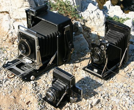

Some of the pre WWII 9x12 folding plate cameras could take inter-changeable lenses, you can use them with a 6x9 120 Rollex or Rada back, the Rda takes a 6x6 mask as well, so do some Rollex. A Patent Etrui 9x12 is a very small LF camera.
Here's one omine alongside a Crown Graphic an Ikonta 520.
Rodenstock and Zeiss made Wide angle and Telephoto slip on adapter filers. I have one I think 1.5x that turns my 203mm f7.7 Etar into a 304.5mm (it might be 1.7x I know it was too long on my Super Graphic). Zeiss sold them as Proxars for wide angle - there was a 1 & 2, and Distars for telephoto 1.5 and 3 they were designed to fit the 150mm f4.5 and 6.3 Tessars.
So if you found these converter and a 6.5x9 plate camera you might be OK jus use a roll film back :D
