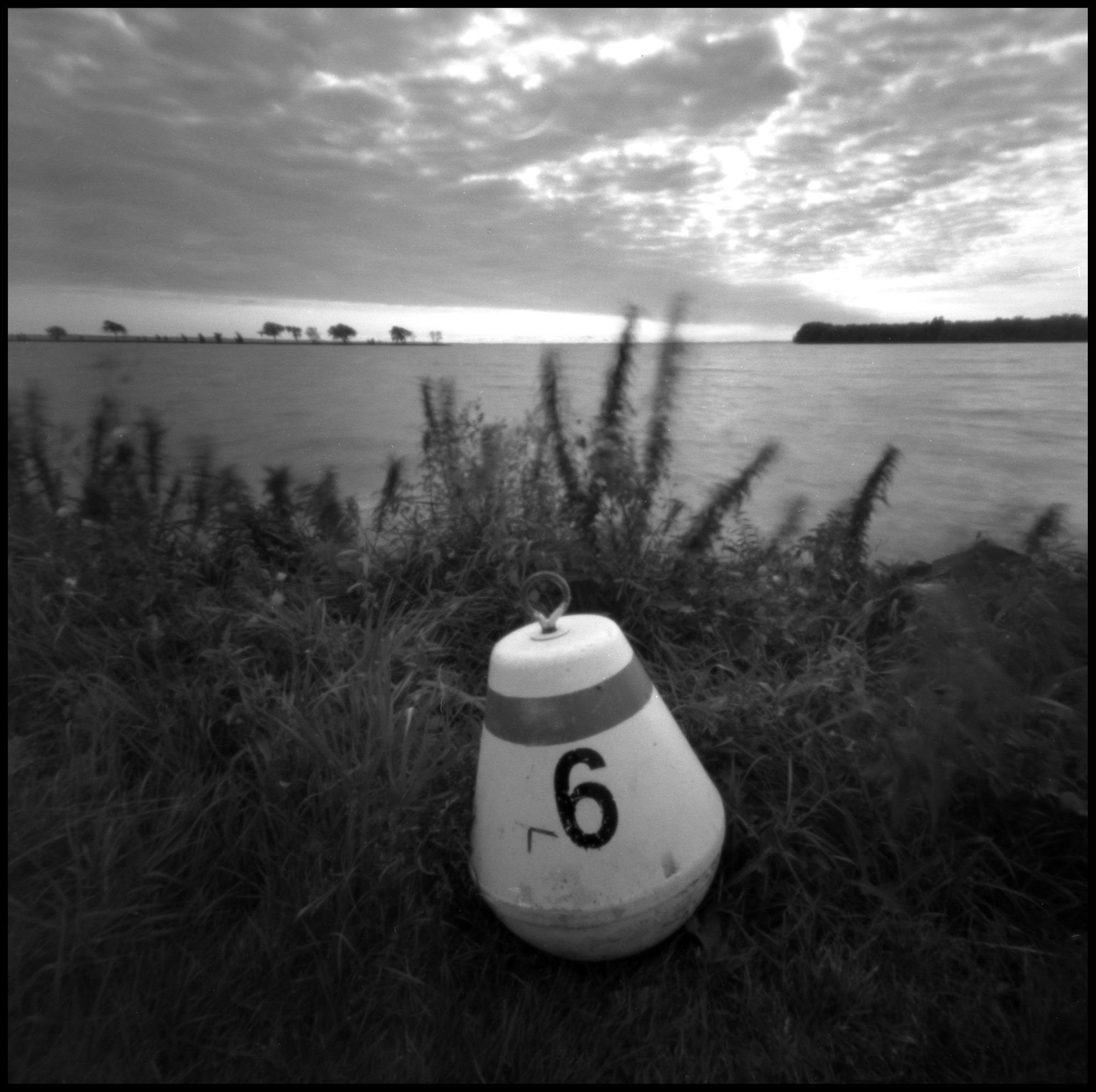

It depends on what you mean by motion. This photograph is at F130 at ISO 400 for probably a second. You can see waves in the bay. It would be easy to get a digital camera to do this with an intervalometer. It's possible to get a very expensive rig to do this advancing film every frame with a large-capacity magazine. Movie cameras are available to do it. By the way, making video with a pinhole is a common practice today.
